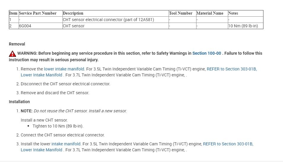

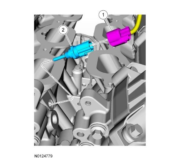

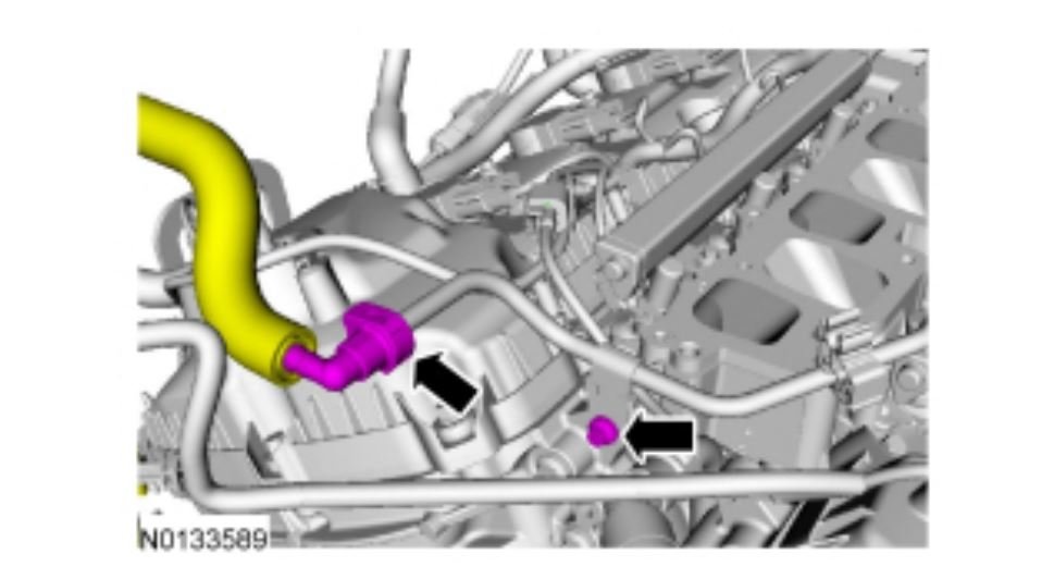

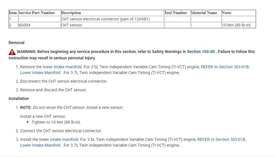

The sensor is under the lower intake manifold. the manifold must be removed to access the sensor.
Why are you replacing the sensor? what is the issue?
Lower Intake Manifold
Removal
NOTICE: During engine repair procedures, cleanliness is extremely important. Any foreign material, including any material created while cleaning gasket surfaces that enters the oil passages, coolant passages or the oil pan, can cause engine failure.
With the vehicle in NEUTRAL, position it on a hoist. REFER to Section 100-02, Jacking and Lifting , Lifting Points.
Release the fuel system pressure. REFER to Section 310-00, Fuel System Pressure Release .
Disconnect the battery ground cable. REFER to Section 414-01, Battery Disconnect .
Drain the cooling system. REFER to Section 303-03, Cooling System Draining, Filling and Bleeding .
Remove the upper intake manifold. Refer to Upper Intake Manifold .

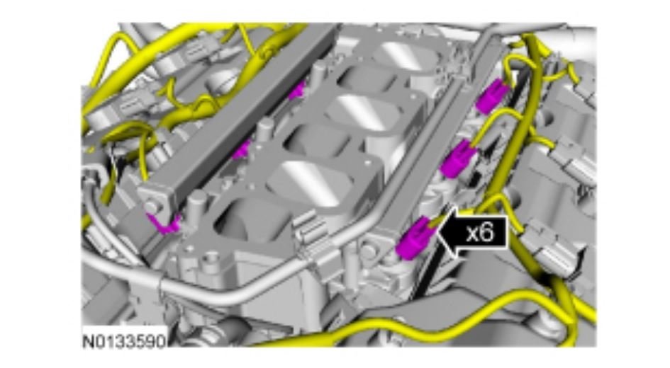

Disconnect the 6 fuel injector electrical connectors.

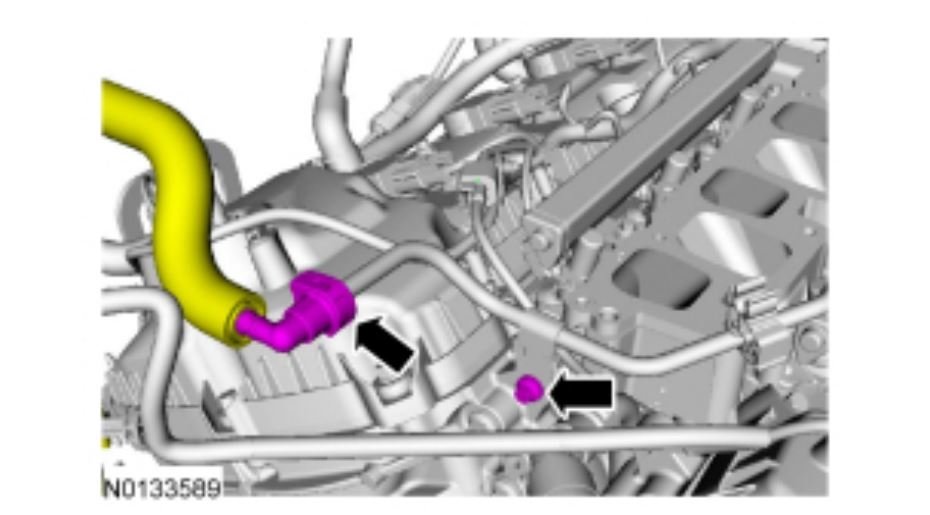

Disconnect the fuel supply tube-to-fuel rail quick connect coupling. REFER to Section 310-00, Quick Connect Coupling . Position fuel supply tube aside.
Remove the bolt from the fuel supply tube-to-rail bracket.

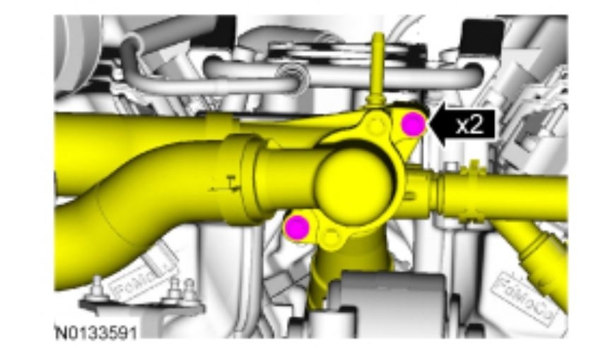

Remove the 2 thermostat housing-to-lower intake manifold bolts.

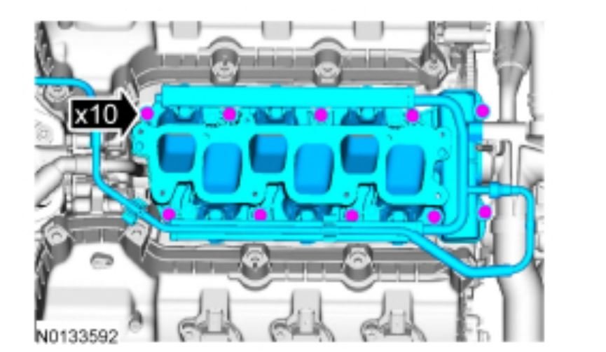

Remove the 10 bolts and the lower intake manifold.
Remove and discard the intake manifold and thermostat housing gaskets.
Clean and inspect all sealing surfaces.

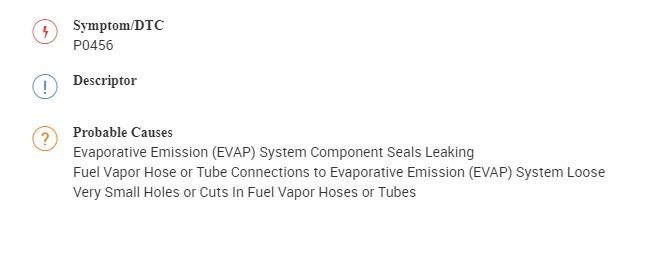

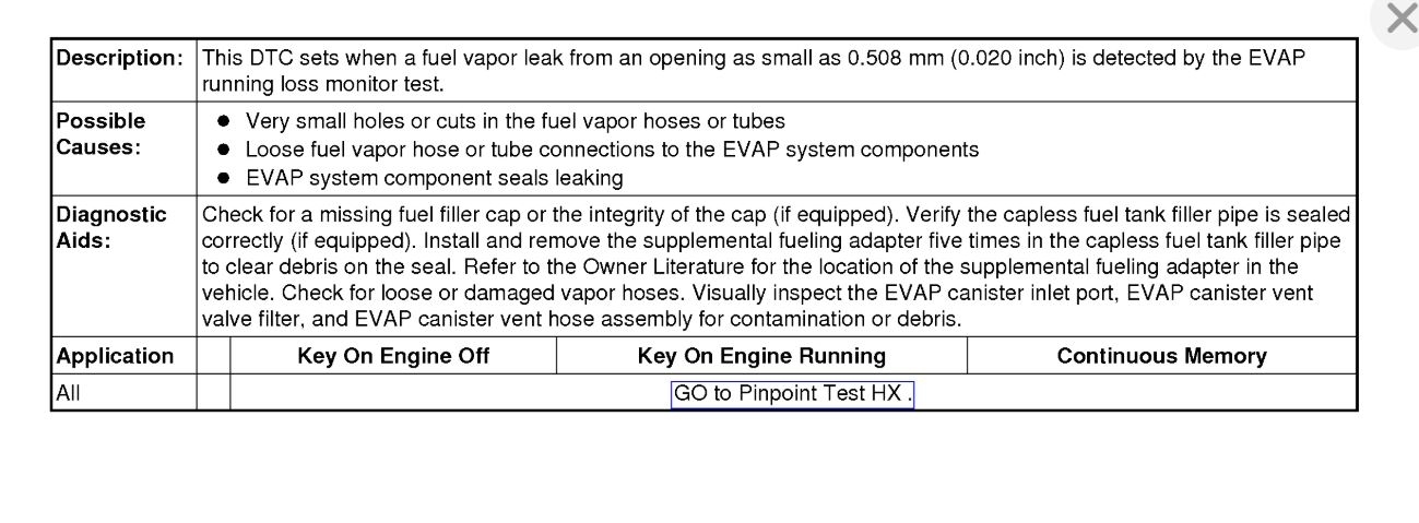

The code is P0456.
Apr 3, 2020 at 2:45 AM
Okay, whoever told her the sensor was bad missed the boat and could have spent a lot of money for nothing.
The code is for an EVAP leak in the emission system. You would need a smoke test to find the leak and have it repaired.
https://www.2carpros.com/articles/how-emission-control-systems-work
https://www.2carpros.com/articles/evap-system-code-repair
https://www.2carpros.com/articles/smog-test-inspection-information
It has absolutely nothing to do with the coolant sensor.

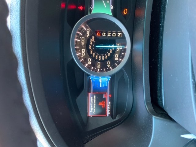

Okay, more info. The code was for the EVAP gizmo which I replaced for her. She told me there was an image that lit up on the dashboard with a message about the coolant temperature. She doesn't remember the exact wording of that message though. She'll be going to AutoZone later to have that code removed, but that still leaves the coolant sensor problem unresolved, if that is what it is. I'm not a mechanic but in my 76 years I can't recall too many temperature sensors going bad, but what do I know.

That is a warning the engine is overheating. It is not saying the temperature sender is bad.
https://www.2carpros.com/articles/symptoms-of-an-overheating-engine
You need to check the coolant to be sure it is up to level.
https://www.2carpros.com/articles/engine-overheating-or-running-hot
