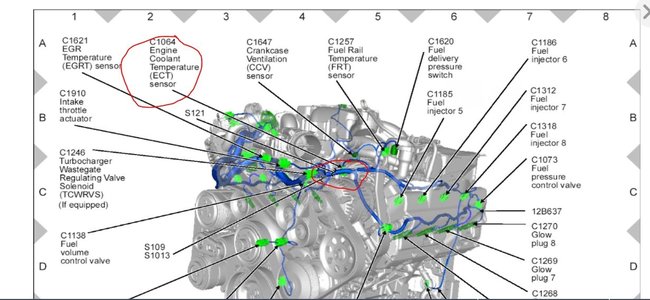

Code P0128, location of the coolant sensor needed
2012 FORD F-350
84,000 MILES • V8 • 4WD • AUTOMATIC
CHRIS RAMSAY

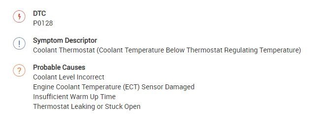

I got a code P0128, I replaced the thermostat and the problem exist. So i need to replace the Sensor. part number 9LB26G004E. Also, I can clear the check engine light but I can't clear the code. The code scanner tool said the code is permanent. I hope once I replace the sensor the code will go away.
I was told that it is under the intake manifold. Do I need to take the manifold off in order to reach it in order replace it.
Mar 12, 2021 at 4:44 PM

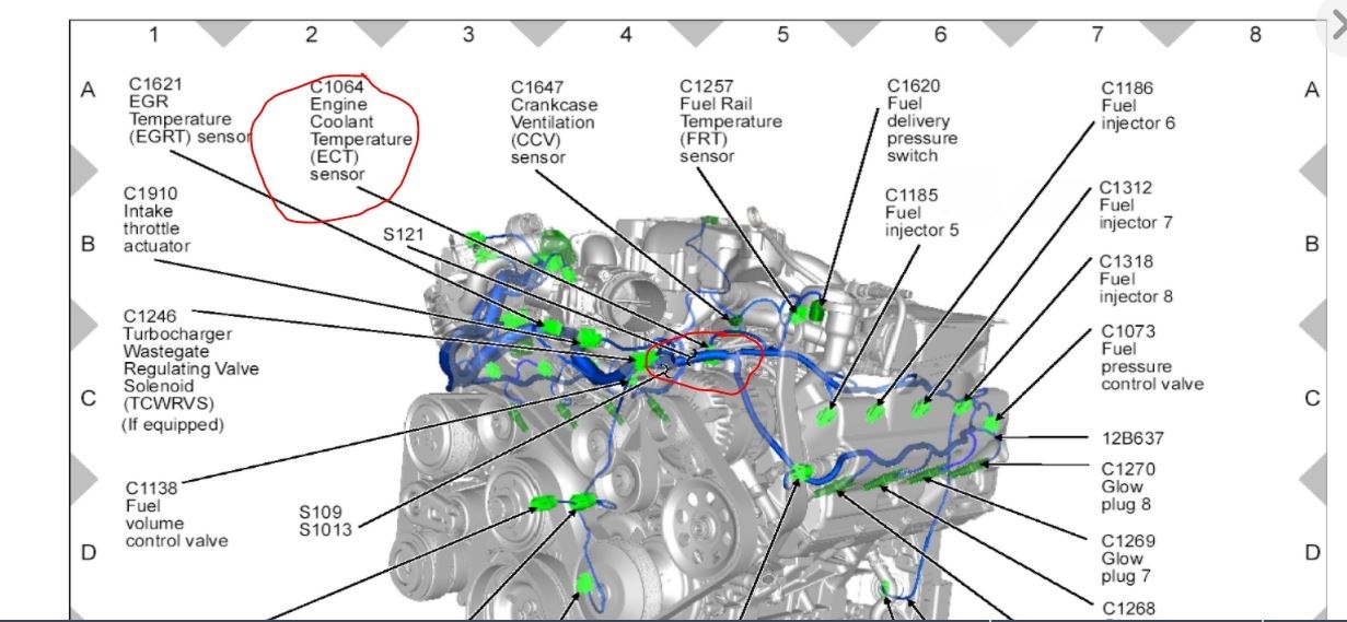

Good morning,
I attached the location of the sensor for you below.
https://www.2carpros.com/articles/coolant-temperature-sensor-cts-replacement
What temperature thermostat did you install? You need a 195. If you did not use it, that will explain the code.
