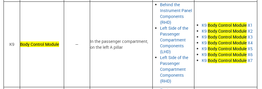

Been having some electrical issues with my car and would like to test the control modules to see if they need replacing or not.
May 16, 2023 at 10:50 AM
  • 110,244 POSTS

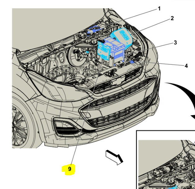

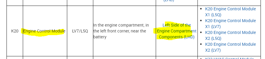

One is in the vehicle and the other is under the hood. The body control module is located behind the left kick panel (A-pillar). See pics 1 and 2. The engine control module is under the hood near the battery. See pics 3 and 4.
Let me know if this helps or if you have questions.

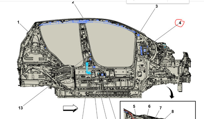

I have no idea what I'm looking at in picture 2, is that the side of the car?
May 17, 2023 at 1:50 AM
  • 110,244 POSTS
No problem. That is the driver's side of the interior of the vehicle. I agree the pic isn't too clear. That's what we get in the manuals.
Let me know if you find it or if I can help.
