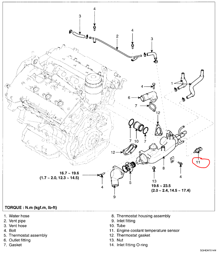

Where is the coolant temperature sensor located?
2007 KIA AMANTI
99,000 MILES • 3.8L • V6 • 2WD • AUTOMATIC
ALEXEI NIKOLAYEVICH
  • 15 POSTS
overheat temperature of engine.
Aug 28, 2021 at 7:12 PM
SQM
  • 6,383 POSTS

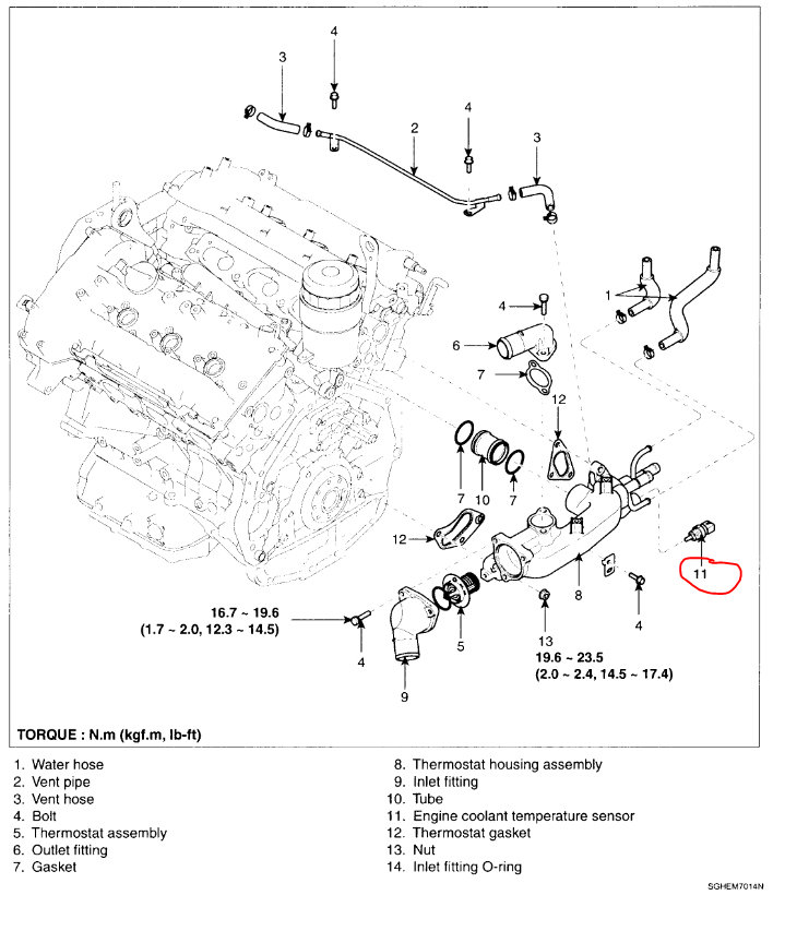

The coolant temperature sensor if located on the back of the thermostat housing on the right hand side of the engine (as you are facing the engine). See diagram below.
