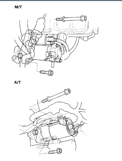

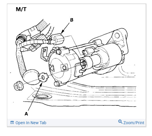

Where is the starter located?
2006 HONDA CIVIC
144,000 MILES
LORIFREER
The car won’t start on first try. Takes multiple times. No crank no start.
Aug 17, 2023 at 3:29 AM
  • 110,244 POSTS

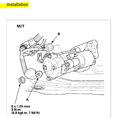

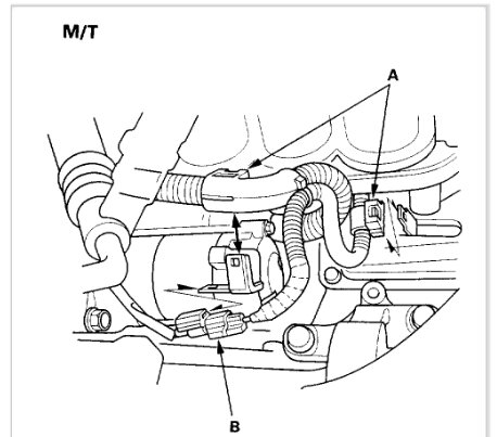

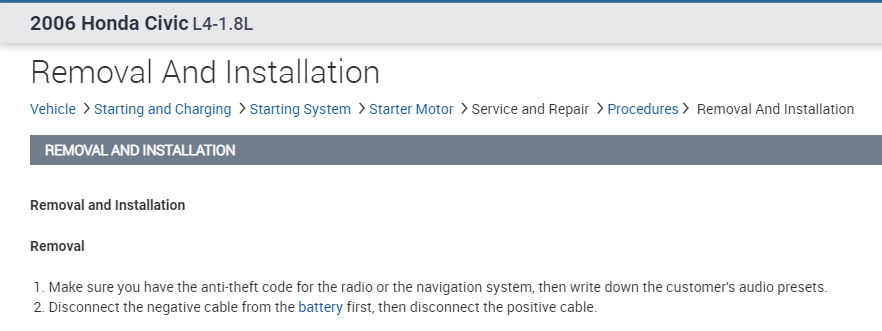

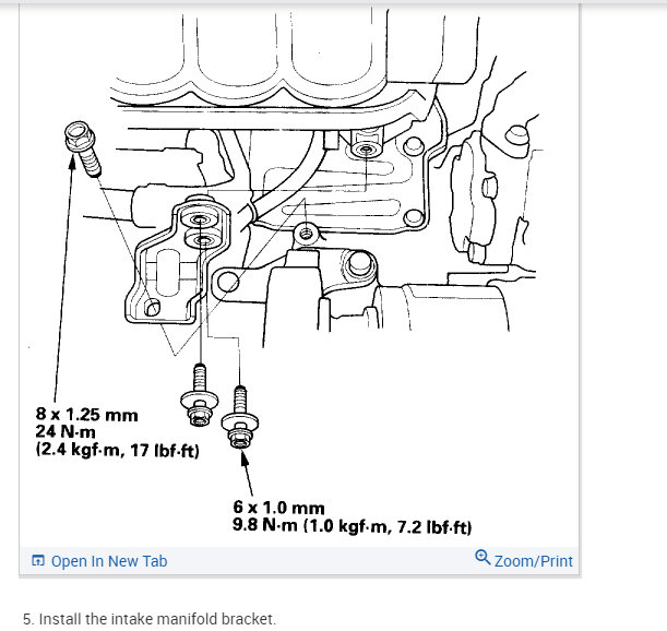

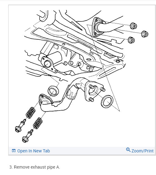

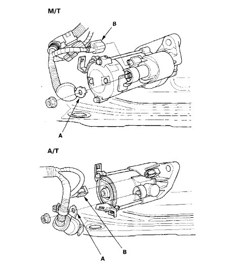

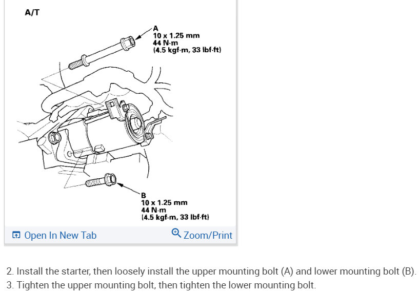

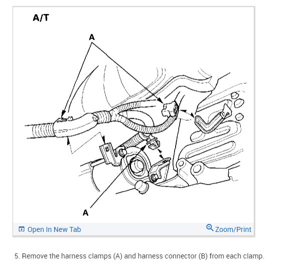

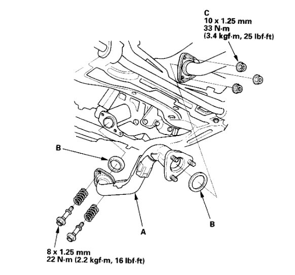

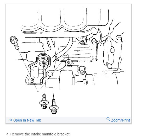

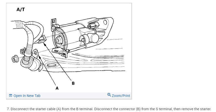

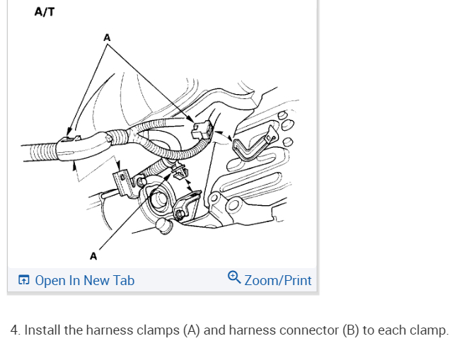

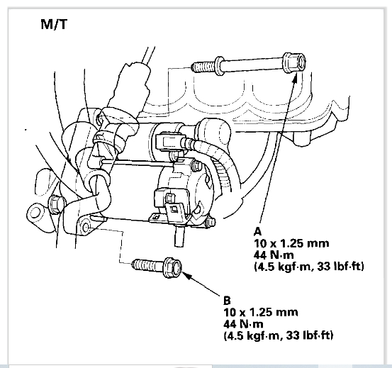

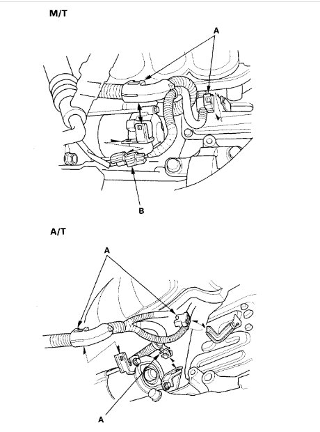

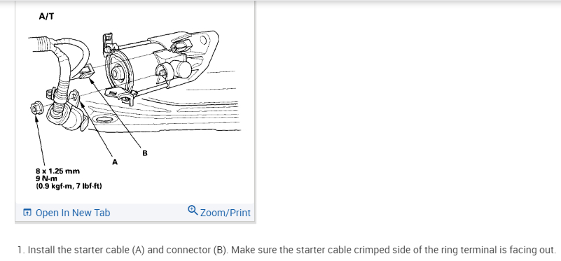

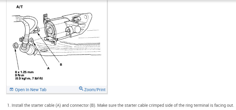

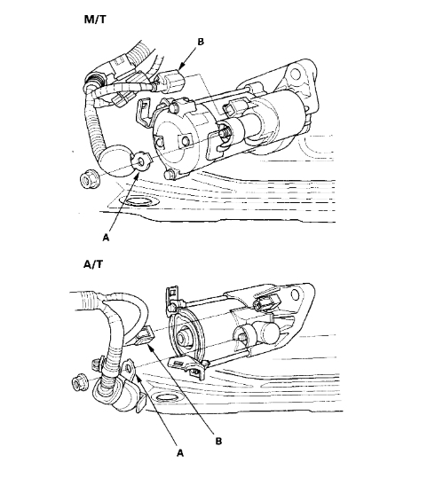

To access the starter motor, a portion of the exhaust system needs to be removed. It's tucked away under the intake manifold.
I'm not sure if you have an automatic or manual transmission or a 1.3L or 1.8L engine, so I went with the 1.8L. The directions include both automatic and manual transmission information and directions.
If you look below, I attached the directions for replacing the starter motor. Take a look through them and let me know if it helps.
