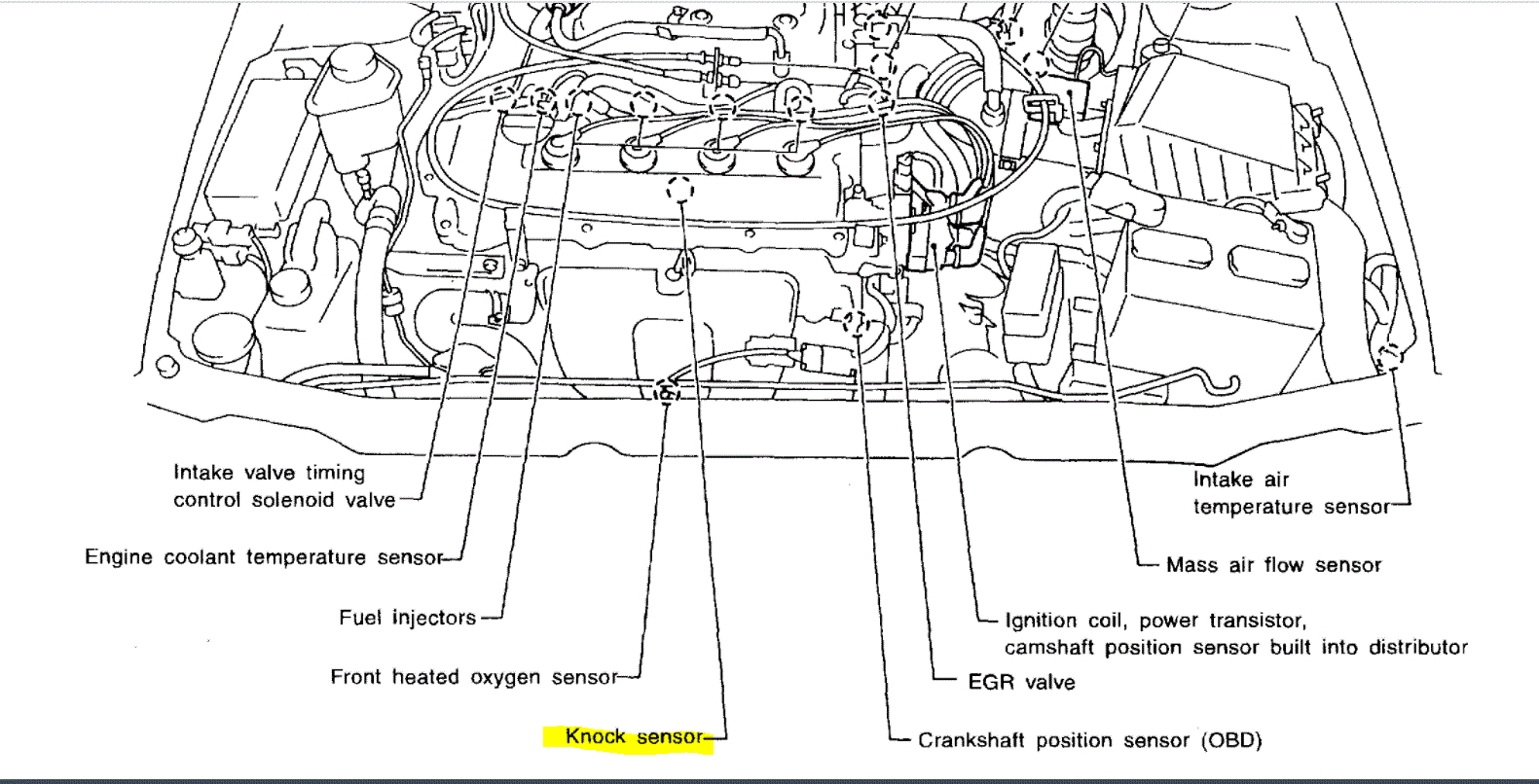

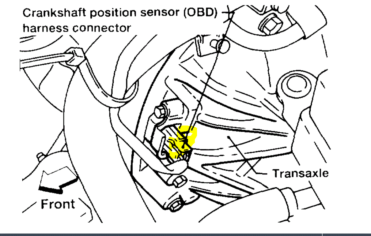

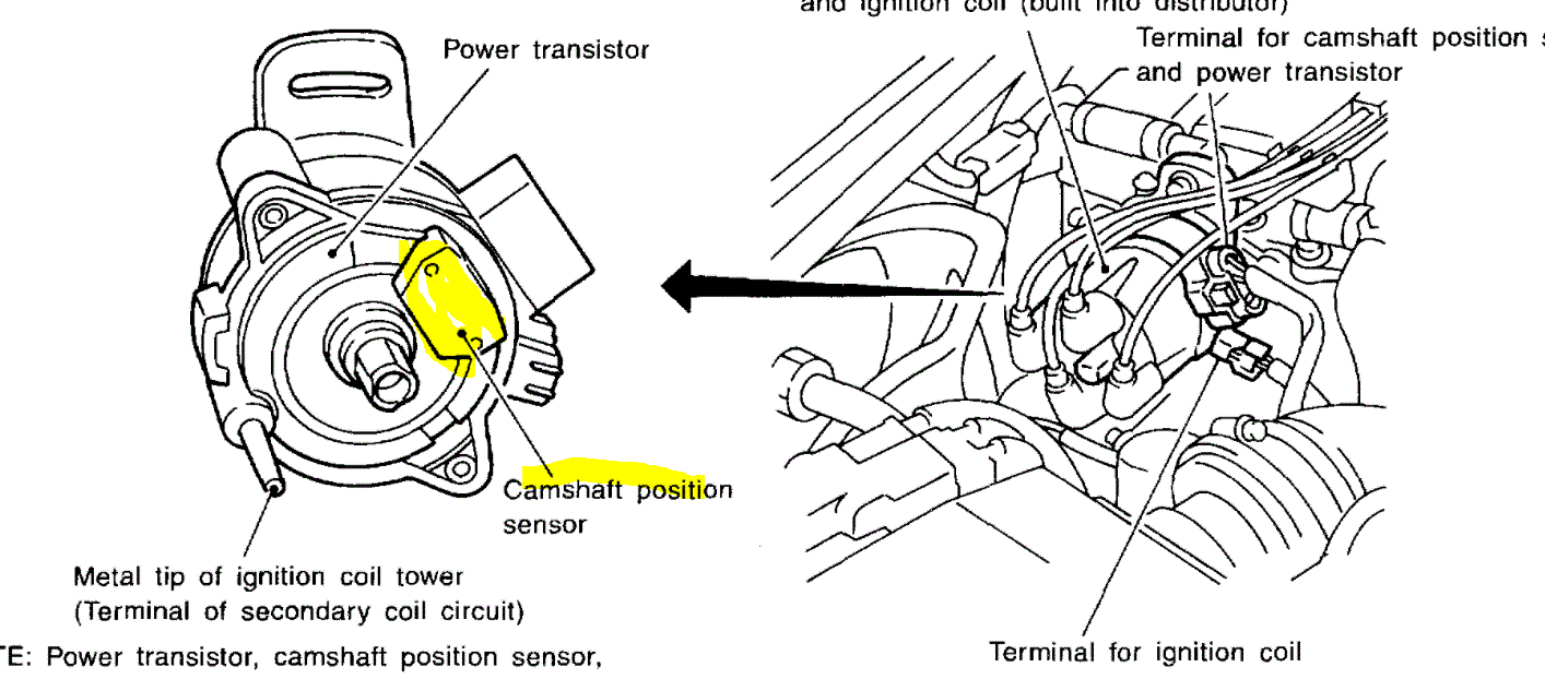

Need location of crankshaft, knock and cam position sensor. And process in order to remove and replace them.
Mar 10, 2021 at 5:01 AM
  • 110,240 POSTS
The crankshaft position sensor is located in the transmission bell housing. See pic 1 for location. The camshaft position sensor is in the distributor itself. You will need to remove the distributor cap to locate it. See pic 2 for location. Pic 3 shows the location of the knock sensor.
