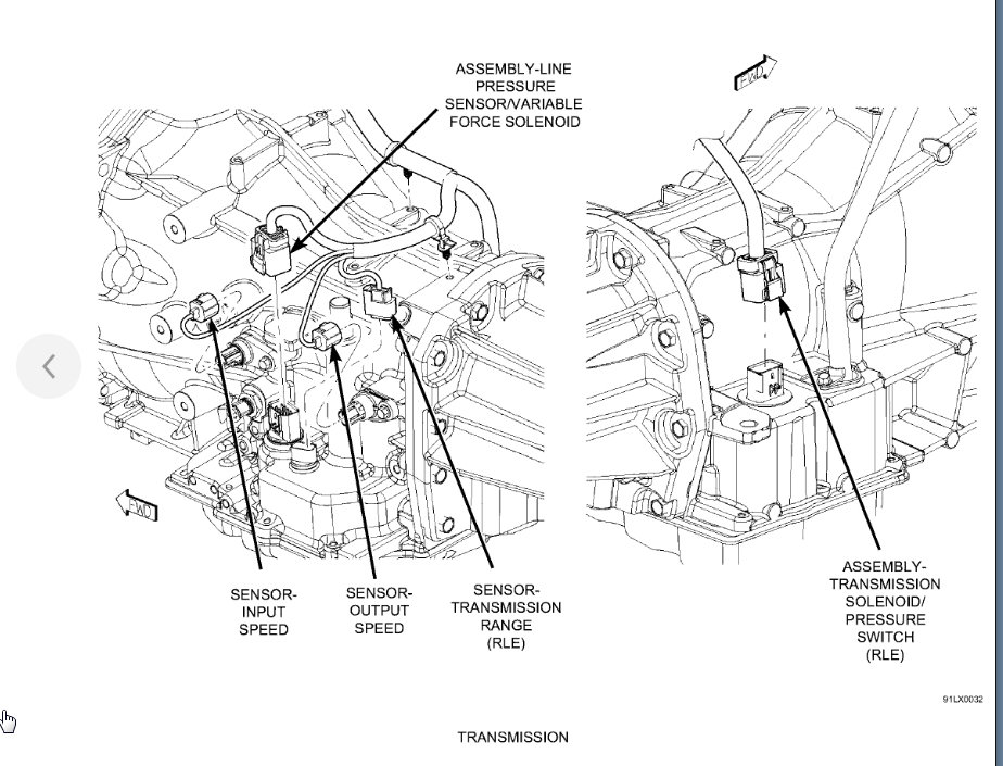

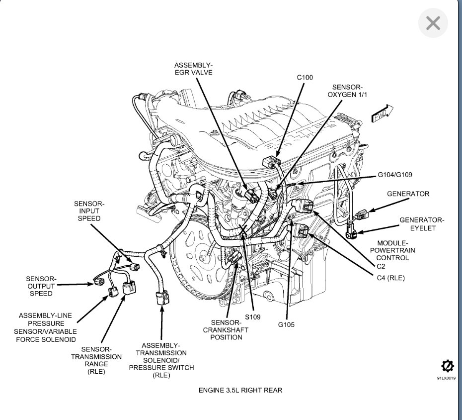

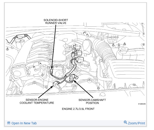

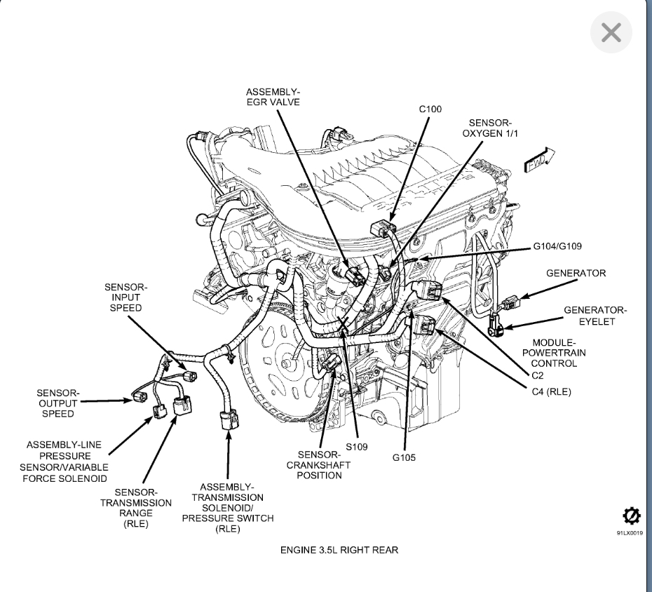

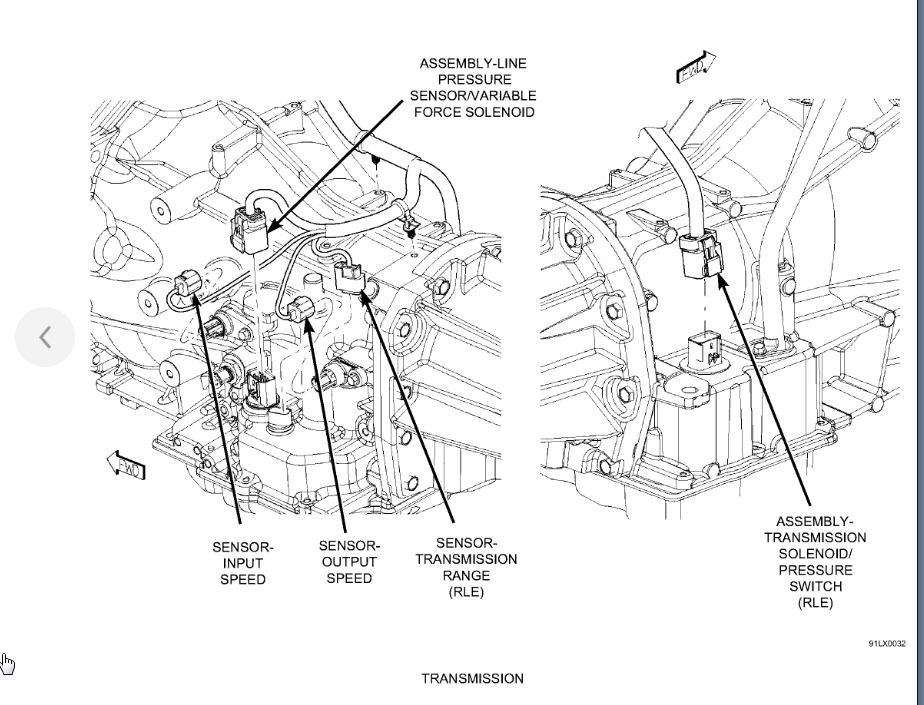

I need a diagram of my engine and where my sensors are all located. Vehicle speed sensor first.
Oct 26, 2019 at 6:55 PM
I can get you any that you need but if you want to get me more detail on which ones, I will send them over.
Also, you said your engine is 0.5L. I assume you mean 3.5L?
As for the speed sensors, I assume you mean the input and output not the wheel speed sensors? Take a look at these and tell me what else you are looking for. Thanks

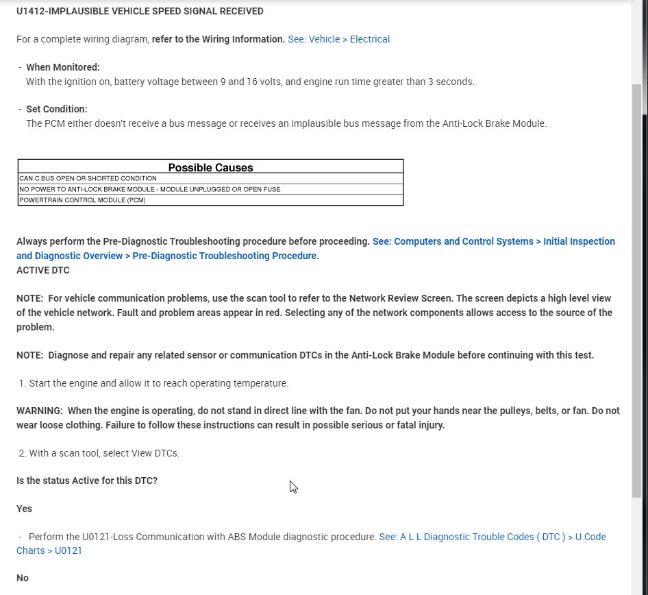

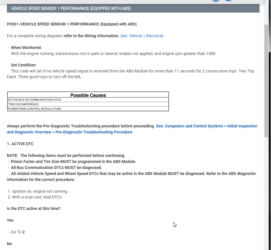

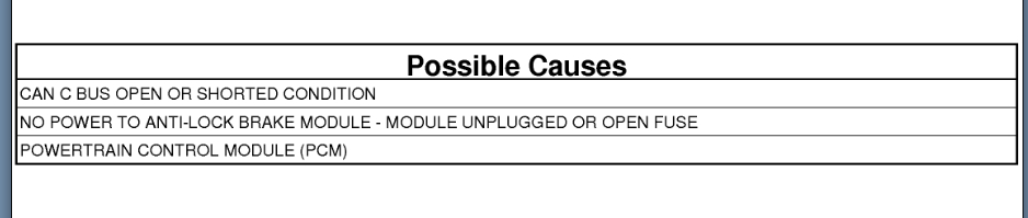

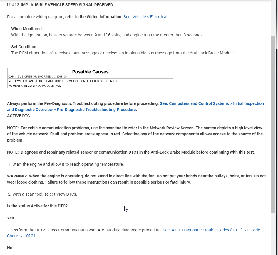

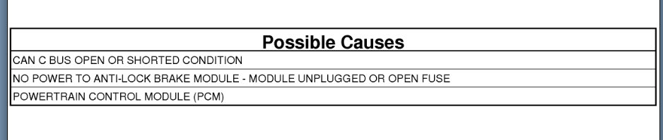

I'm sorry, it is a Chrysler 300c hemi srt8 5.7 2009. code u1412 comes up to and p0501 on and off. I changed my rear speed sensor's not the front yet. but there is one or more I can't find. thank you.
Oct 28, 2019 at 10:58 AM

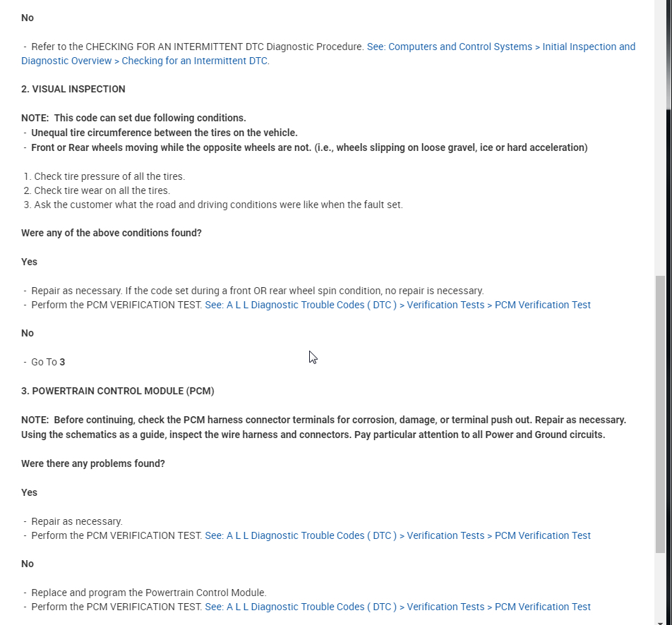

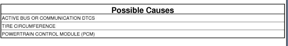

Okay. That makes more sense. Check out these attachments. Your issue is not an actual speed sensor. More than likely you have an electrical issue or a PCM issue.
Did you just recently put larger tires on this or change one of the tires? If the tire circumference is off, it can cause this as well.
