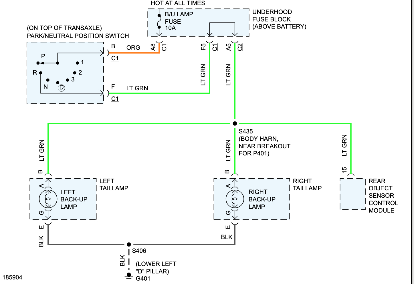

Reverse lights don't work. where is reverse switch location?
Mar 20, 2019 at 12:36 AM
JOETECHPRO
  • 705 POSTS
Hey CRASHMAN55,
Have you checked the fuse for the reverse lights?
And also checked the bulbs.
These would be the first and easiest things to do.
I have attached the wiring diagram the fuse is in the under hood fuse box.

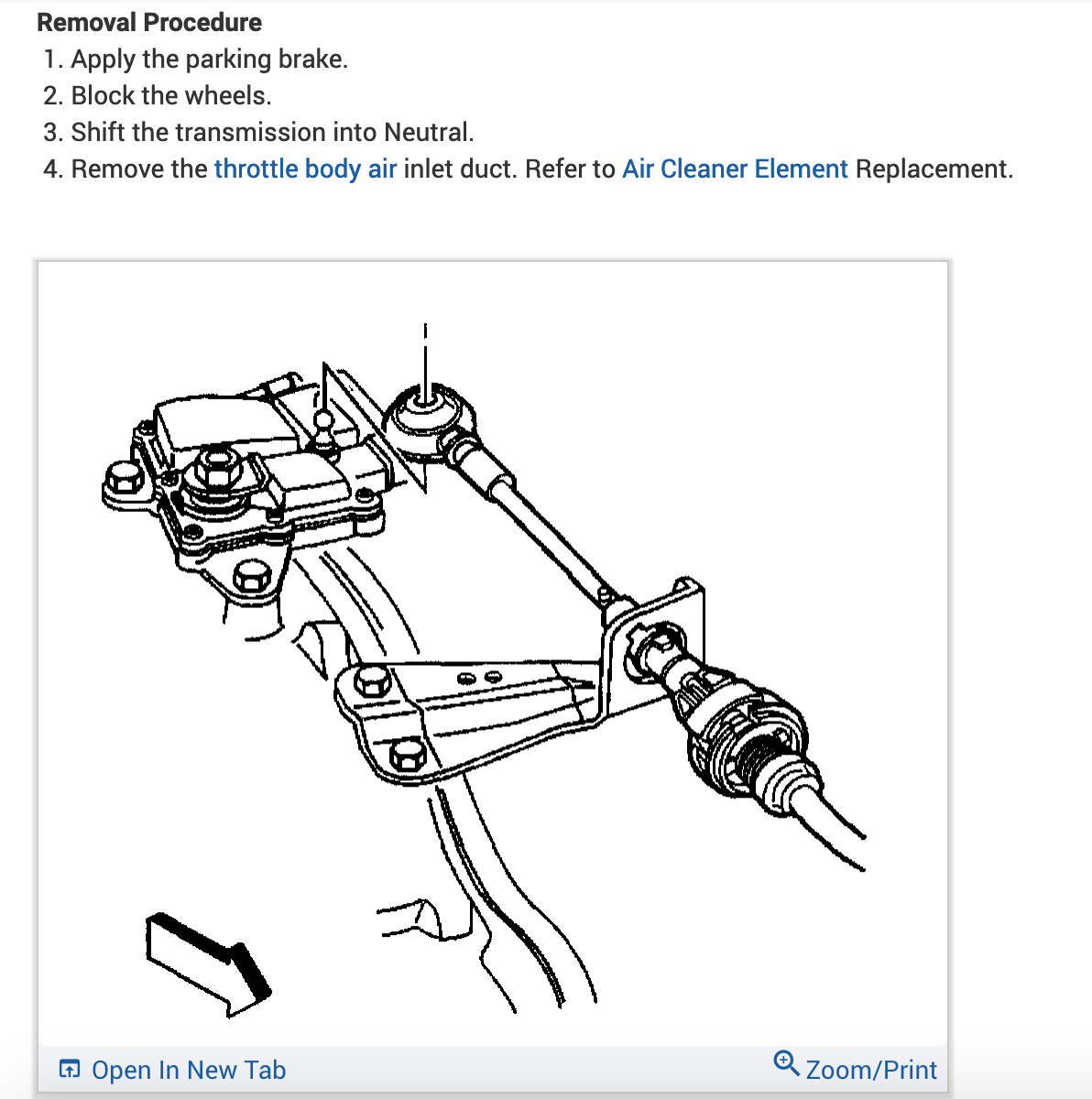

The second picture shows the PNP switch which contains the reverse light switch.
It is located underneath your air inlet/air filter box on top of the transmission.

CRASHMAN55
Thanks so much joe you saved me money you picture shows what was missing . there's a plug there also .got to be for the switch that's not there . Thanks so much again. R.Skeens
