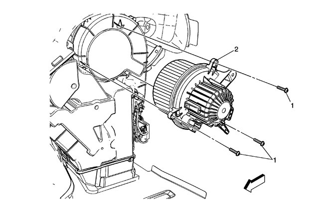

Where can I locate the rear blower motor
Aug 25, 2019 at 10:03 PM
  • 110,240 POSTS
Welcome to 2CarPros.
It is in the rear of the vehicle luggage compartment (passenger side). You will need to remove trim to access it. See picture 1. in the images below.

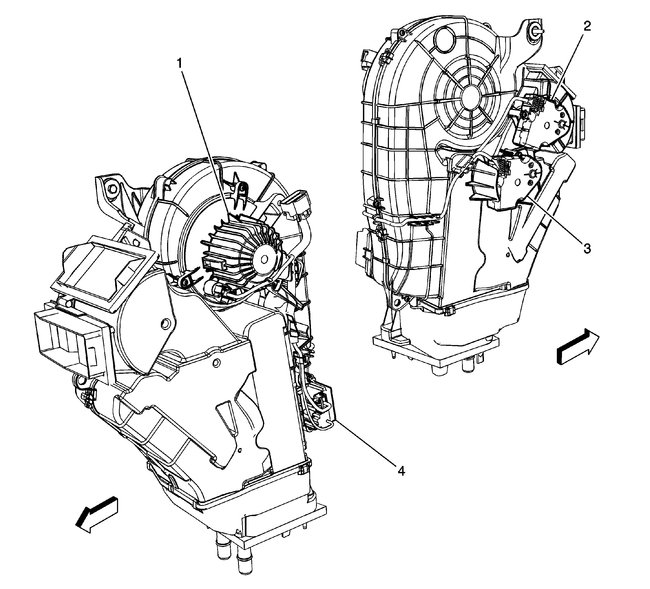

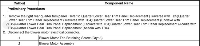

If you look at picture 2, it indicated the directions for replacing the motor. Picture 3 correlates with the directions.
