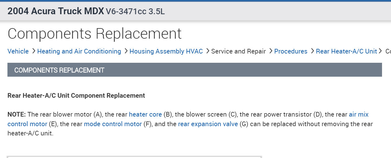

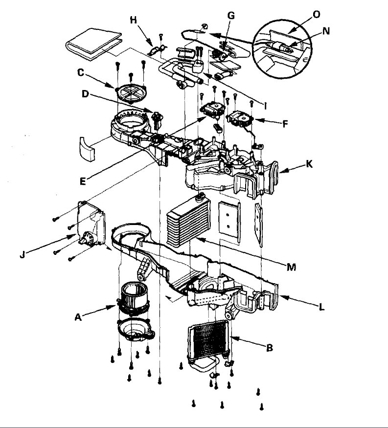

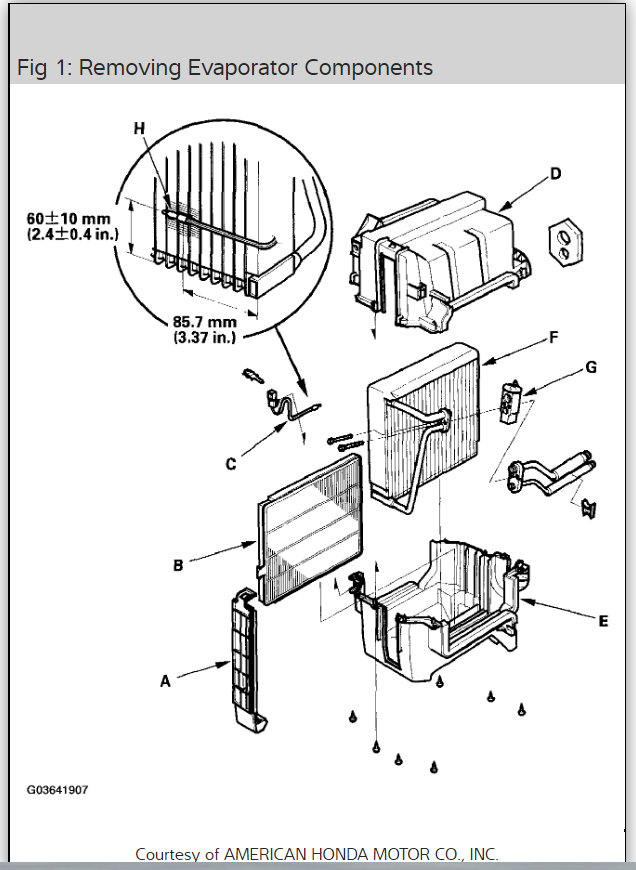

Where is the rear A/C expansion valve located under the gear shift/middle console at?
Mar 22, 2019 at 11:52 AM
SCGRANTURISMO
  • 4,897 POSTS

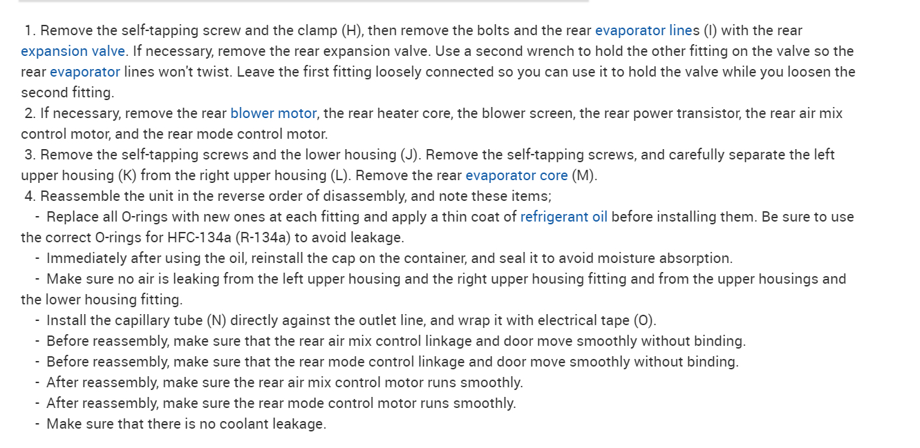

I have included the information that you requested in the diagrams down below. I have also included the step by step directions for the removal and installation of the rear A/C expansion valve. Please get back to us with what you find out please.

Thank you we found it now. we didn't know if it was more up front or in the back of the middle console. This was very helpful.
