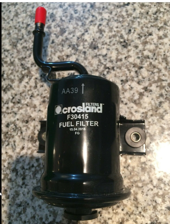

I want to know the location of the petrol fuel filter (OEM 2330022020/2330022030) on my vehicle listed above Stationwagon (_T25_) | 2003.04-2008.11 - 1.8 (ZZT251_) - 1794ccm.

Unfortunately, we don't have this vehicle in the USA so we don't have a manual for the vehicle showing the location of the filter.
However, after doing a little research it looks like the filter for this vehicle is mounted on the frame rail or inline from the tank. The way to find a rail mounted filter is to follow the fuel line from the tank up to the engine.
However, if you don't find one anywhere on the fuel line that looks like the picture, then your vehicle is like those in the USA where it does not have a filter that is serviceable. They have filters in the tank and only replaced when the fuel pump is removed from the tank. Hopefully this helps. Thanks
