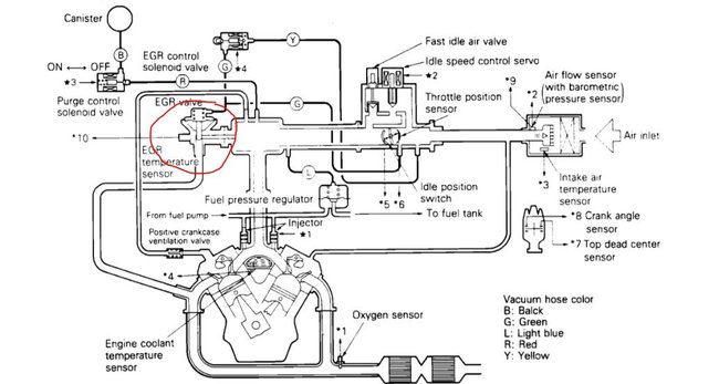

cannot find EGR valve.
Sep 24, 2020 at 6:41 PM
Good morning,

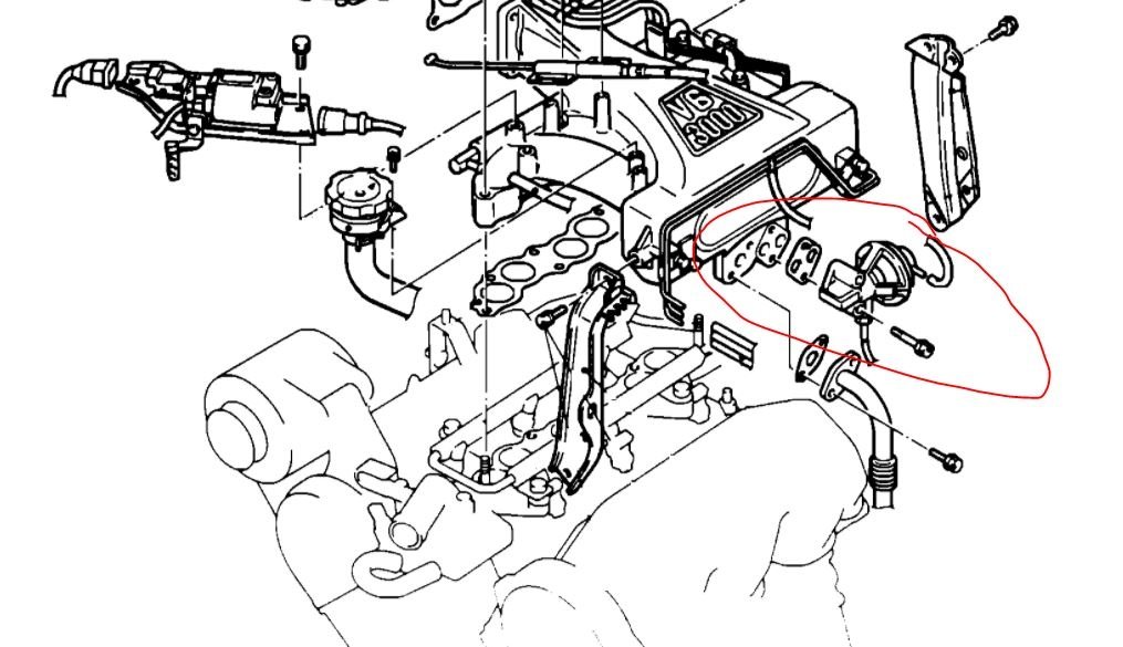

It is on the upper intake manifold at the throttle body itself? It has a vacuum line to it and is secured by 2 bolts.
https://www.2carpros.com/articles/how-emission-control-systems-work
What makes you think the valve is bad?
I attached a better picture of its location as well.
