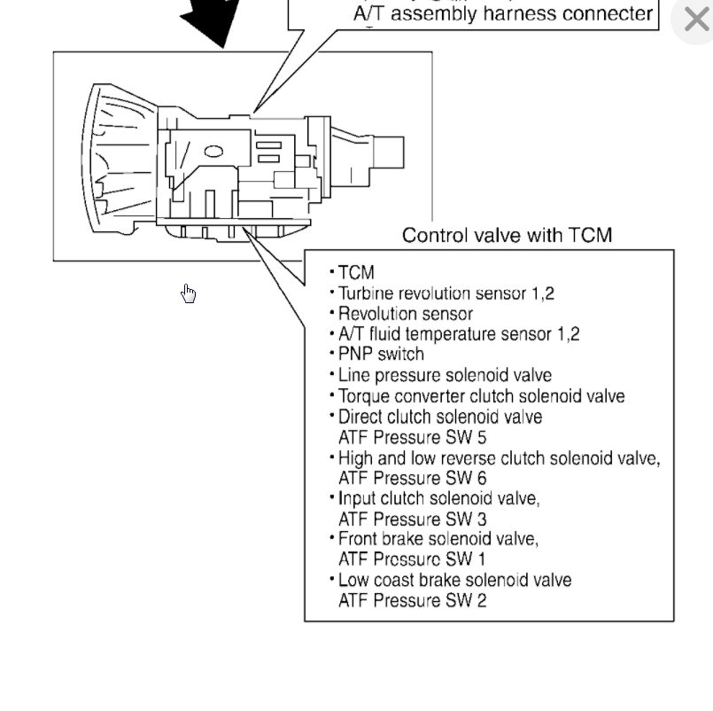

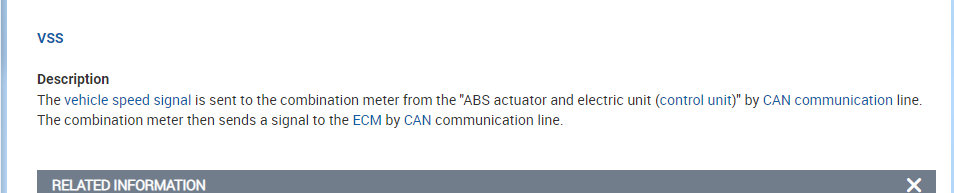

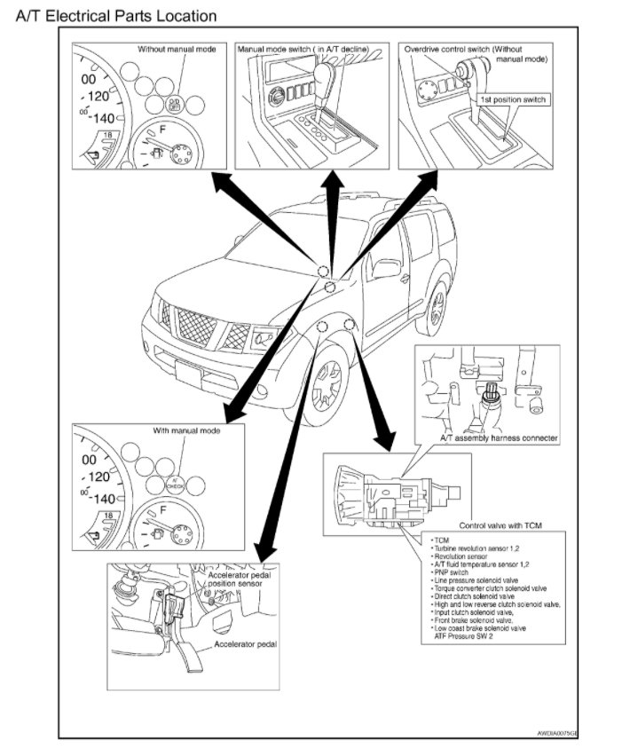

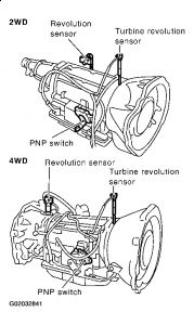

I have looked everywhere and cannot locate the VSS output transmission speed sensor.
May 22, 2019 at 1:37 PM
SCGRANTURISMO
  • 4,897 POSTS
I have included the information you requested in the diagrams down below. It looks as if the Vehicle Speed Sensor is located in the transmission with a redundant system in the combination switch. Please go through the information and get back to us with what you find out. Check out the diagrams (Below). Please let us know if you need anything else to get the problem fixed.

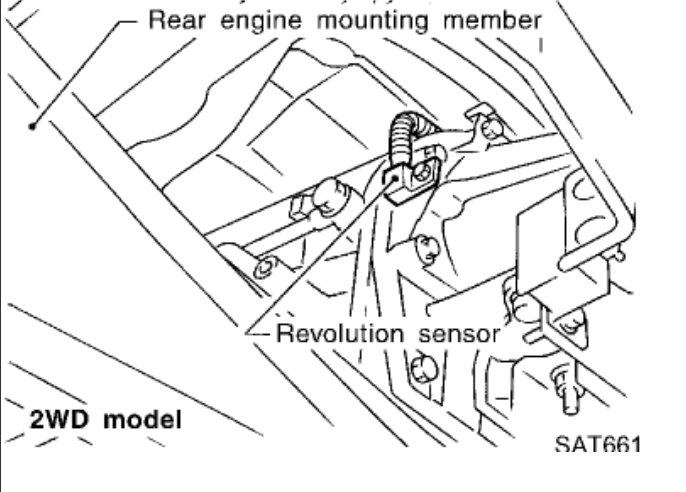

Output speed sensor location I need to change it.
Dec 15, 2020 at 2:17 AM (Merged)
I am attaching the info on the speed sensor. This is a vehicle speed sensor also called the revolution sensor. I am attaching the location for it as requested.
Let us know if there is more info needed. Thanks

I'm getting a trouble code that my vehicle speed sensor is malfunctioning. However, I can't seem to locate the speed sensor on the vehicle. I went to a Nissan dealer and they provided me with a diagram showing the speed sensor is located on the transfer case of the transmission (drivers side). However, I have looked all over and can't seem to find the sensor on the vehicle. Where is this sensor located? The model is SE and the engine size is 3.5L.

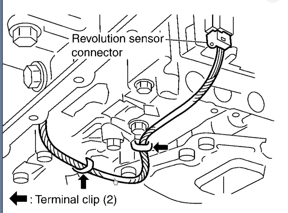

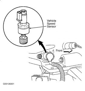

Hello - VEHICLE SPEED SENSOR Removal & Installation 1. Remove bolt and Vehicle Speed Sensor (VSS). See Fig. 14 . Fig. 14: Locating Vehicle Speed Sensor Courtesy of NISSAN MOTOR CO., U.S.A.
https://images.2carpros.com/forum/automotive_pictures/248015_14_5.jpg
2. To install, reverse removal procedure. Install NEW "O" ring on VSS. Tighten bolt to specification. See TORQUE SPECIFICATIONS . The information is really slim
https://images.2carpros.com/forum/automotive_pictures/248015_208_1.jpg
I have attached one pic above and it looks like they also call it a Revolution sensor. Yellow and orange and possible a black wire. Check out the diagrams (Below) Please let us know what happens. Cheers
