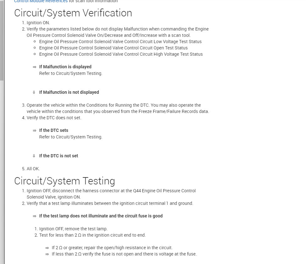

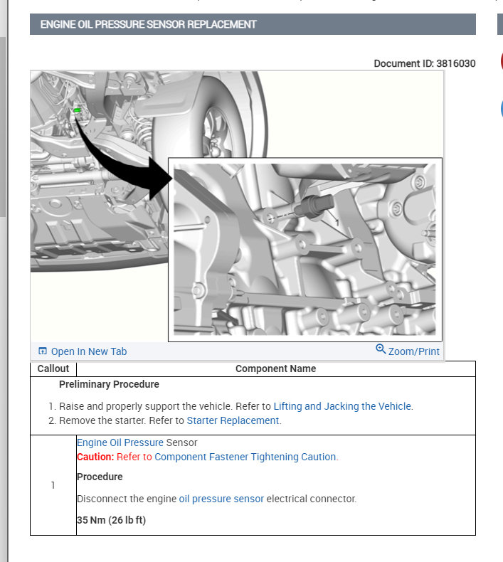

My truck listed above has a P06DC and would like to know the location of the Oil Pressure sensor on this specific vehicle (as I cannot seem to find the location anywhere on the internet).
if you have a diagram where I should be looking, that would be awesome!
Thanks!
Apr 21, 2020 at 10:47 PM

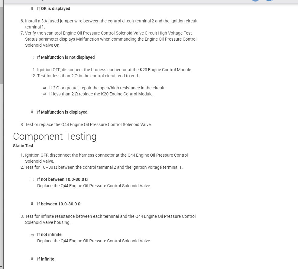

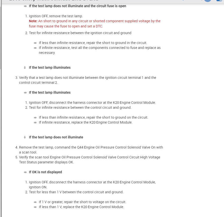

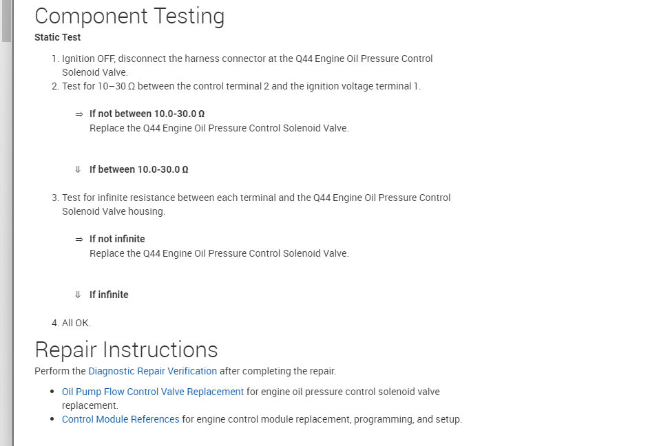

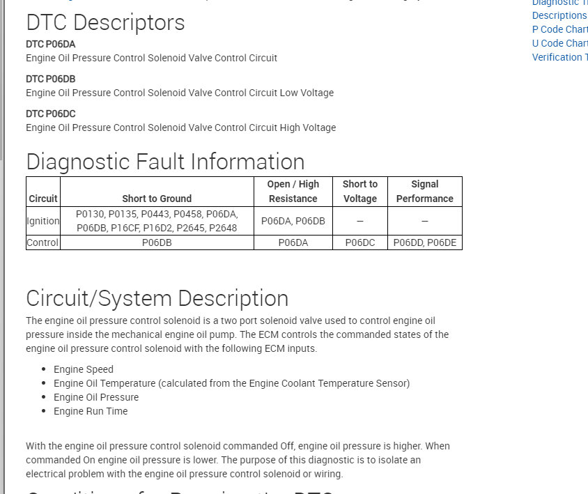

This code is not for the oil pressure sensor. This is a control valve that manages the oil pressure, so I attached the location of the sensor per your request, which is just behind the passenger side tire as shown below but I also attached the testing for this code.
We need to run through this testing using these guides to determine if we have a wiring or control module issue as well.
Please run through this testing and let us know what you find.
Thanks
