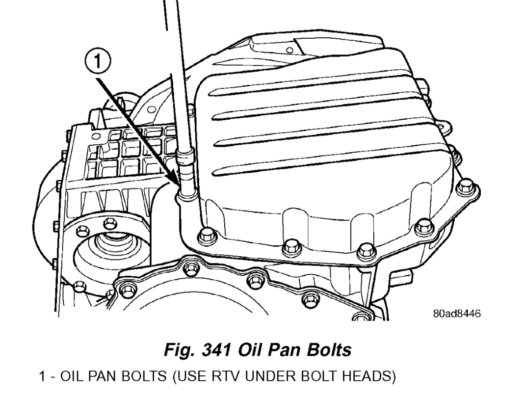

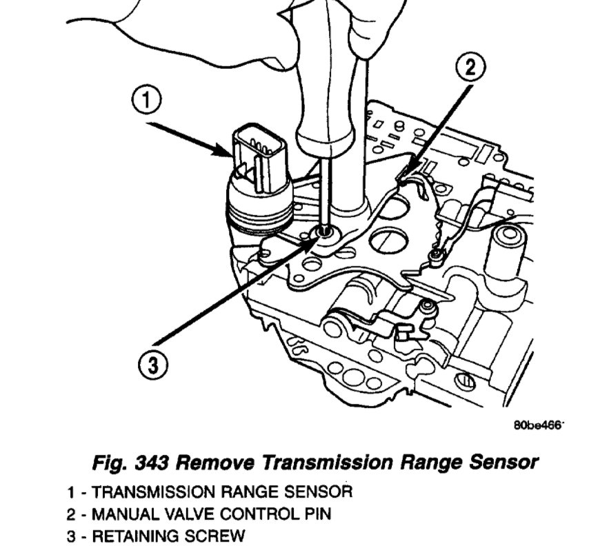

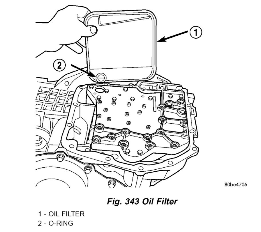

Good evening,
I attached the location and the procedure for the replacement.
The valve body needs to be removed to gain access to the switch.
REMOVAL
1. Remove valve body assembly from transaxle.
ImageOpen In New TabZoom/Print
2. Remove transmission range sensor retaining screw and remove sensor from valve body (Fig. 343).
3. Remove TRS from manual shaft.
INSTALLATION
1. Install Transmission Range Sensor (TRS) to the valve body and torque retaining screw (Fig. 343) to 5 Nm (45 inch lbs.).
2. Install valve body to transaxle.
41TE - Automatic Transmission
VALVE BODY - REMOVAL
NOTE: If valve body is replaced or reconditioned, the TCM Quick Learn Procedure must be performed.

4. Raise vehicle on hoist.
5. Remove oil pan bolts (Fig. 341).

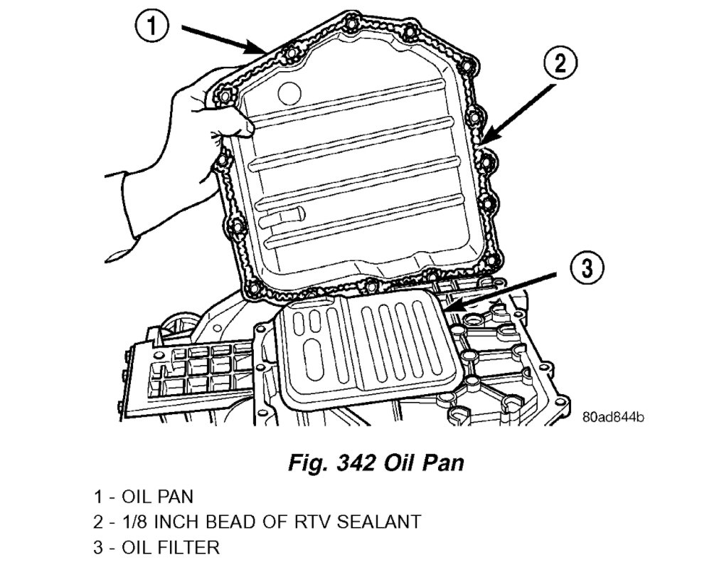

6. Remove oil pan (Fig. 342).

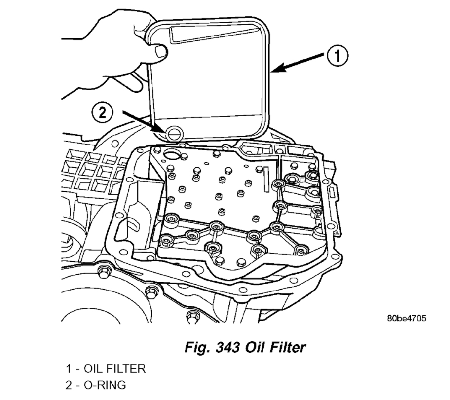

7. Remove oil filter (Fig. 343).

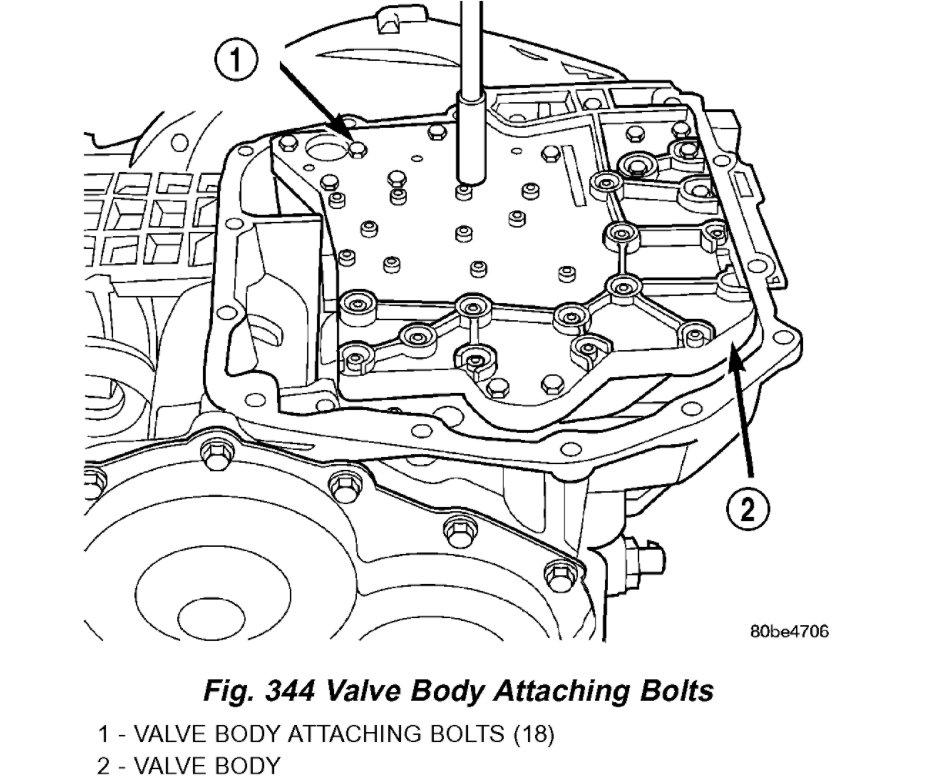

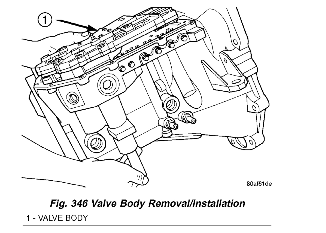

8. Remove the valve body-to-transaxle case bolts (Fig. 344).
NOTE: To ease removal of the valve body, turn the manual valve lever fully clockwise to low or first gear.

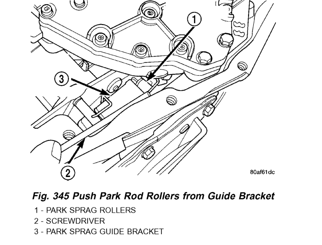

9. Remove park rod rollers from guide bracket and remove valve body from transaxle (Fig. 345) (Fig. 346).
CAUTION: The valve body manual shaft pilot may distort and bind the manual valve if the valve body is mishandled or dropped.

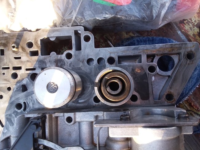

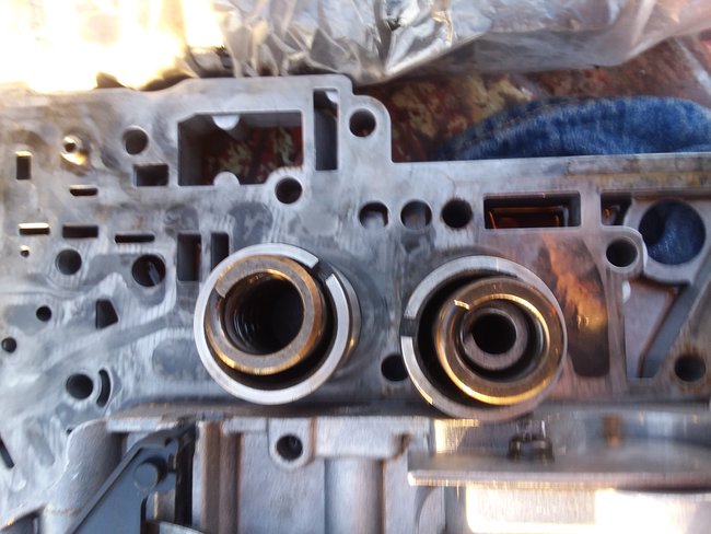

I need to know if I had these pistons and springs set right.
Thursday, November 5th, 2020 AT 3:16 PM
  • 52,797 POSTS
They look correct.

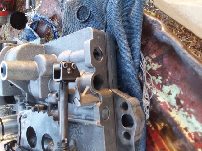

Thank you Roy and I also need to know if this is the right position for this rod.
Thursday, November 5th, 2020 AT 3:33 PM
ALLEN SILVA
  • 6 POSTS
Is this the correct position for that rod?

Only one of those pistons head double spring.
Thursday, November 5th, 2020 AT 3:38 PM
  • 52,797 POSTS
That is part of the parking pawl.
That is manual linkage.
