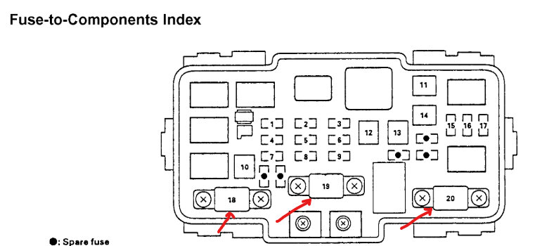

Where are the main power fuses located?
2004 HONDA CIVIC
175,000 MILES • 1.7L • 4 CYL • 2WD • MANUAL
LEWKO
Please help me locate the main power fuses. Particularly the maxi fuse.
Dec 1, 2024 at 4:44 AM
  • 55,432 POSTS
There are three maxi fuses under the hood inside the main fuse panel. here is a guide to help you test them and the location of the maxi fuses in the images below.
