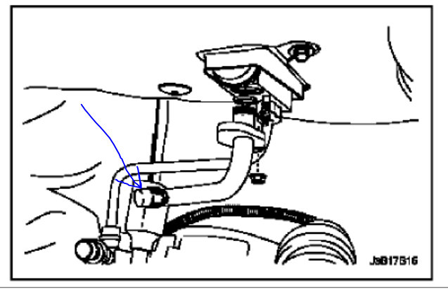

I'm trying to locate the low side service port on the air conditioning for a 2008 Suzuki Forenza. Any help is appreciated.

The low side charge port is back by the firewall where the AC lines go into the interior. Here is a guide and the location of the port (below)
