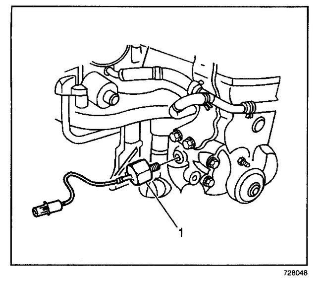

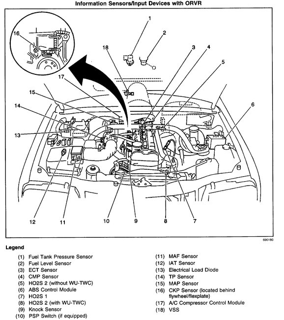

Cannot find the location of the knock sensor for my vehicle listed above. If you know where to find it please let me know.

It is on the front top of the engine. I have attached two pictures showing where it is located. In picture 2., locate number 9. In picture two, which correlates with the directions, you see a close up of the knock sensor.

1. Disconnect the knock sensor (KS) electrical connector.
2. Remove the KS (1) from the engine block.
INSTALLATION PROCEDURE
1. Install the KS (1) to the engine block.
NOTE: Refer to Fastener Notice in Service Precautions.
2. Secure the KS to the engine with the bolt.
Tighten
Tighten the bolt to 23 N.m (17 lb ft).
3. Connect the KS electrical connector.
