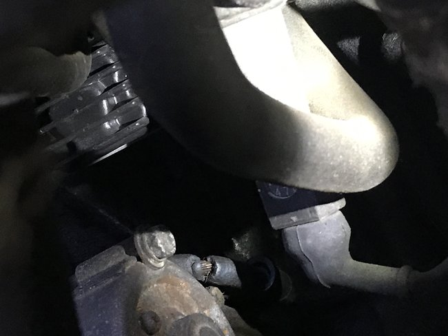

Sorry for the late response. I found the icm it’s above the starter. The module is in the distributer. In the picture you see the icm above the starter bolt.
Mar 16, 2018 at 9:54 AM
BIGRED94
  • 9 POSTS
You can get to it if you take the passenger front wheel off

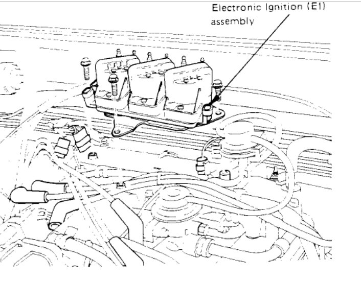

  • 55,748 POSTS
Is this an NPR or Trooper? I found this which shows the module under the coil pack

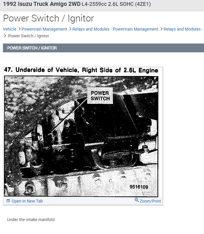

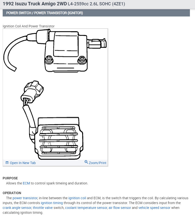

SQM
  • 6,383 POSTS
The ignition control module for the 2.6L Amigo truck is located under the intake manifold, with the coil.
Isuzu calls it power switch/ignitor.
