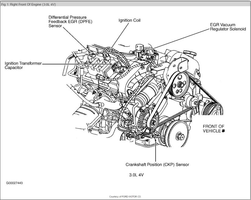

Where is the ignition coil located on an 2002 Mercury Sable? I am getting a P0305 error code saying there is a misfire on cylinder 5.

Hi Hkydad37,
These coils are known for failure, here is your diagram, you will need basic tools to complete the job. Here is also a video to help do the job as well
https://youtu.be/iDgXwKA-IIc
