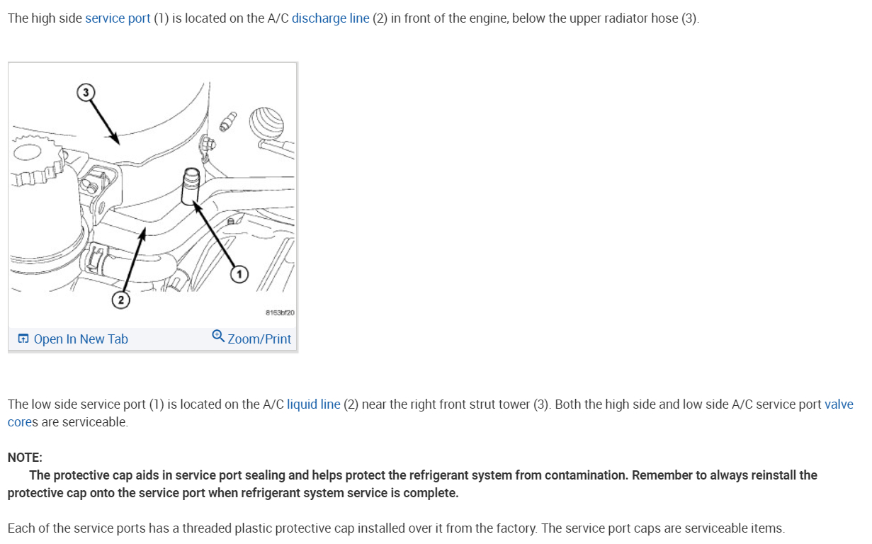

I have a leak and I need the location of the high and low-pressure port and how to remove the front grille to check the condenser for leaks.
Aug 30, 2023 at 2:10 PM
  • 55,677 POSTS

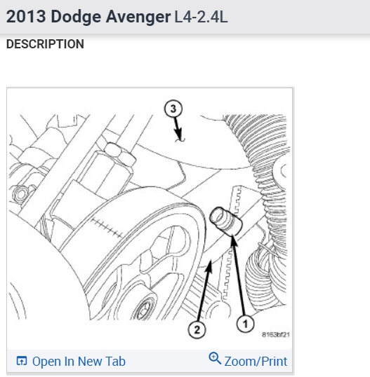

Sure, here are the low and high side AC service ports. This video and guide may help as well:
https://youtu.be/ON2dYcmXIAw?si=qCAfnVe5b18AACVm
and
Check out the images (below). Please let us know if you need anything else to get the problem fixed.
Aug 31, 2023 at 7:27 AM
JSDORN
  • 12 POSTS
are you saying the low side port is on the passenger side near the strut? Do i have to pull the wheel to see it? My other question was, how do I remove the front grill to check the condenser for leaks?
Sep 1, 2023 at 4:58 AM
  • 55,677 POSTS
Yes, you may need to remove the tire and the fender well. For the grill issue please create a new question. We only handle one problem per thread, please post your new question here, you must be logged in.
