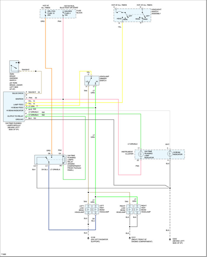

Can you tell me where the headlight relay is located on my truck listed above?

You will find the wiring diagram below. There is no headlight relay shown, so I would say it doesn't use one and that is why you cant find it.
