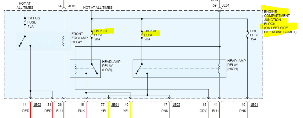

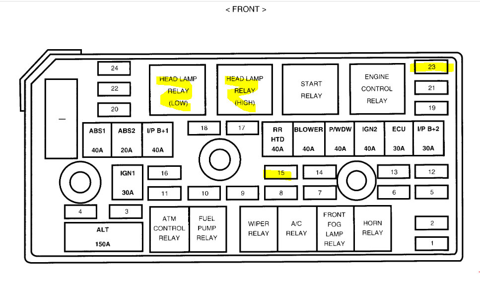

Where is the headlight fuse located?
2007 HYUNDAI AZERA
100,000 MILES
JAMIE JONES2
The headlights are no longer working, and I can't locate the fuse for the headlight to make sure it's not blown.
Aug 5, 2022 at 3:14 PM
  • 110,194 POSTS
There are two fuses, one for high and one for low beams. Additionally, each one has a relay. These things are located in the under-hood fuse box.
I attached two pics below. One shows the wiring schematic for the lights and the other shows the fuses and relays.
Let me know if this helps and what you find.
