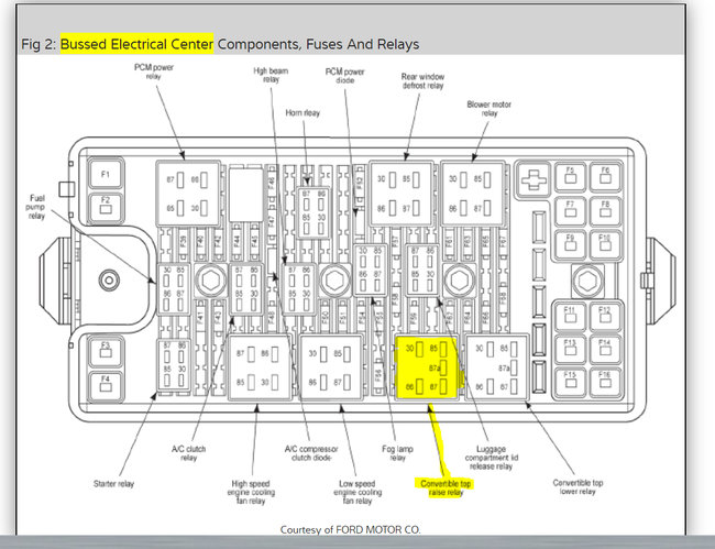

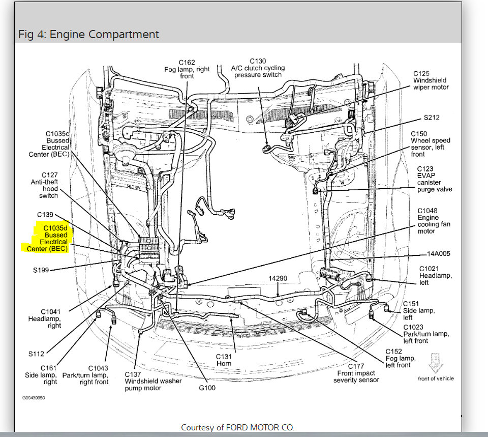

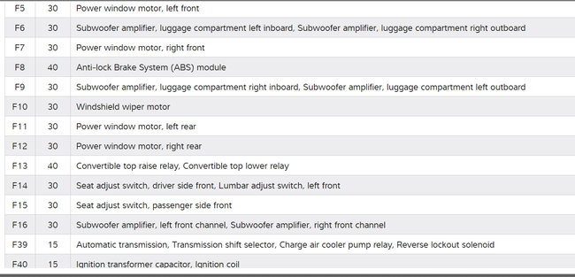

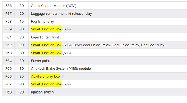

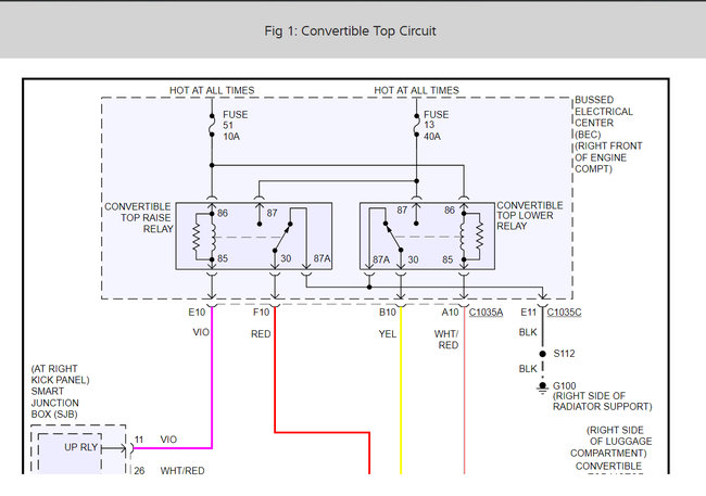

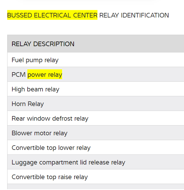

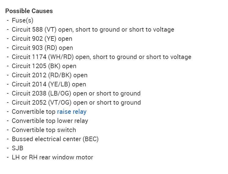

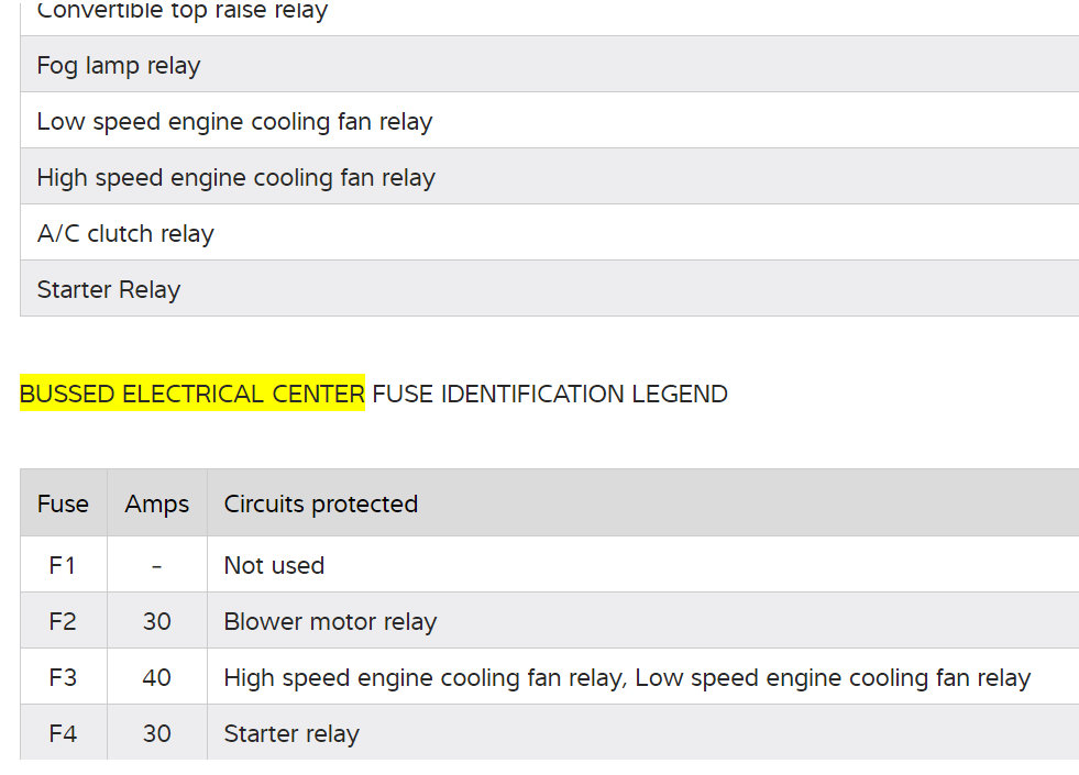

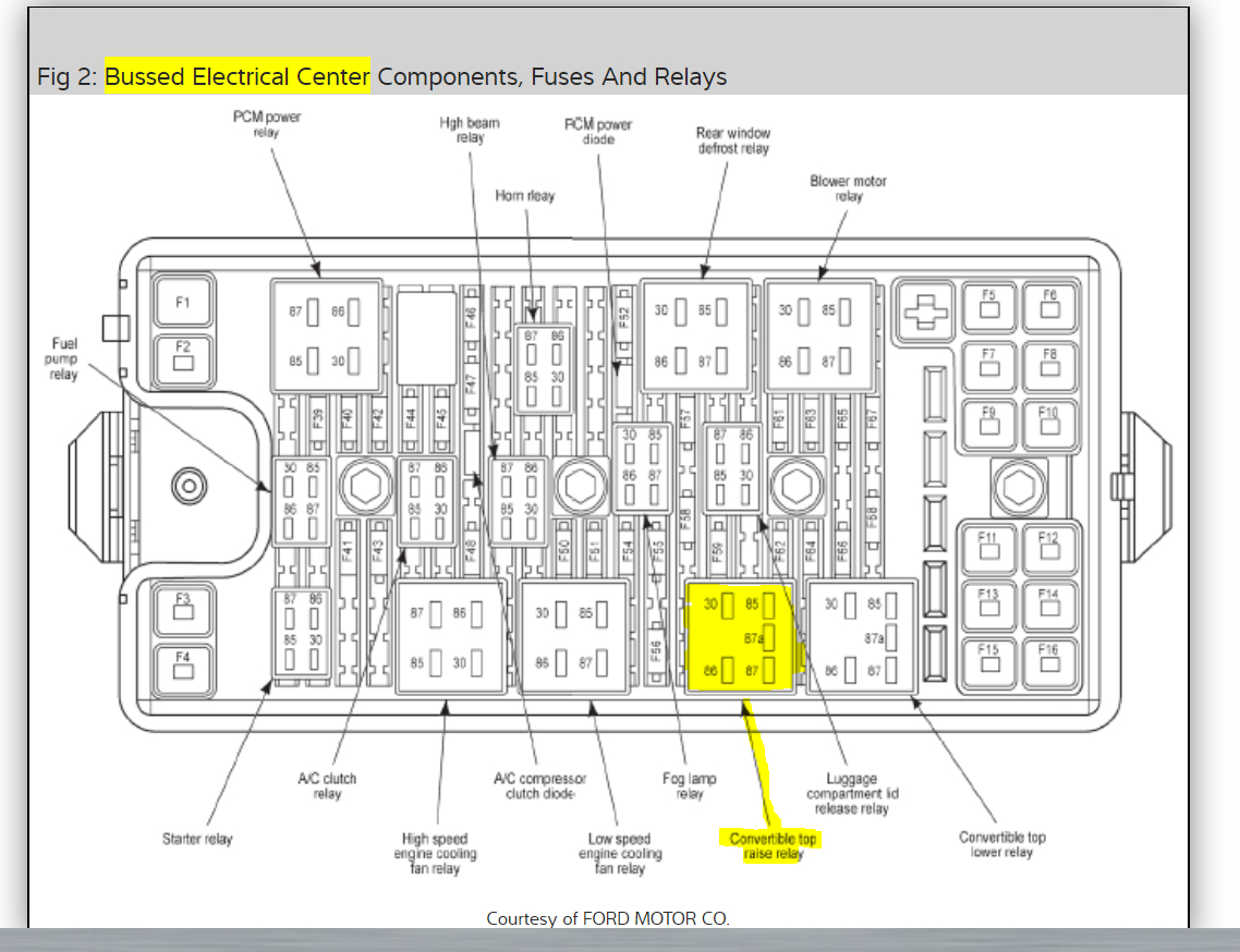

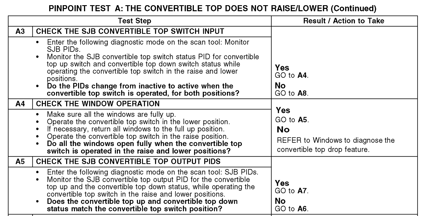

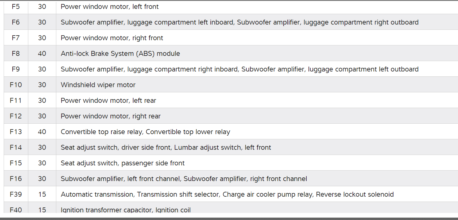

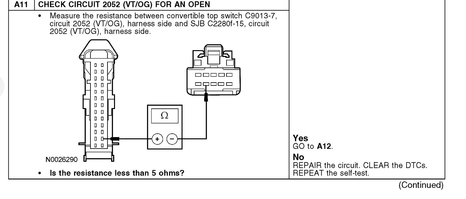

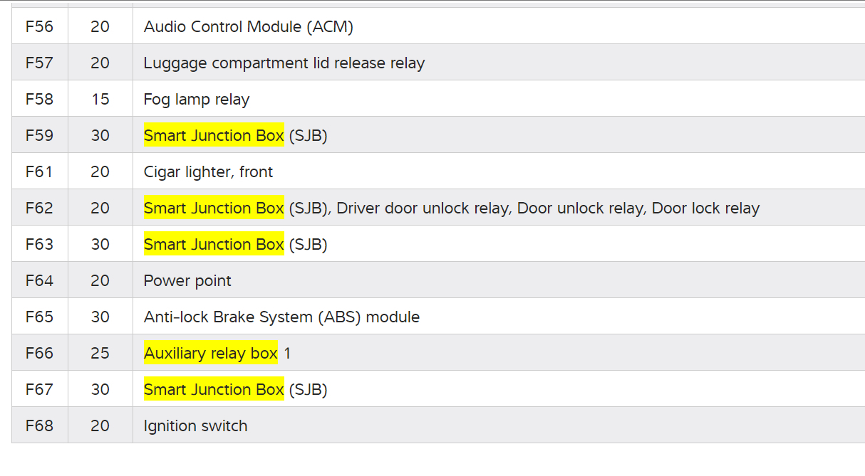

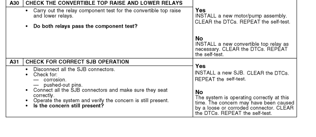

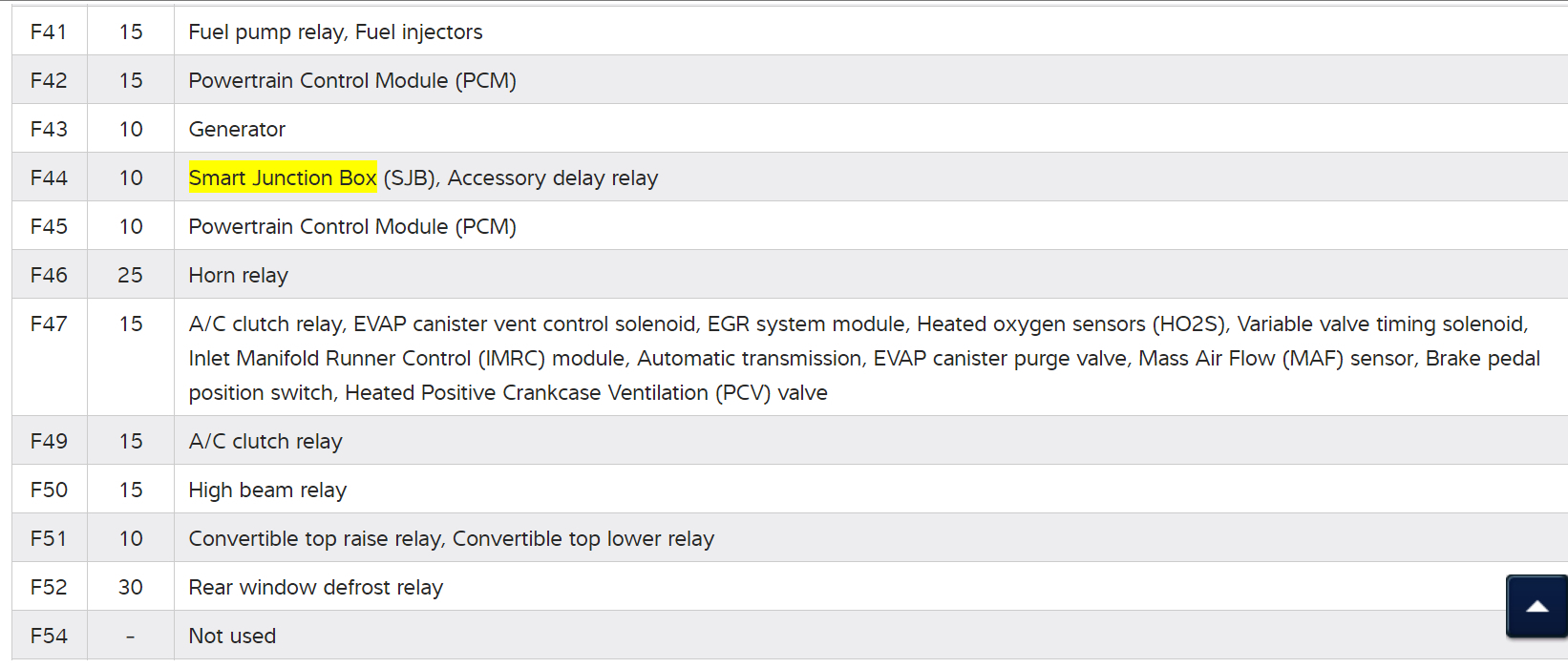

My convertible isn’t converting. I have added hydraulic fluid to it and I have bought new relays. So the problem I believe has to be the fuses, but I do not know where they are located.

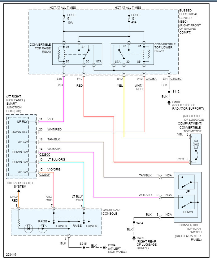

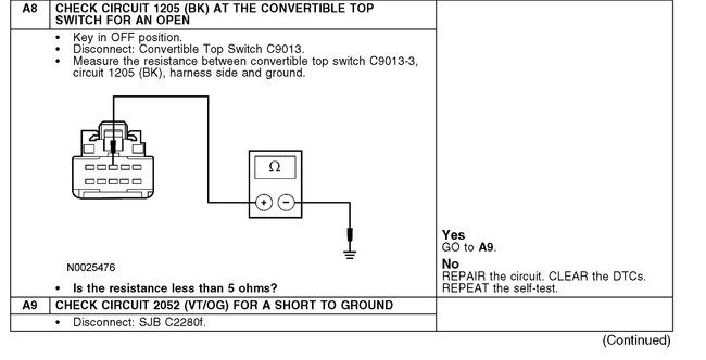

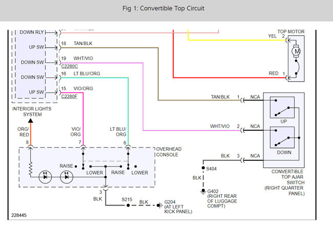

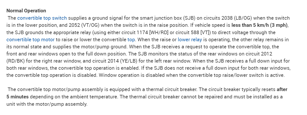

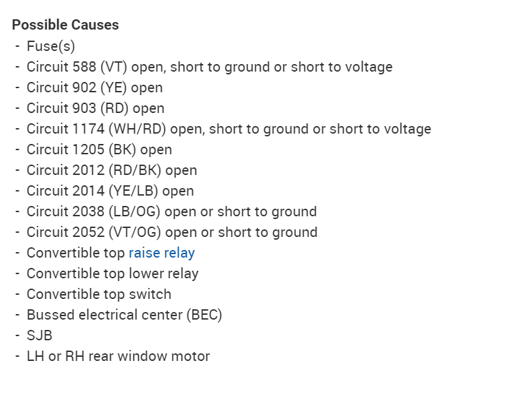

I have included the information that you requested in the diagrams down below. Please go through this guide and get back to us with what you are able to find out. We will be able to go from there. Here is the wiring diagrams for the top as well.

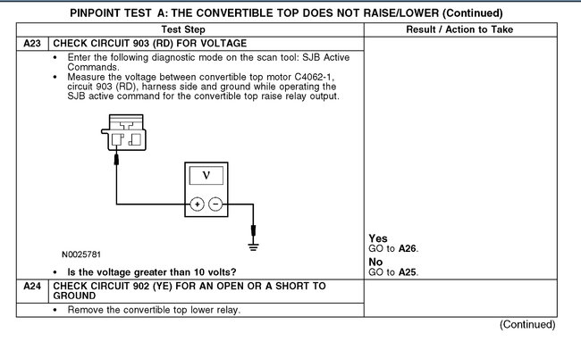

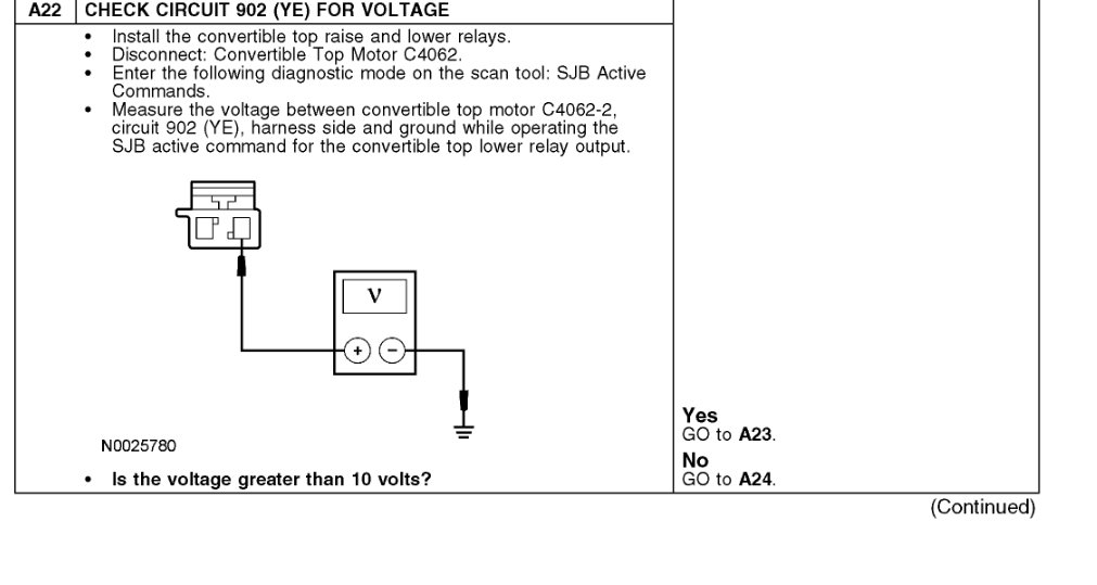

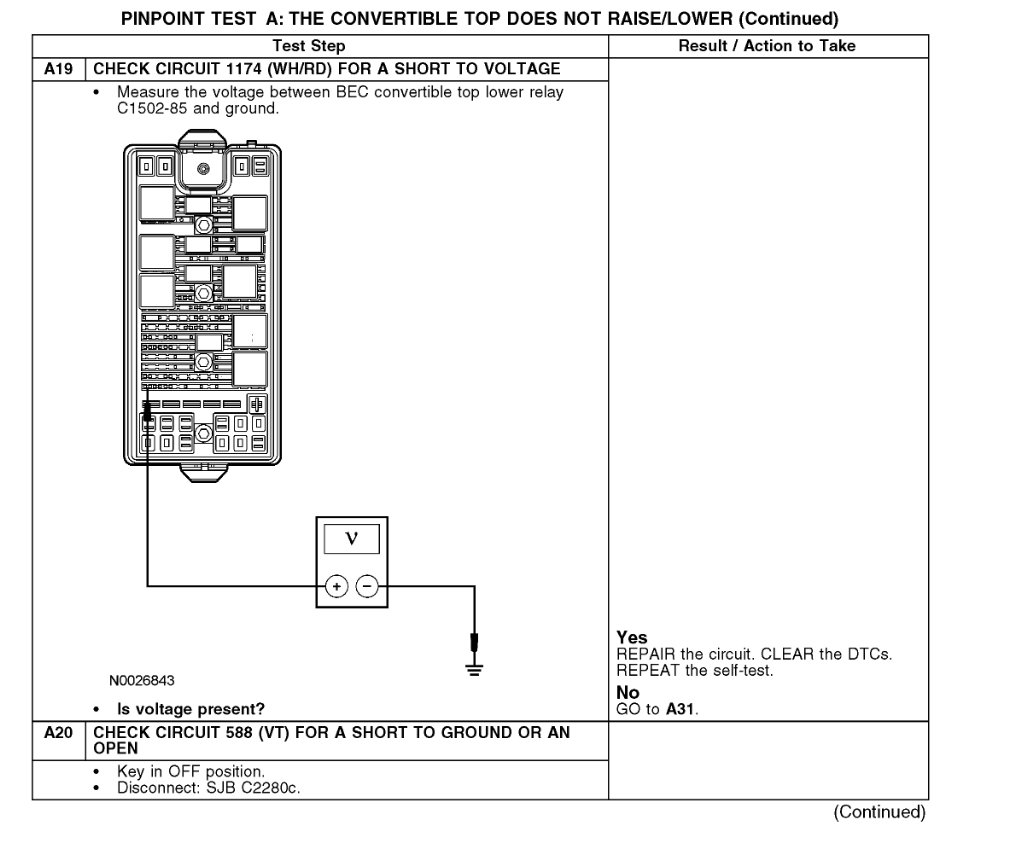

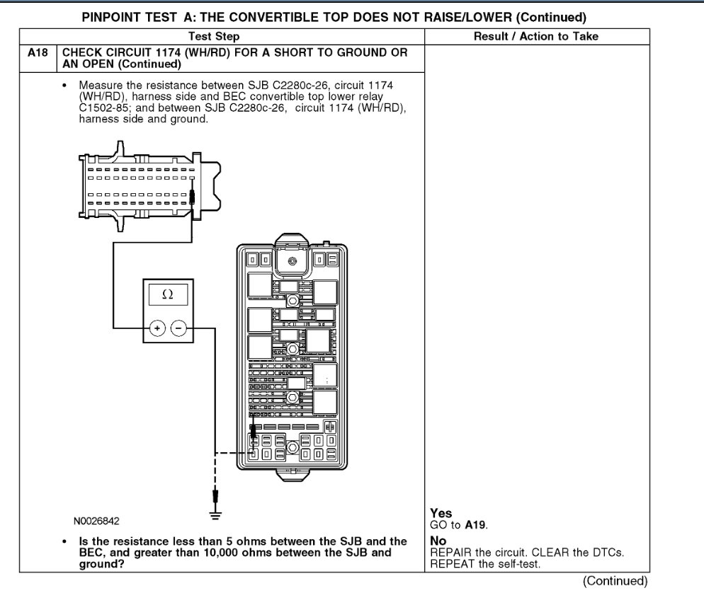

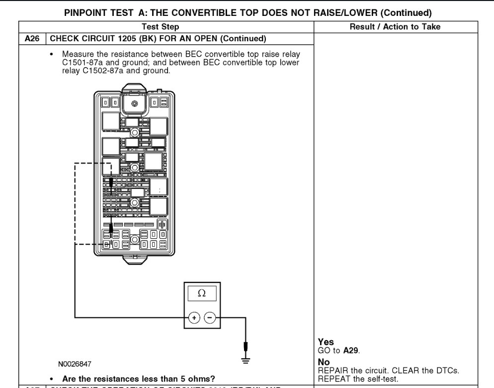

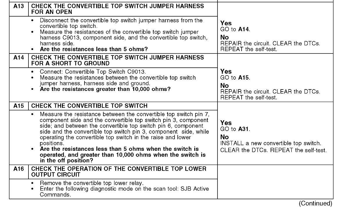

Thanks for the reply! I checked the fuses and they all seem to work fine, but the convertible roof would not still go down? What else could cause this? Also, where can I find the fuses that control the switch, maybe the switch is the problem, I really don’t know at this point.

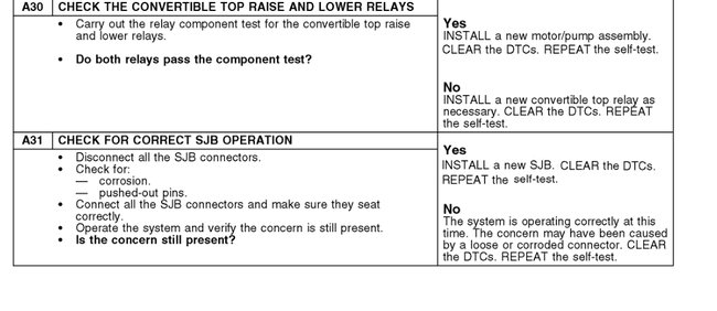

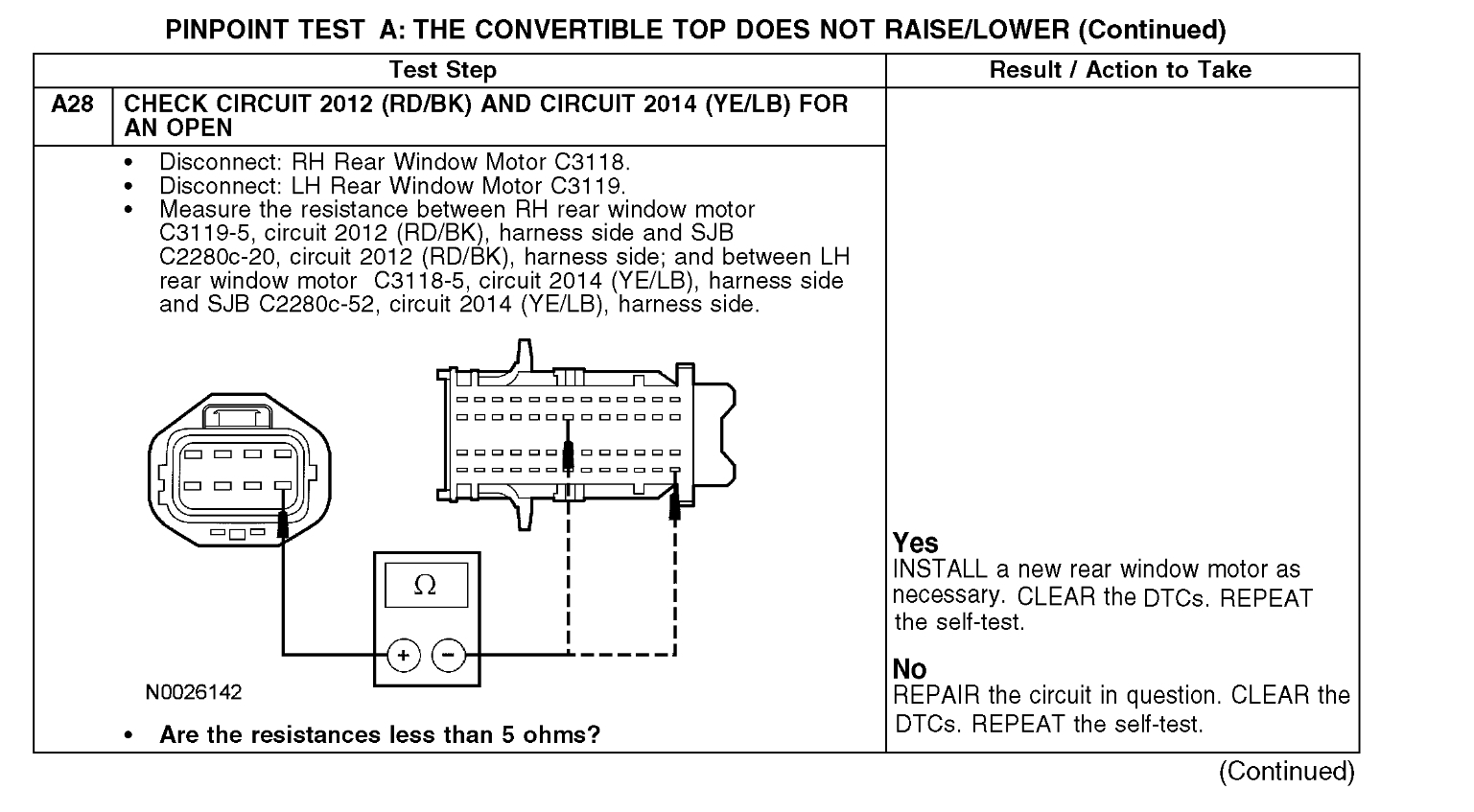

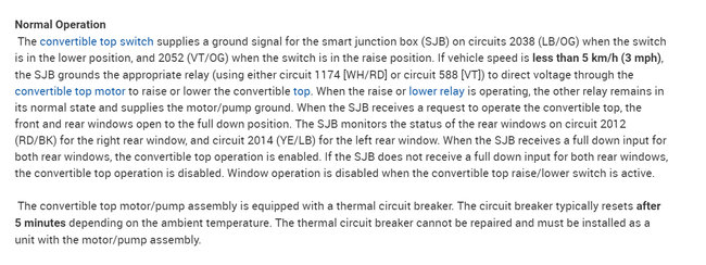

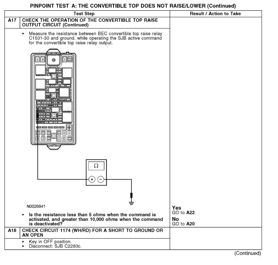

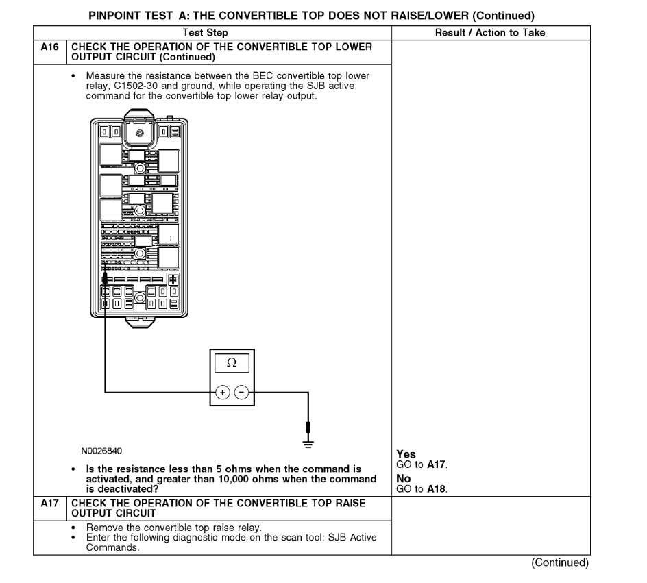

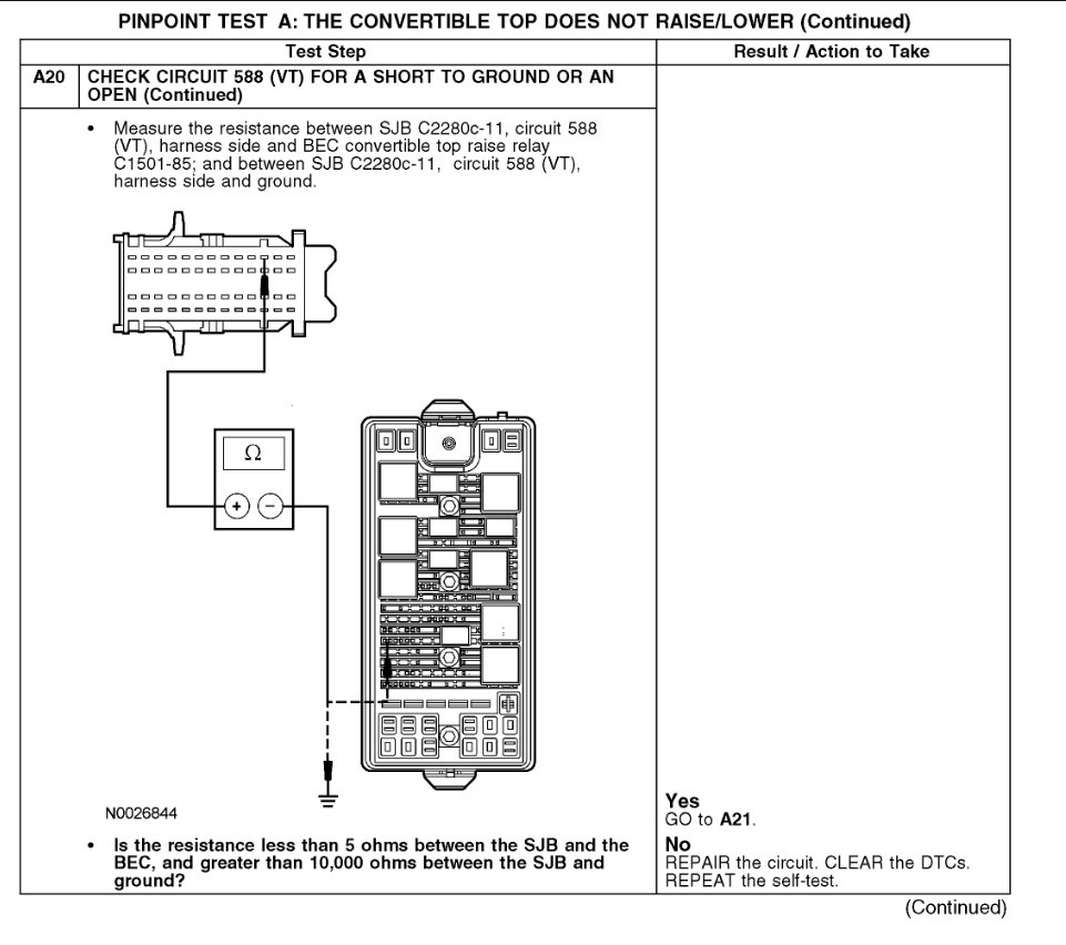

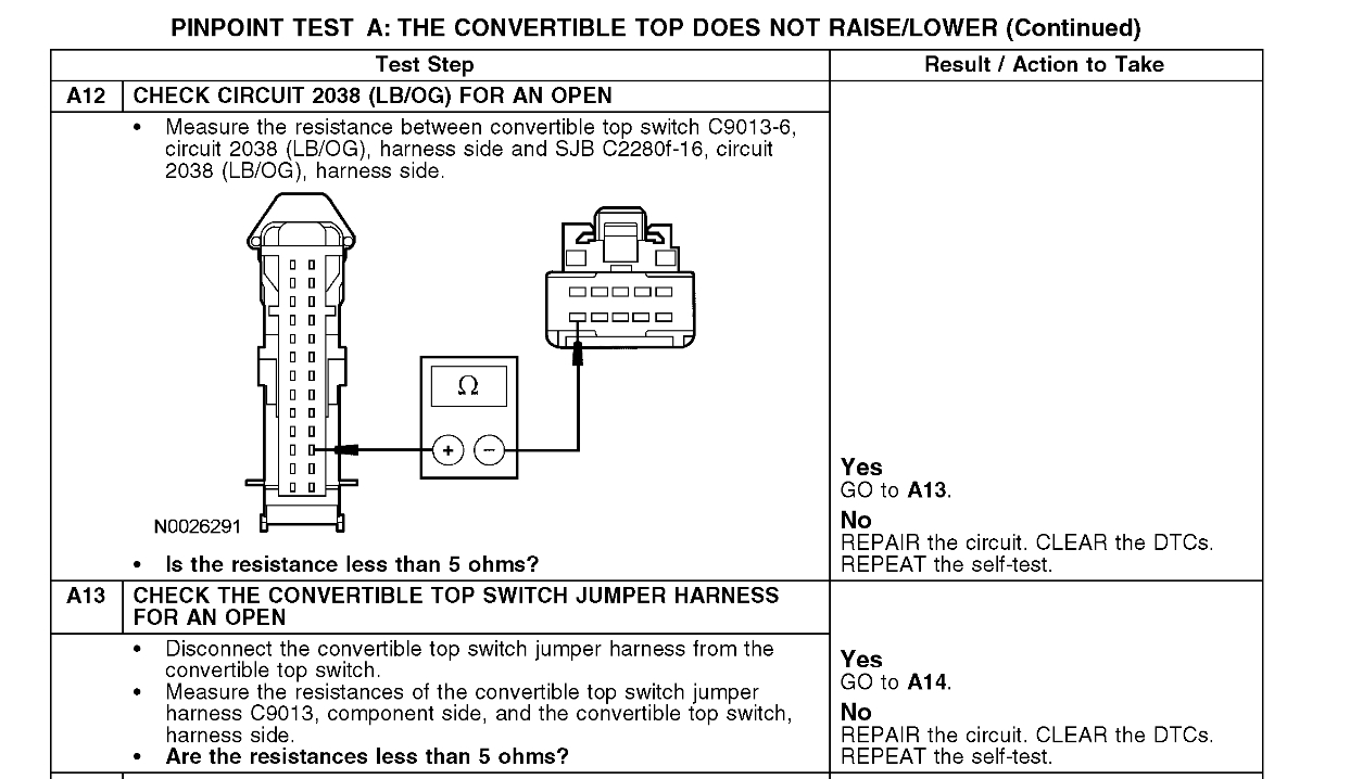

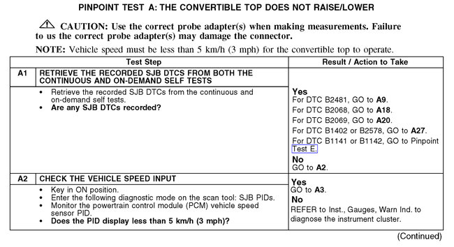

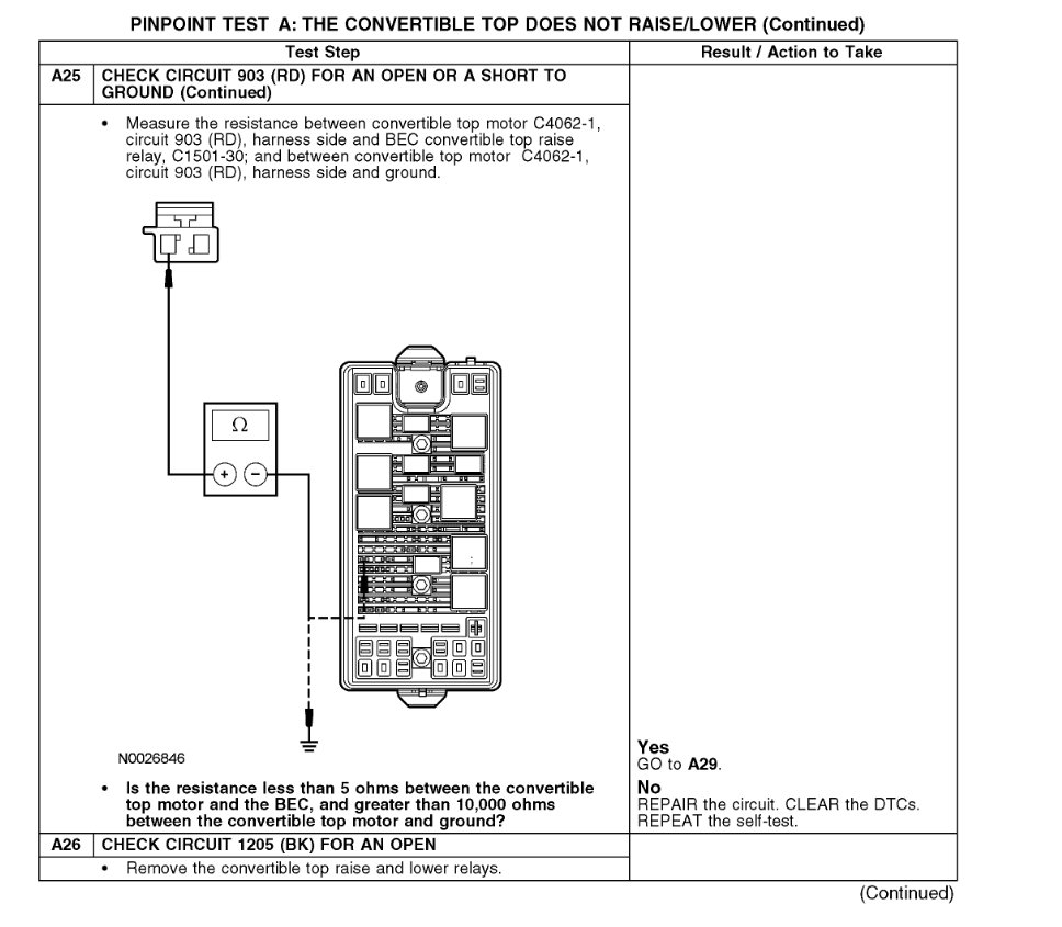

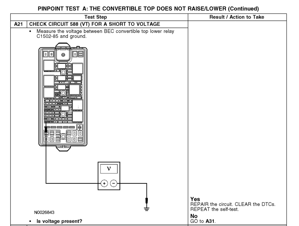

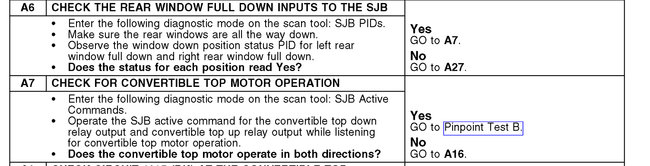

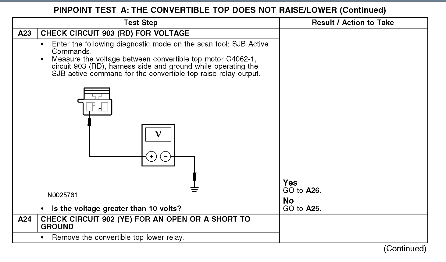

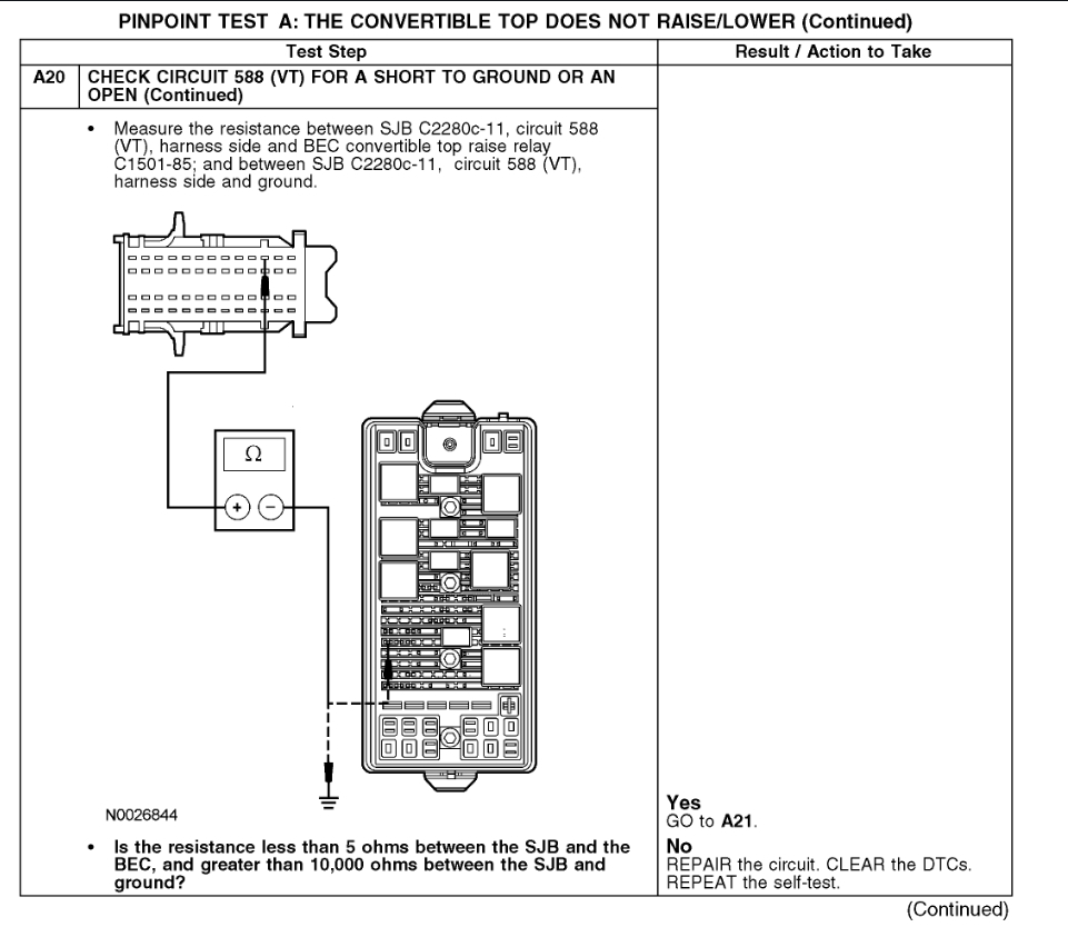

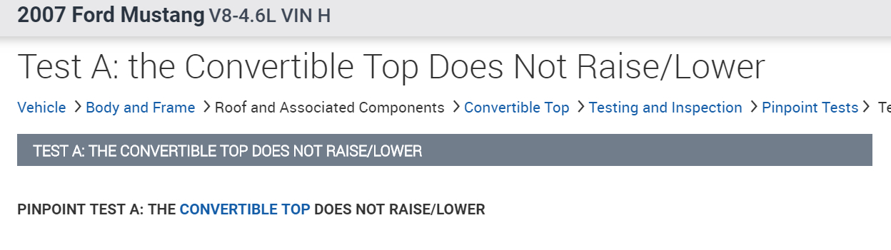

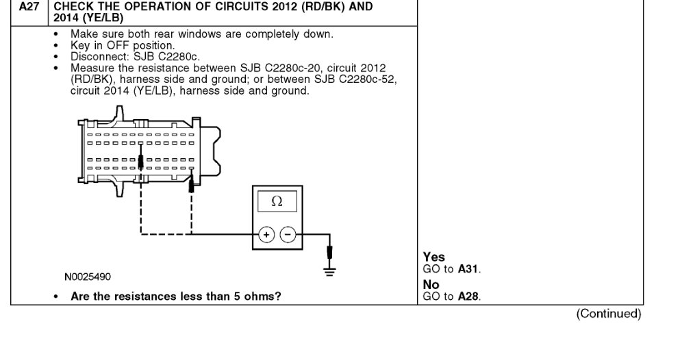

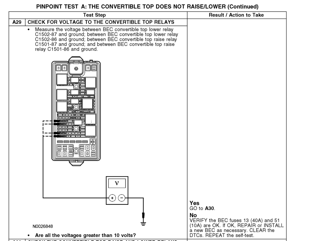

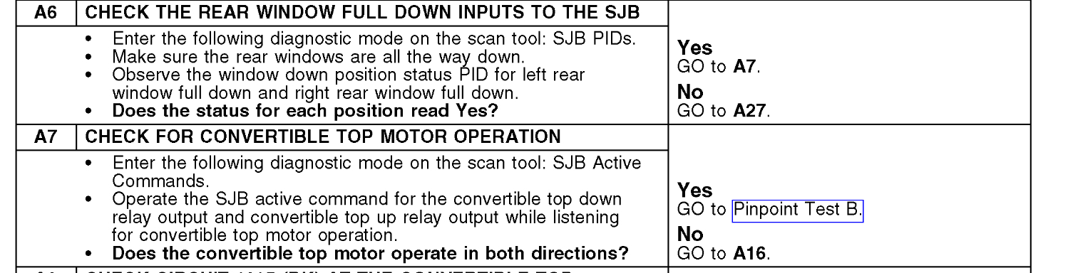

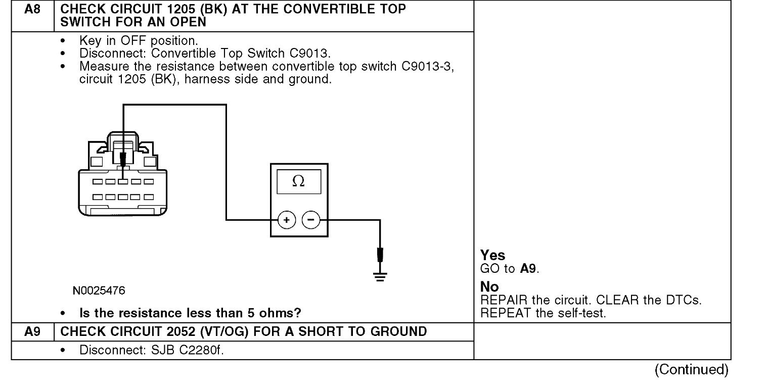

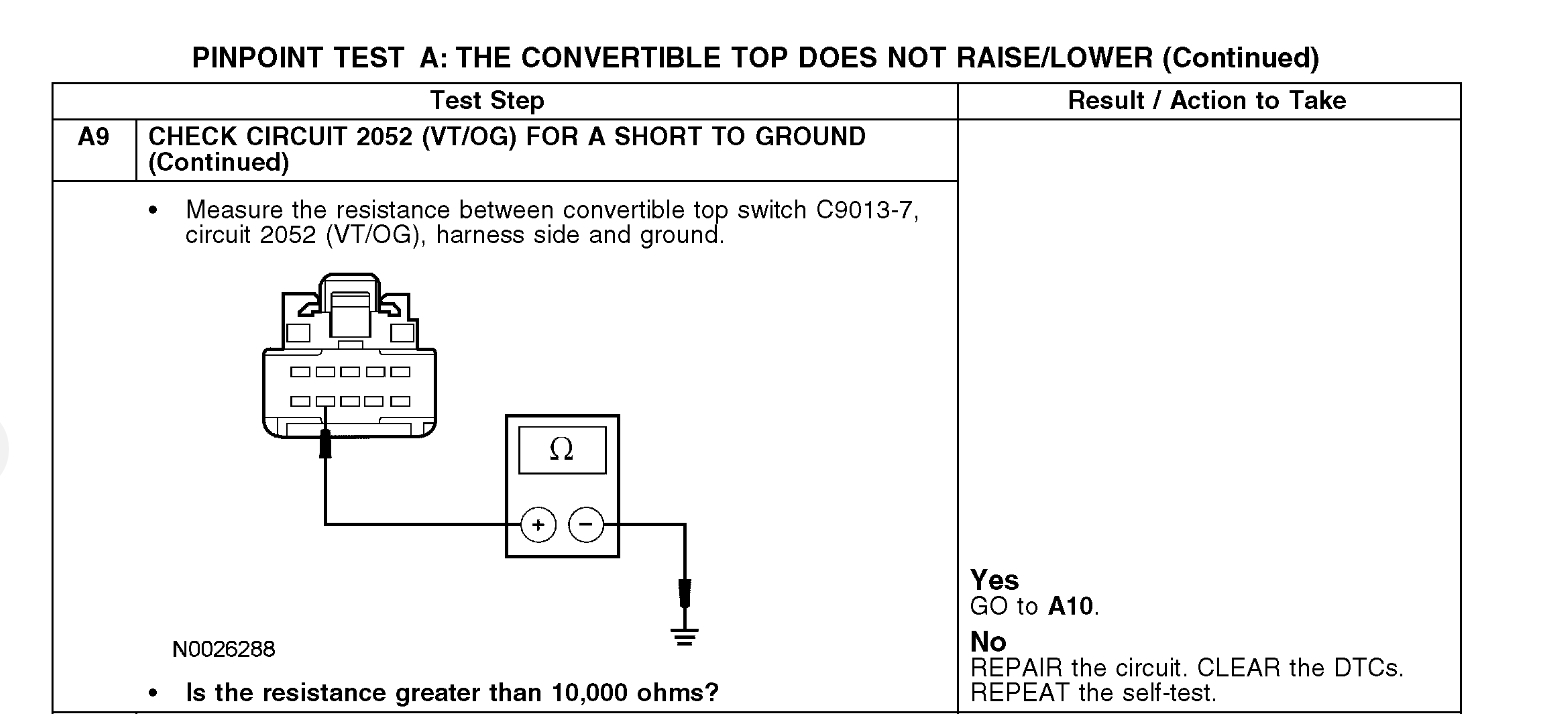

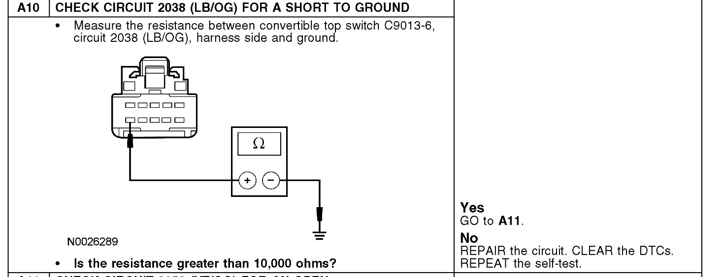

Hello again,
Okay, in the diagrams down below I have included the factory diagnostic troubleshooting flowchart for your vehicle's convertible top being inoperable. It is quite extensive and will require you to use a multimeter so here is a link if you are unfamiliar with how to use one.
