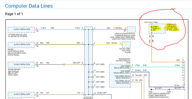

Engine light came on and attempted to have the code read. The code reader did not light up and was told the fuse was probably out. The car manual doesn't specifically say where this fuse is.
Sep 16, 2022 at 9:59 AM
  • 110,194 POSTS

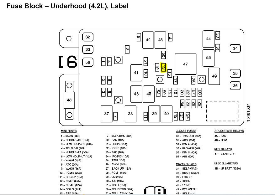

The power supply to the DLC is provided by the cigarette lighter fuse in the under-hood fuse box. It's fuse 13 and is a 20-amp fuse.
If you look at pic 1 below, I provided the wiring schematic of the DLC and highlighted the fuse that sends power to pin 16,
When you check the fuse, make sure it is good. Also, make sure there is power to and from it.
See pic below. Pic 2 shows the fuse location.

I apologize for taking so long to respond. This worked and helped me very much.
