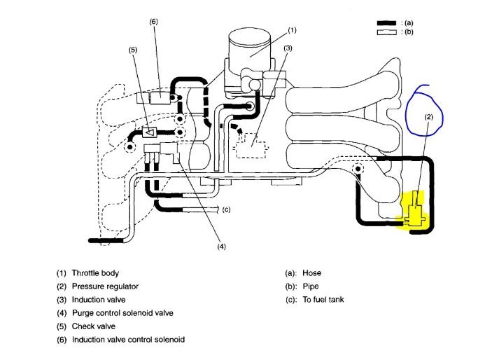

There is no shut off or reset. Can you tell me what is happening? If pressure is low, have you checked the pressure regulator? I attached a picture below showing location.
Next, is the new pump doing the same thing as the original? Have you confirmed that there is 12v going to the pump?

Cannot find the pressure regulator.

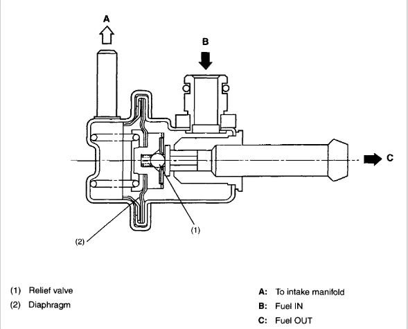

The regulator is actuated via engine vacuum. If you look at the attached pic, engine vacuum is supplied via letter A. What to do is first, remove the vacuum hose and check to see if there is any evidence of fuel in it. If there isn't, inspect the vacuum hose to make sure it is in good condition and not cracked, or disconnected.
Since the engine won't run, you have to connect a fuel pressure gauge to the system the same as if you are checking pressure. Then, using a vacuum pump, apply vacuum to the regulator. If it is working, pressure will drop. If there is no change, the regulator isn't working.
