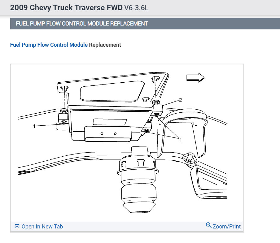

The car starts but when put in gear it shuts off. Can't restart. Shutters when accelerating. Is the control module inside the fuel tank or mounted on the fuel rail somewhere?
Apr 3, 2023 at 10:30 PM
  • 55,802 POSTS

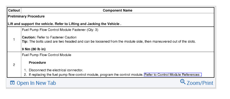

The fuel pump control module is located at the rear of the vehicle on the right side near the snubber for the rear differential. Please check the images below so you can see what I am talking about. Check out the images (below). Please let us know if you need anything else to get the problem fixed.
