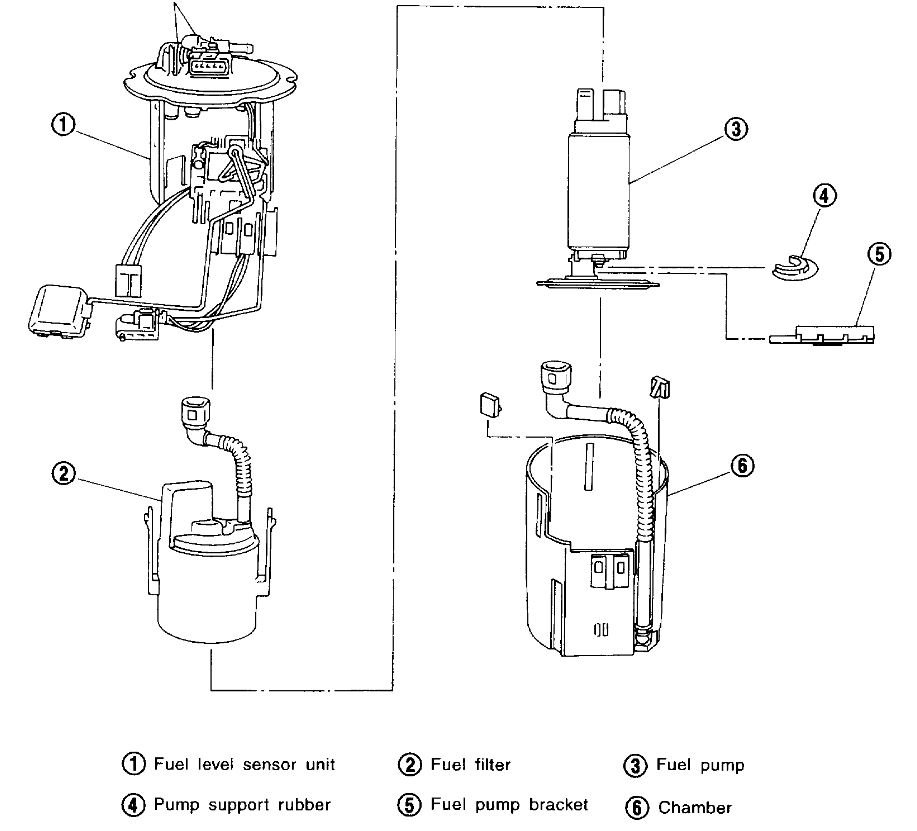

Where is the fuel pump located?

The pump is inside the fuel tank along with the fuel filter. There is an access port below the rear seat so you wouldn't need to drop the fuel tank if you need to replace it. The Hitachi part number is FUP0013.
Image (Click to enlarge)
