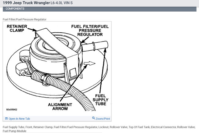

I think I need to replace the fuel filter. When I am driving, at varies times it feels like the vehicle is about to stall, and it feels like it is being pushed along instead of driving. After a few seconds it returns to normal.
Dec 18, 2018 at 9:34 AM
DANNY L
  • 5,648 POSTS
Hello, I am Danny,

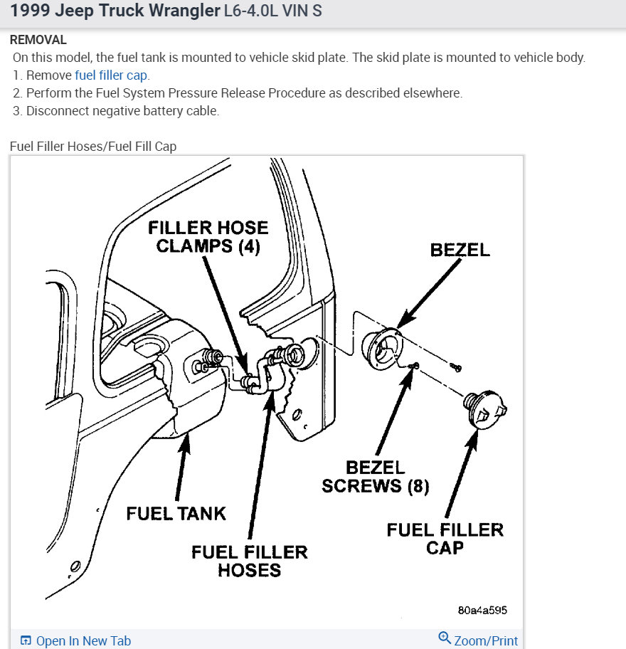

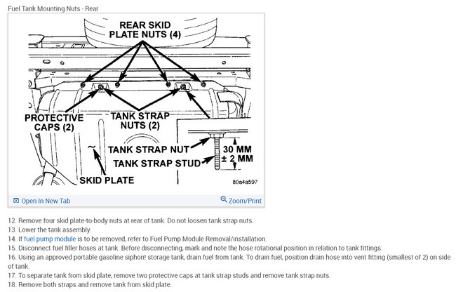

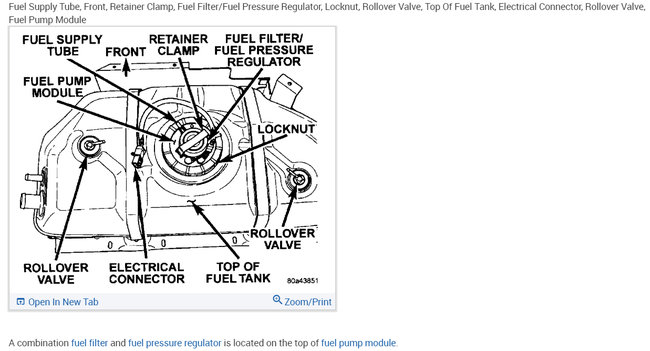

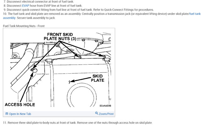

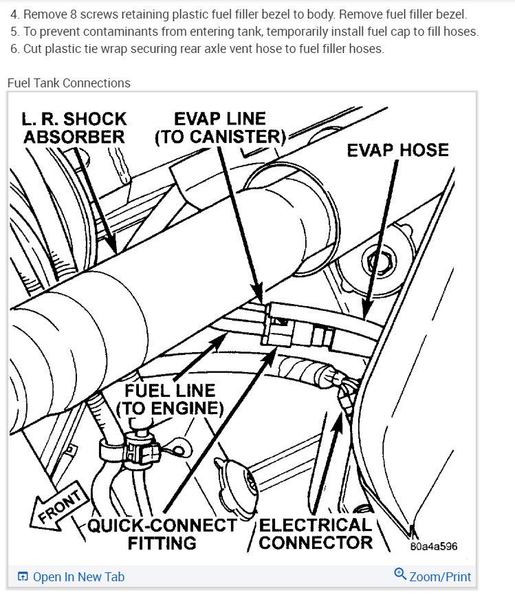

So that you know the fuel filter is a part of the fuel pump assembly which is mounted in the fuel tank.You would have to drop the fuel tank to gain access to remove the fuel pump/filter assembly. Hope this helps and thanks for using 2CarPros.
Danny-
Dec 18, 2018 at 11:47 AM
  • 54,837 POSTS
Here is a guide to help you drop the tank step by with diagrams below to show you how on your car:
https://www.2carpros.com/articles/how-to-replace-an-electric-fuel-pump
Check out the diagrams (below). Please let us know if you need anything else to get the problem fixed. Cheers, Ken
