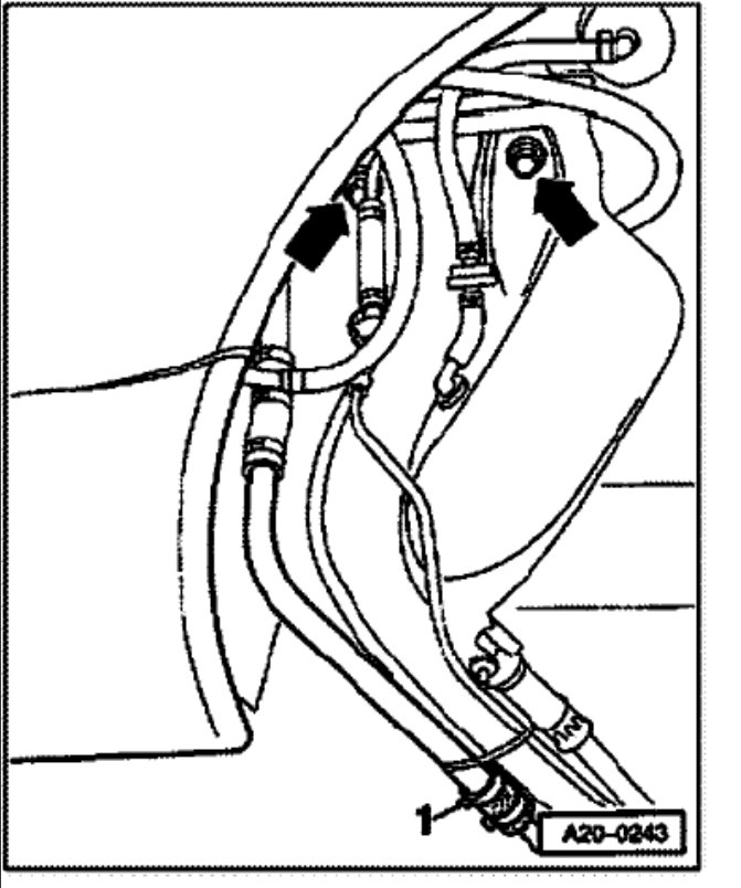

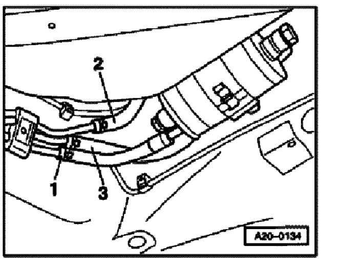

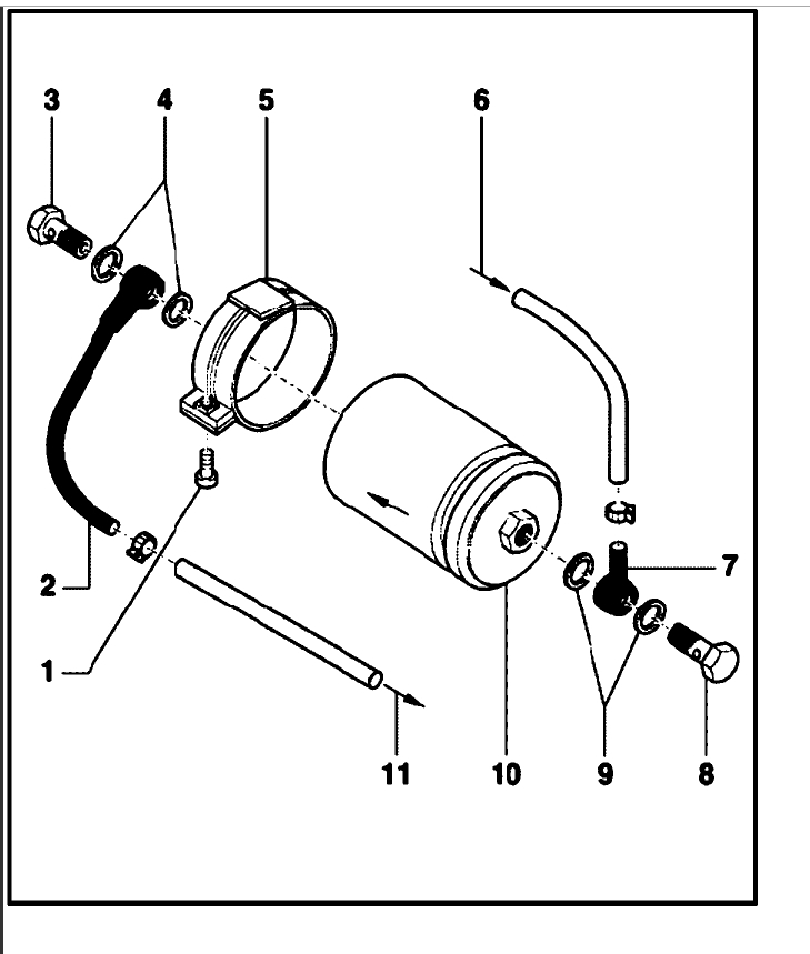

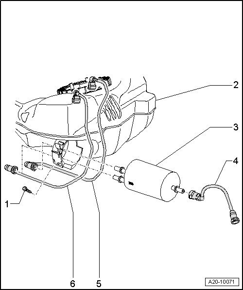

I am having a problem locating my fuel filter. I located the fuel regulator underneath on passenger side and I am wondering if they are both combined into one. please help.
Nov 28, 2017 at 12:36 AM
PATENTED_REPAIR_PRO
  • 1,853 POSTS
Yes, you are correct. Fuel filter with pressure regulator. It is number three in this diagram. Check out the diagrams (Below). Please let us know if you need anything else to get the problem fixed.

Where is the fuel filter located on the A6 2.7?
Sep 24, 2020 at 10:13 AM (Merged)
  • 75,992 POSTS

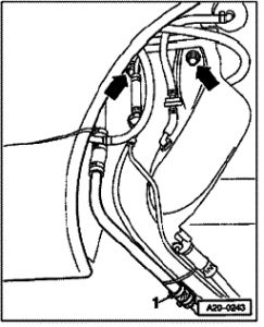

Servicing fuel filter Fuel Filter Located Behind Cover
https://images.2carpros.com/forum/automotive_pictures/12900_f1_16.jpg
Remove 2 bolts (arrows) for fuel filler neck underneath rehousingg liner. WARNING: Fire Hazard. Do not smoke, work near heaters or have anything in the area that could ignite the fuel or fumes. Fuel supply lines are under pressure! Before loosening any lines, cover the connection with a rag. Release the pressure by slowly separating the connection.

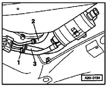

https://images.2carpros.com/forum/automotive_pictures/12900_f2_16.jpg
Fuel Filter With Cover Removed Mark supply line -3-, return line -2- and vent line -1- and disconnect https://www.2carpros.com/kpages/auto_repair_manuals_alldata.htm

I need to know the location of my fuel filter for my car listed above it is the Quattro model.
Sep 26, 2020 at 10:38 AM (Merged)
  • 54,840 POSTS
It is under the car near the tank. You will need a jack to get to it.

Where is the location of the fuel filter in an Audi A6 Year 1998
STEVEW84
  • 673 POSTS
Fuel filter is located in front right outside at fuel tank
