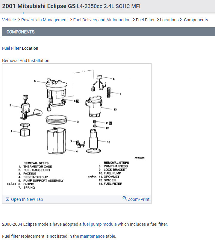

Accidentally added diesel fuel to my tank, where is the fuel filter located?
2001 MITSUBISHI ECLIPSE
270,000 MILES • 2.4L • 4 CYL • 2WD • AUTOMATIC
JOSHMC1986
  • 11 POSTS
My car listed above (GS) is not starting. My spark plugs, battery, are all good. I accidentally put roughly 0.5 gal of diesel in my car when i was completely out of gas. I went to go somewhere and i started my car immediately put it in reverse and went maybe 1 foot and the car shut off and hasn't been running since. So i took almost all the bad gad out and took my fuel pump out and cleaned it and i put it back in when i think still had that diesel in the tank, but i put new gas into maybe 5 gallons and added a fuel cleaning additive and she still isn't starting. So I'm guessing i need to drop the tank and clean the filter maybe but I don't know where it is. Also should I flush the fuel lines also if so how do I do that? If you can tell me anymore information on what i should do i would like to hear any input to my ordeal. Thank you

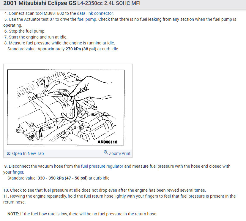

The fuel filter is a part of the fuel pump in the tank.
Since diesel fluid is thicker than gasoline it will clog the fuel pump and the filter first. It can also clog your injectors if enough of it goes through.
Can you hear your fuel pump come on?
Many times the thicker fluid will burn up the pump as it will essentially run dry due to being clogged.

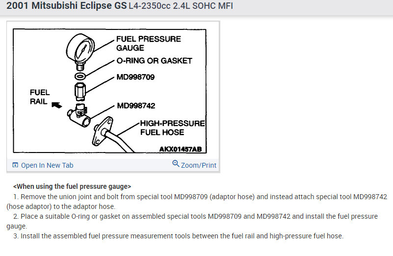

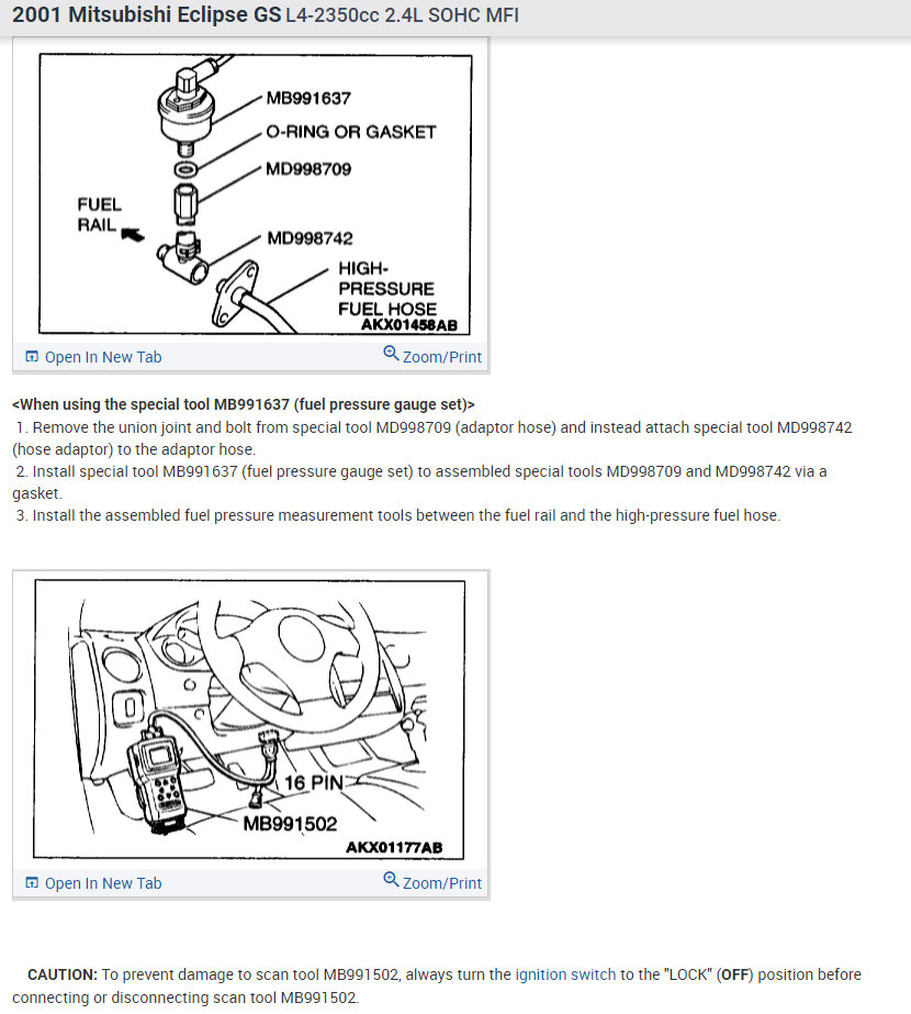

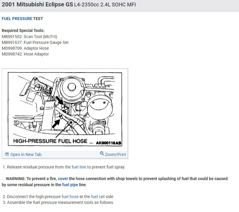

If the pump comes on you need to check to see if you are getting fuel to the fuel rail. I have attached the fuel pressure testing procedure below.

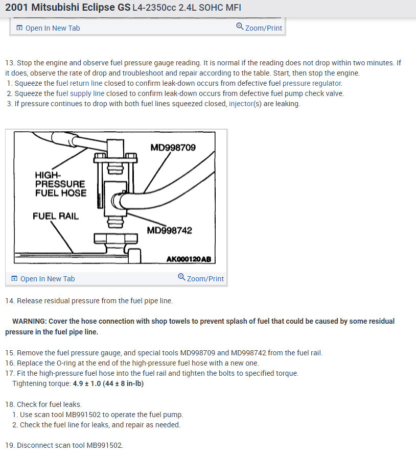

After you get the fuel tank cleaned and pump installed make sure that the pump is coming on and check the fuel pressure at the rail that will tell you if there is any clog in the lines. You should be able to get a fuel pressure test gauge from your local auto parts store to use.

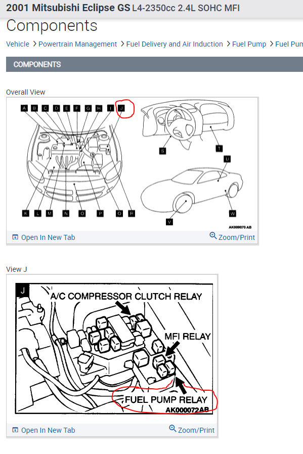

Oh, one more thing? I have no clue where my fuel pump relay is and i don't know what it looks like.
Sep 9, 2021 at 11:42 PM
SQM
  • 6,383 POSTS

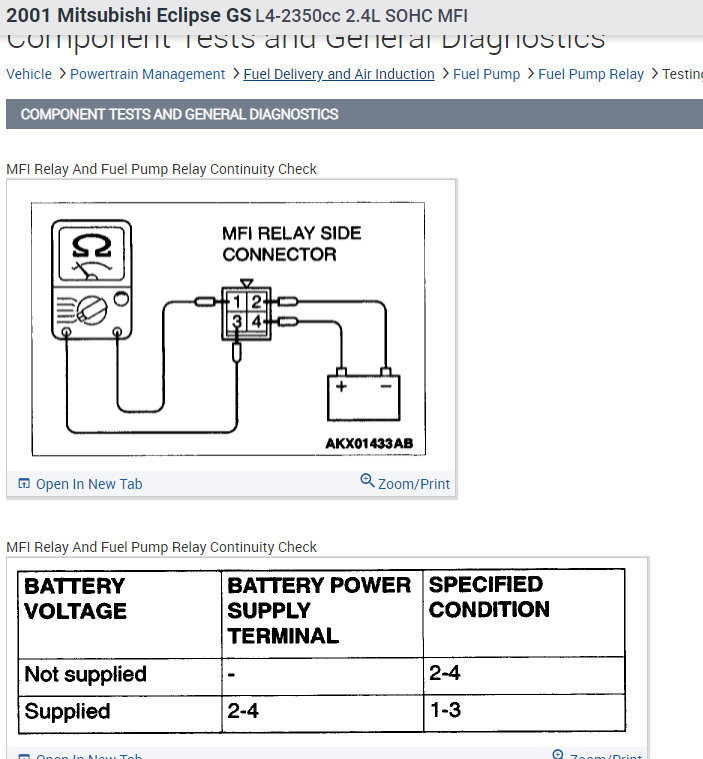

The fuel pump relay is located in the under hood fuse box. See diagram below. Also included the testing procedure.

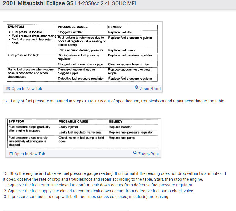

You know it sounds like it is just not getting fuel. Have you already tested the fuel pressure? You could have a clogged regulator or injectors.

Before taking off the injectors you want to make sure that there is enough fuel pressure on the fuel rail. If there is pressure on the rail but injector not spraying then you will need to clean them. However if you do not have a pressure on the fuel rail then the clog/ restriction is some where between the tank and the rail, could be the pressure regulator.
