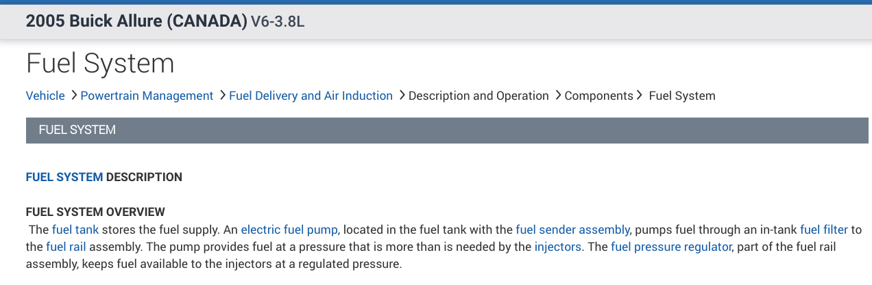

I think maybe it needs a new fuel filter.
Jan 5, 2020 at 8:02 AM
SCGRANTURISMO
  • 4,897 POSTS

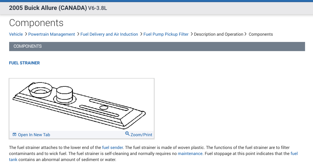

The fuel filter for your vehicle is the fuel strainer, or sock, that attaches to the bottom of the fuel pump. In the diagrams down below I have included a description of your vehicle's fuel system and a description and location of your vehicle fuel strainer. Please go through these guides and get back to us with how everything turns out. I hope this helps.
