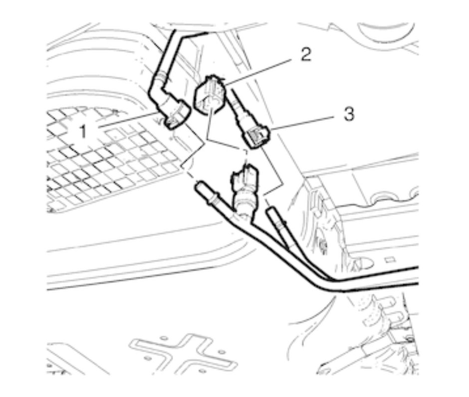

not changed in 6 years.
Aug 10, 2019 at 8:49 AM
Experienced Mechanic
52,796 POSTS
Good evening.

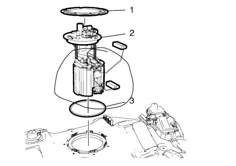

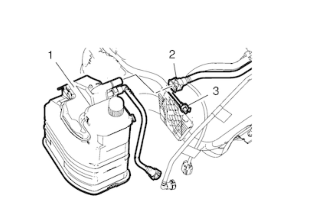

It is part of the fuel pump assembly in the fuel tank. It is not serviced by itself without fuel pump replacement. Here is a guide to help you step by step with instructions in the diagrams below to show you how on your car.
https://www.2carpros.com/articles/how-to-change-a-fuel-filter
Image (Click to enlarge)
Aug 10, 2019 at 9:13 AM
52,796 POSTS

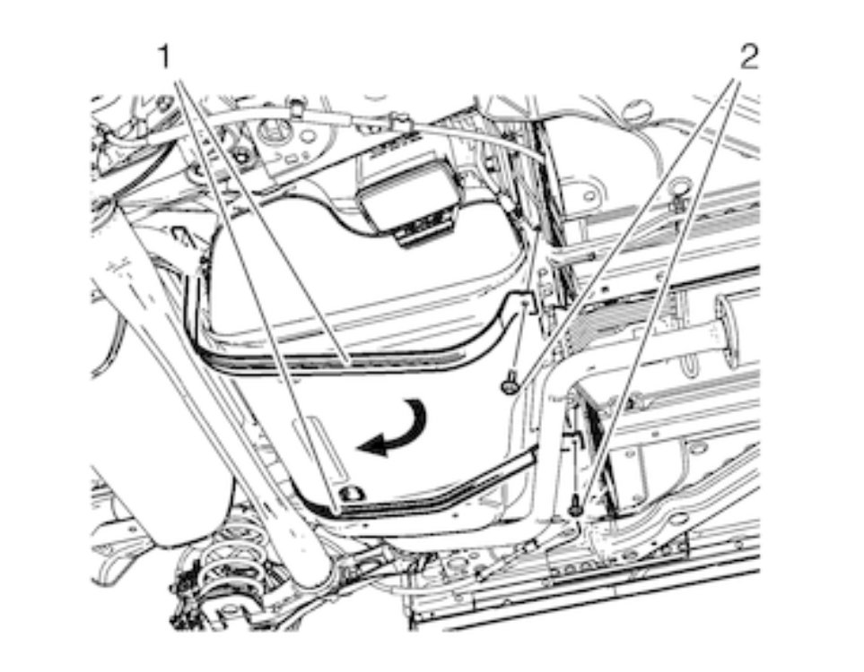

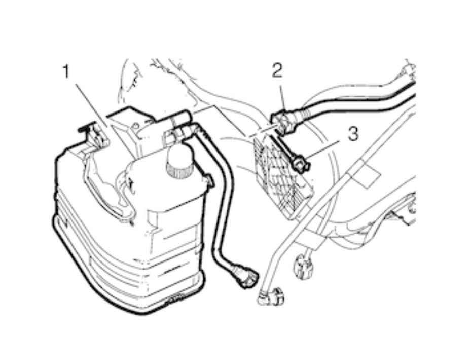

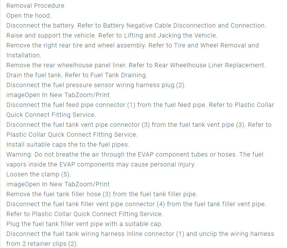

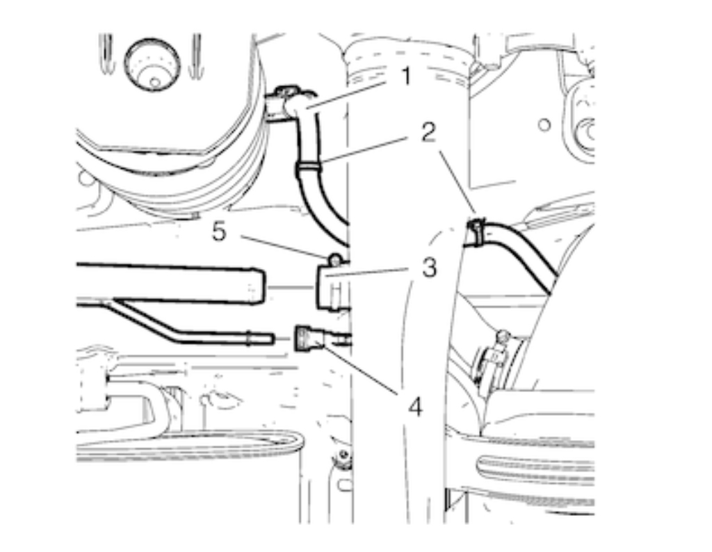

Fuel tank instructions for accessing the fuel pump. I attached them at the bottom with pictures.
Images (Click to enlarge)
