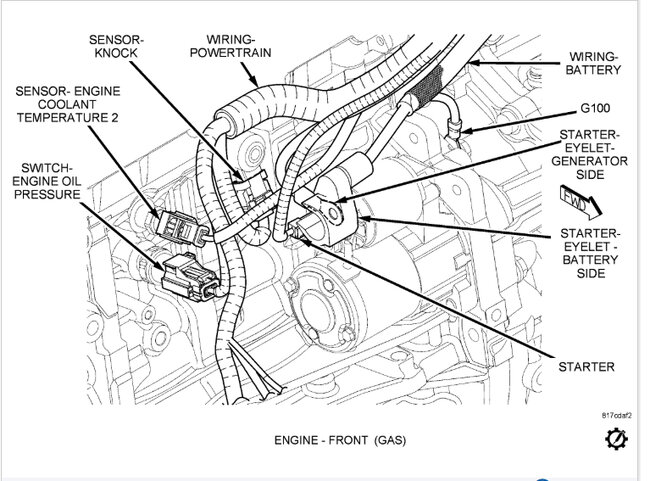

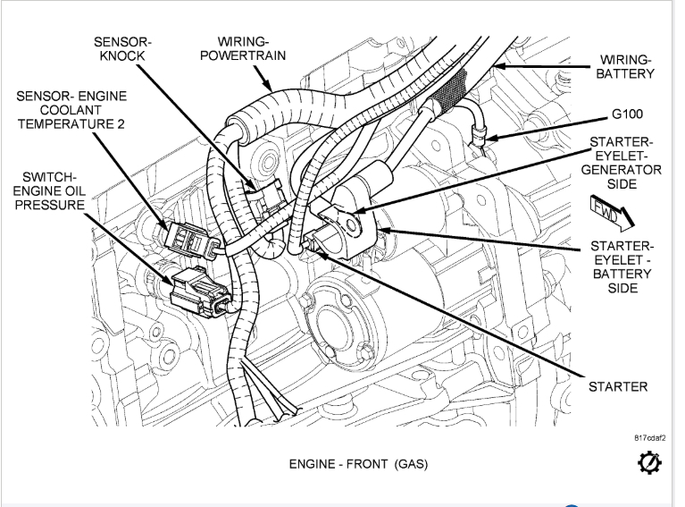

I’ve already replaced the engine temperature coolant sensor that’s located near the thermostat. I’m having trouble finding the location of the second one.
May 31, 2026 at 2:08 PM
  • 55,433 POSTS
What size engine? On e 2.4 liter engine the sensor is near the starter motor. Check out the images (below). Let me know how it goes

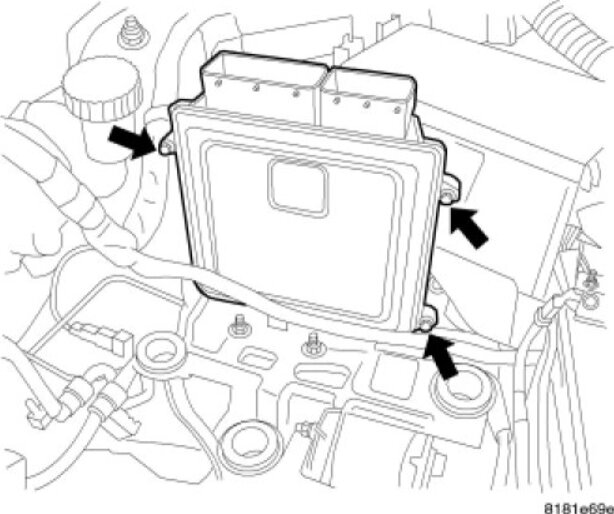

Yep, that is a sign the PCM is bad. Here is the location which is under the hood on the left side so you can send the PCM for testing/repairs. Also, check the electrical connector for corrosion, this can cause weird codes as well. We use this company they seem to know their stuff.
https://www.flashmastersecm.com/
Check out the images (below). Please let me know what happens.
Jun 2, 2026 at 8:10 AM
