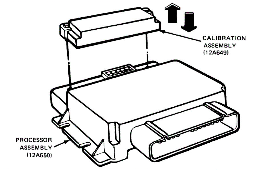

Good afternoon,
I attached a picture and the procedure is below.
Why are you replacing the ECM?
It is under the dash on the left side.
The Electronic Control Assembly (ECA) is located on the left hand hinge pillar.
1. Disconnect electrical connector from ECA.
2. Remove clip attaching ECA to dash panel.
3. Remove ECA.
4. Reverse procedure to install.

I assume I have to remove the dash board to access it, correct?
I am replacing it because for the past 7 months the car has just be quitting on me. The 1st time it happened I checked and found I was getting fuel but no spark. I had to have it towed to my local garage. When it got there it started right up. The next time, same thing. Towed again and this time they changed the ECA relay. Then happened again so I changed the relay (carried a spare in the trunk). Happened again so I put in old relay, no help. Happened again, this time I removed the negative battery terminal for 10 minutes and it started right up. Spoke to my mechanic about it and he too says it could be the ECU itself, he suspected it when he was diagnosing the car earlier.
Your thoughts?
Aug 11, 2020 at 11:27 PM
Okay, as I stated in my response, it is under the dash on the left side. The dash does not have to be removed. All you need to do is go under the dash and look for it. It is attached to a bracket.
It only pays .6 hours in a shop and that is about 36 minutes from start to finish.

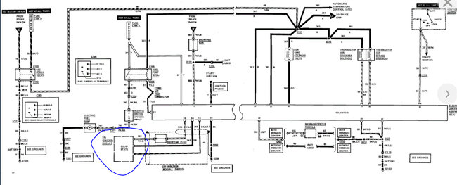

Well, I have changed the ECM and still the same problem! I get no spark when this happens. I have also previously changed the TFI Module. What's next?
Aug 15, 2020 at 4:18 AM
Okay, I attached a wiring diagram for you to view.
Check for power to the ignition module with the key on. Let me know what color wire has battery voltage.
Also, check voltage at the ignition coil positive terminal. That should have battery voltage as well.
Aug 15, 2020 at 8:48 AM

Well, it has happened again, no start. This time I had all the test equipment with me. I 1st tried to use my code reader to see if anything showed. However when I did the KOEO I got absolutely nothing, would not even click all the relays as it always does. I did all the test points at the TFI connector and all were okay except for the ground, got an open circuit. I pre-checked all the test points when the car was working and now I read open at the distributor ground! Now ready for this:
I also brought along a spark tester and I have spark!
I also checked for fuel pressure at the rail Schrader valve and there is pressure.
If you have spark and fuel why is there no start.
Car will still not start after sitting for over 1 hour with the battery disconnected.
Any thoughts?
Could it be possibly the anti-theft module? I don't know how that disables the car?
Aug 21, 2020 at 4:34 AM
Okay, the key here is the code check. The fact you cannot get it to go into key on engine off mode tells the ECM is not working at all.
I am surprised you have fuel pressure. My first thought was the power relay on the left front fender by the headlight. The fuel relay, which is green, is there and the other relay is the power relay. I would suspect that being this issue.
Try replacing it or tap on it and see if it starts.
