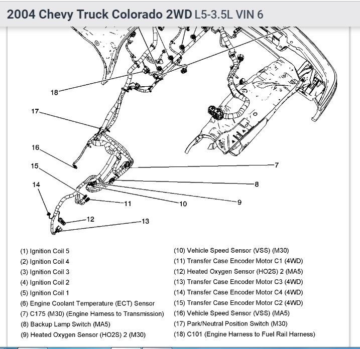

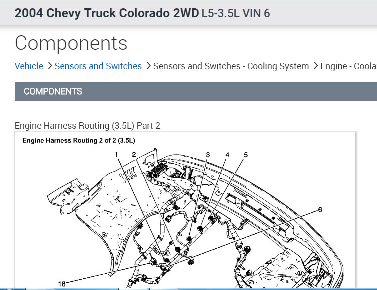

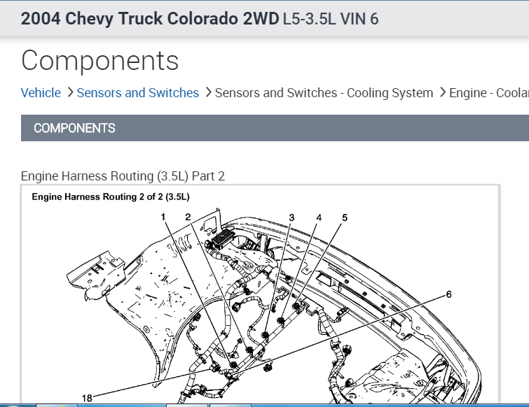

Check engine light is on and code reads coolant sensor. I need to know the location of the sensor.
Apr 4, 2019 at 6:13 AM
SCGRANTURISMO
  • 4,897 POSTS
I have included the information that you requested in the diagrams down below. Please let us know if there is anything else that we can help you with. That is what we are here for.
