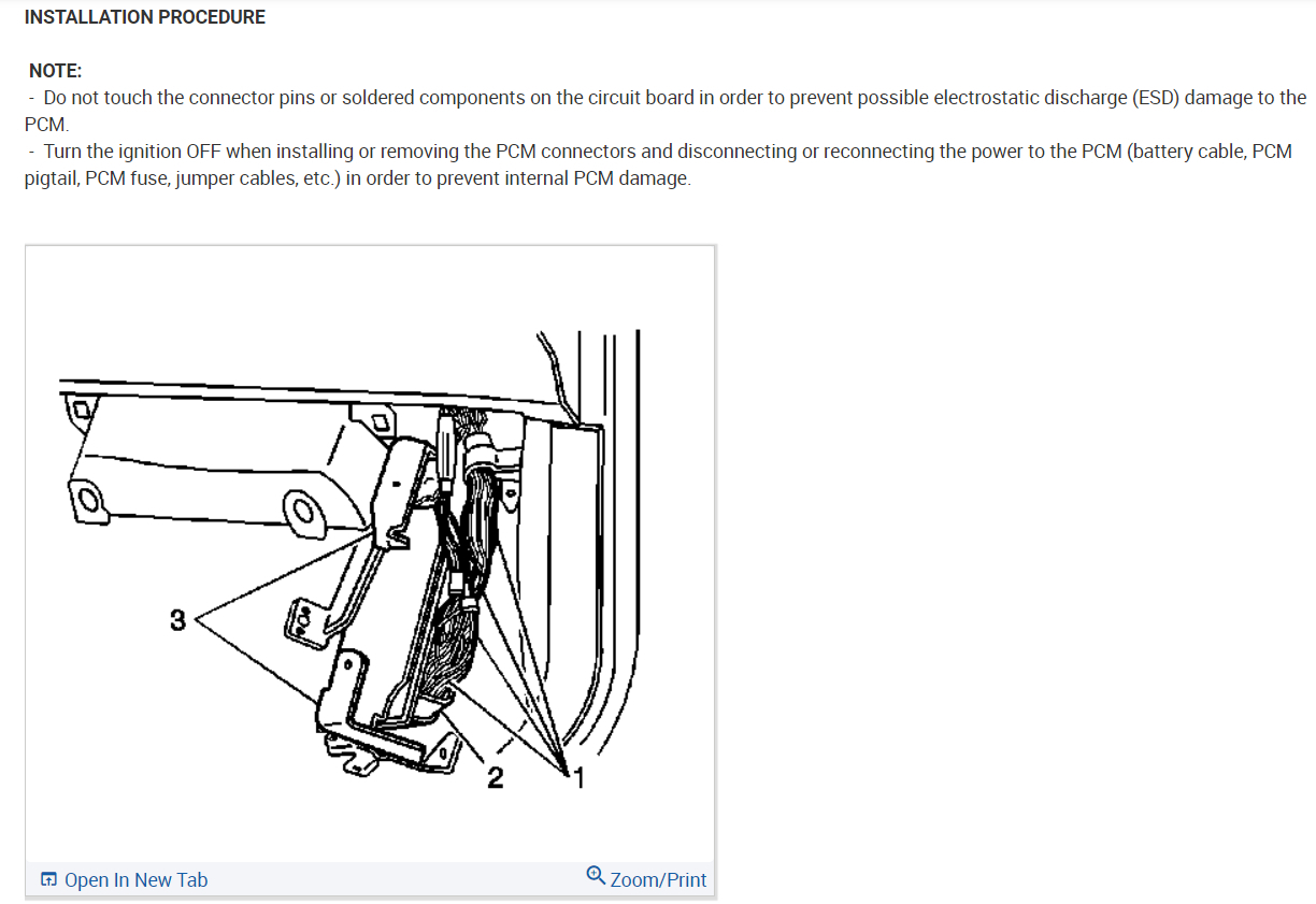

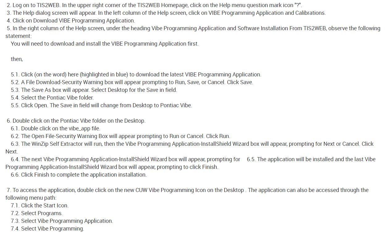

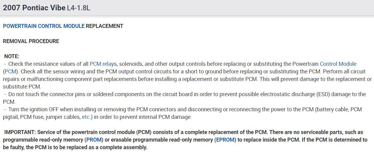

PCM is bad. Just purchased at dealership nine days ago. Car overheated. Threw ECM code. Need part number, but cannot find ECM.
May 22, 2017 at 6:25 AM
CARADIODOC
  • 34,381 POSTS

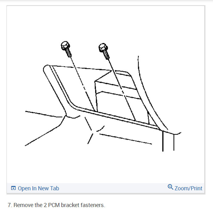

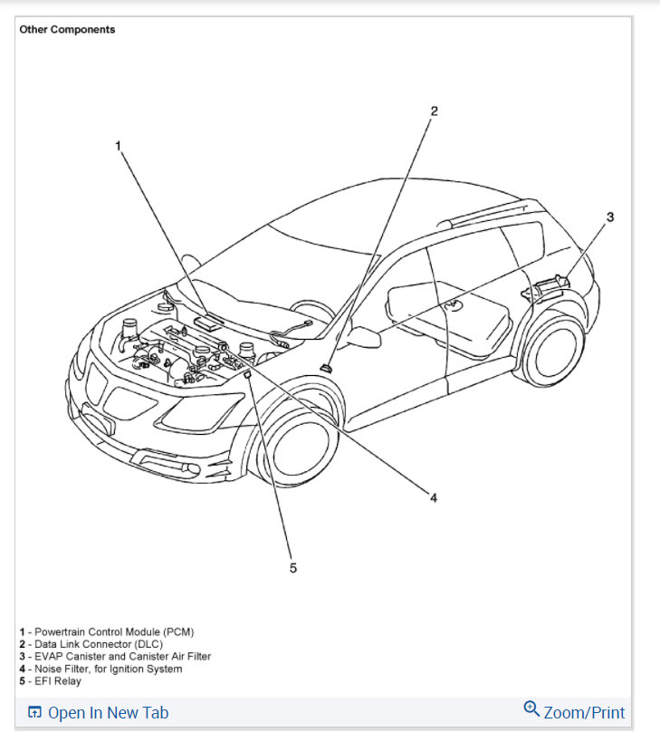

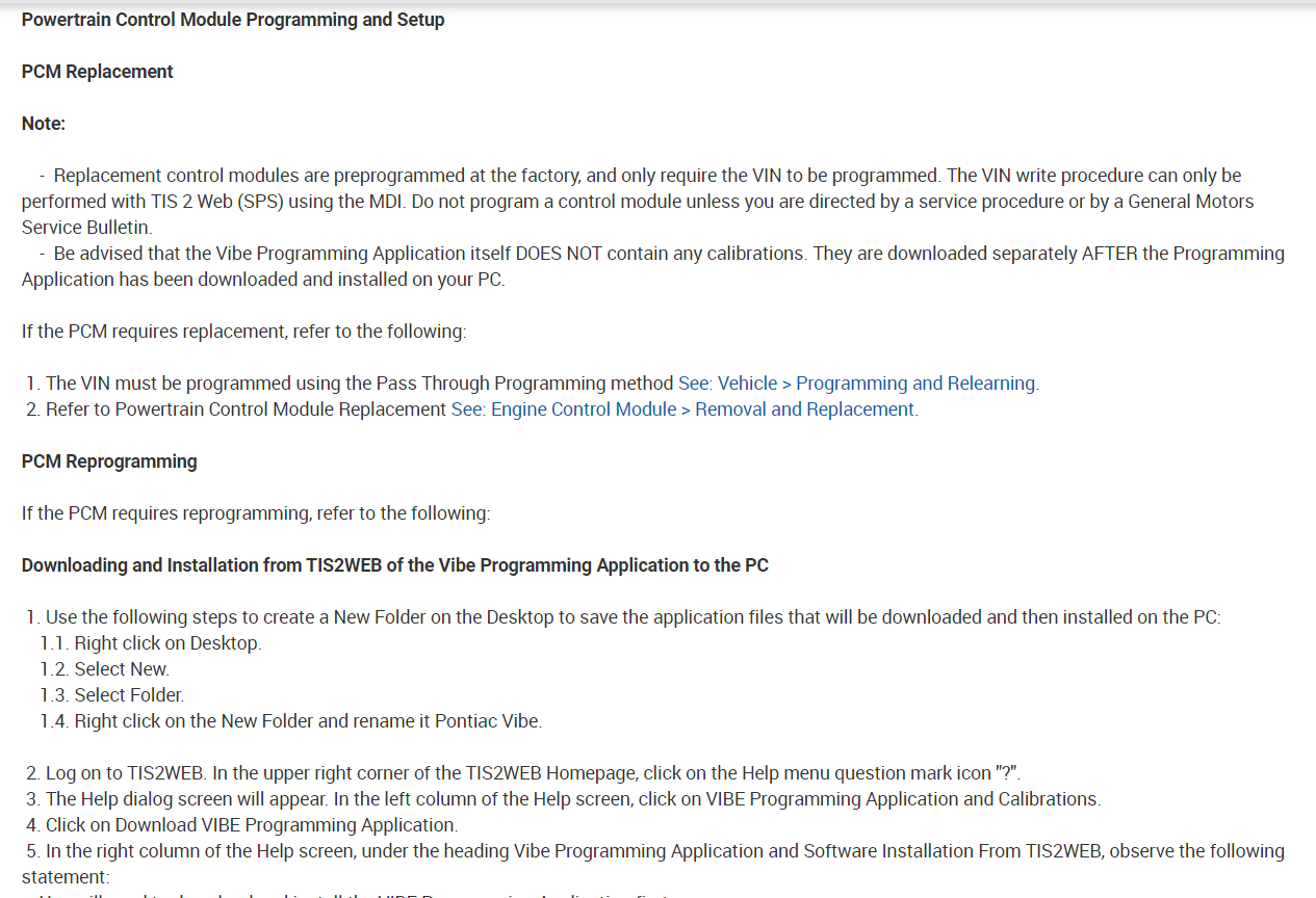

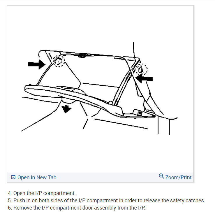

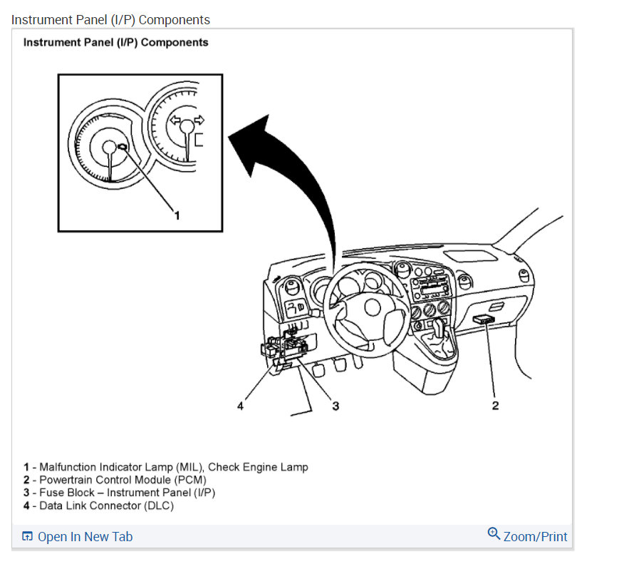

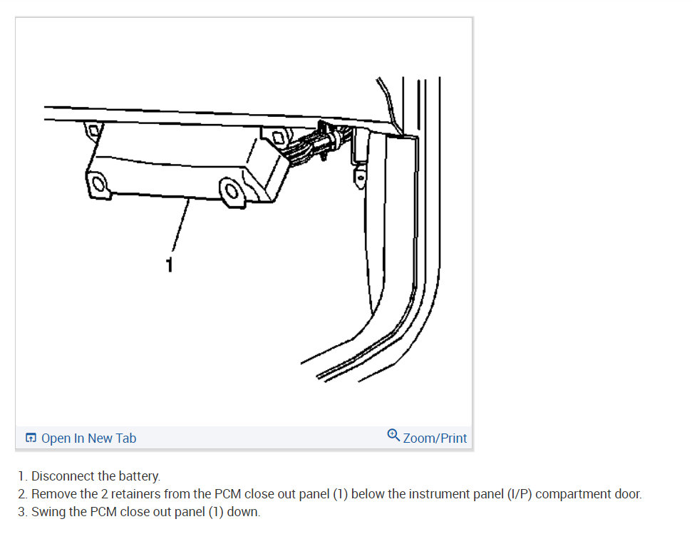

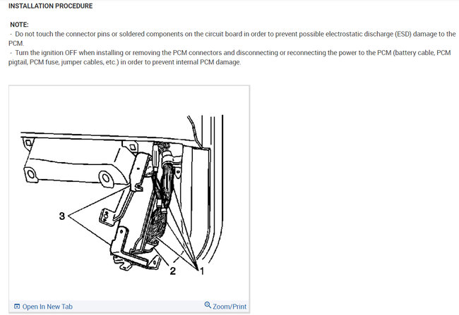

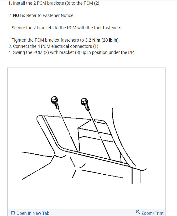

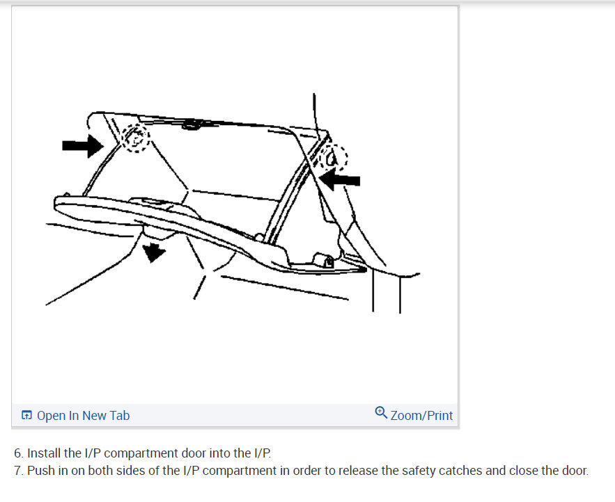

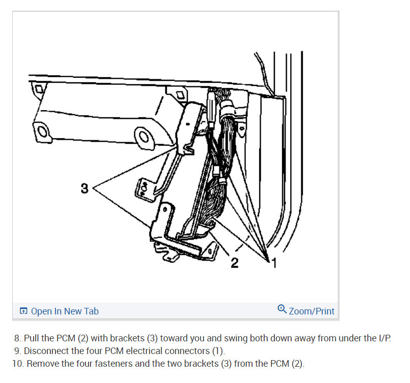

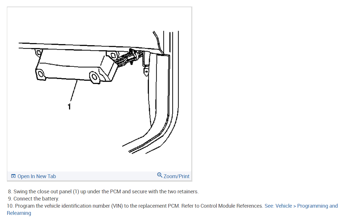

This car should have a 1.8L engine The engine computer is shown behind the right side of the dash, behind the glove box. Check out the diagrams (Below). Please let us know if you need anything else to get the problem fixed.
