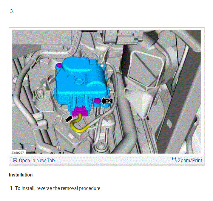

My drivers side is blowing hot air while passenger is blowing hot air. Having a difficult time finding the location of this part. Do you know where I would start to find this so I can replace it? Thank you!!
Jun 2, 2021 at 8:23 PM
  • 110,194 POSTS

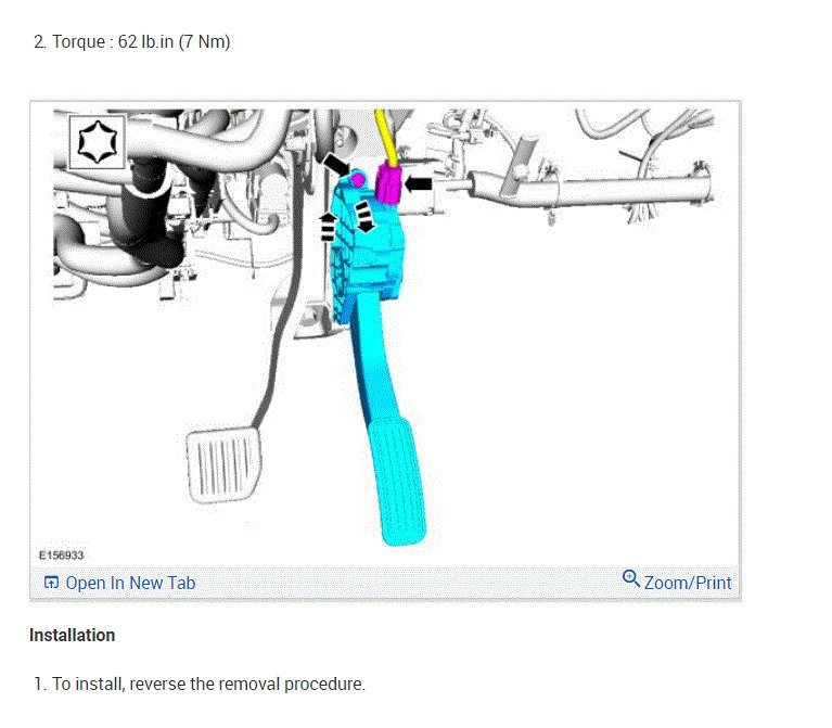

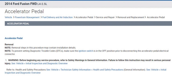

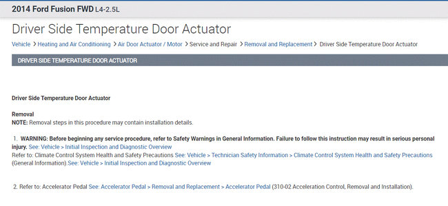

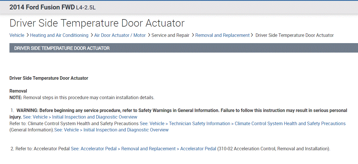

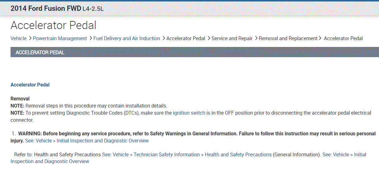

I attached the directions below for replacement. However, you will need to remove the accelerator pedal to access it.
First, here is a link that explains in general how to replace a blend air door. You may find this helpful as a guide.
If you look at the first two pics below, they provide the directions for replacement. The remaining pics explain how to remove and replace the accelerator pedal.
