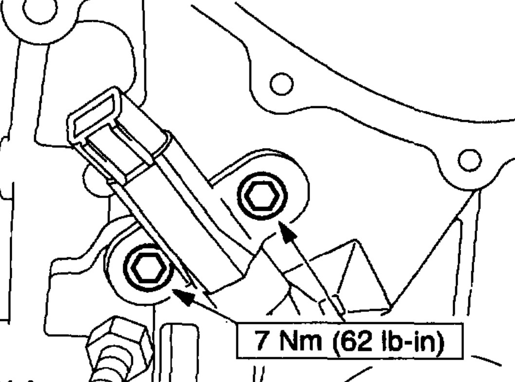

Where is the crankshaft sensor located?
236,000 MILES
DUST IN THE WIND
Just need a detailed diagram to pinpoint exactly where the crankshaft sensor sits.
Jan 29, 2025 at 3:09 AM
STEVE W.
  • 15,404 POSTS
It's mounted on the face of the engine just above the crankshaft pulley. Two bolts and the electrical connector. What seems to be the issue that leads you to the sensor?
