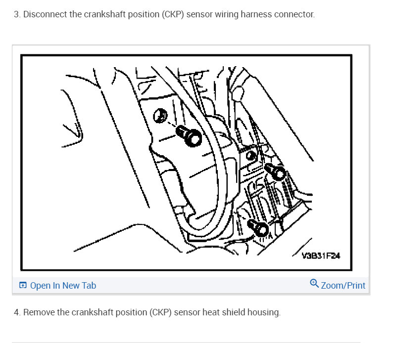

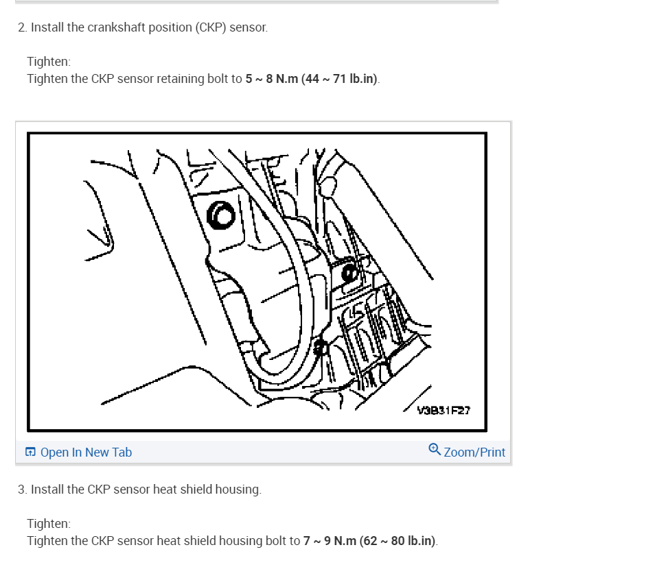

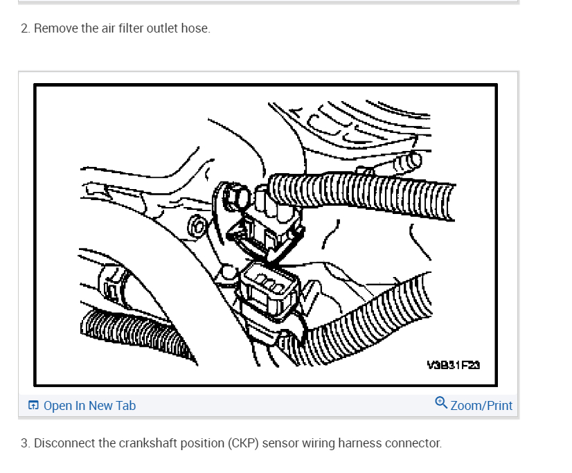

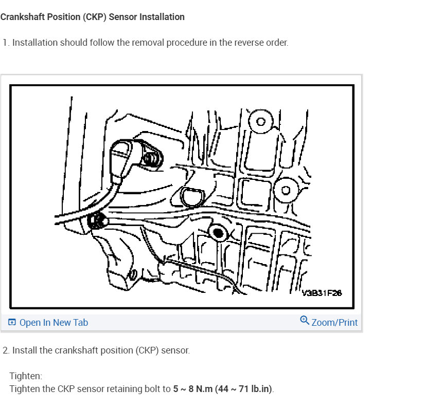

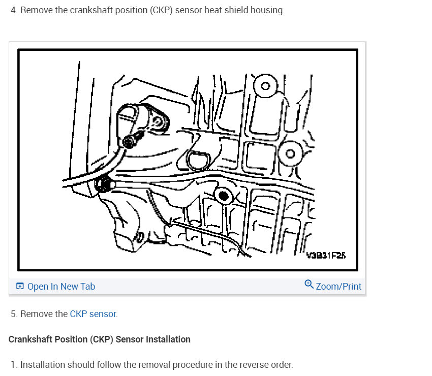

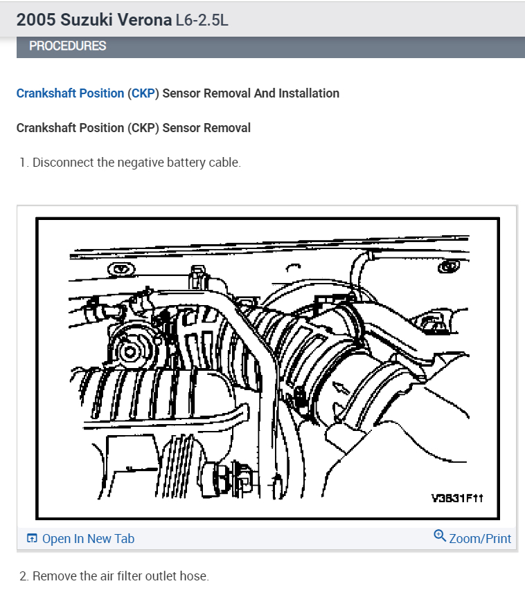

Sure, the crankshaft sensor is in the side of the engine block here is the location and instructions on how to replace it in the images below. Please let us know if you need anything else to get the problem fixed.
