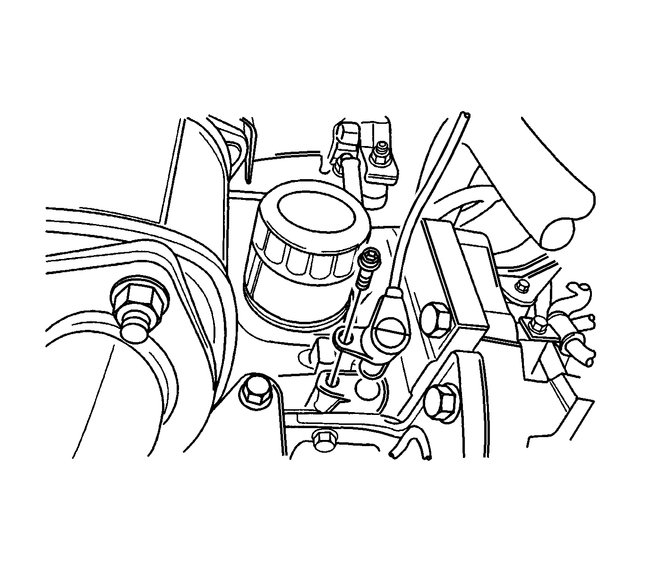

pic 1
Warning: Refer to Battery Disconnect Warning (See: Battery > Technician Safety Information > Battery Disconnect Warning).
1. Disconnect the negative battery cable.
2. Disconnect the crankshaft position (CKP) sensor electrical connector.

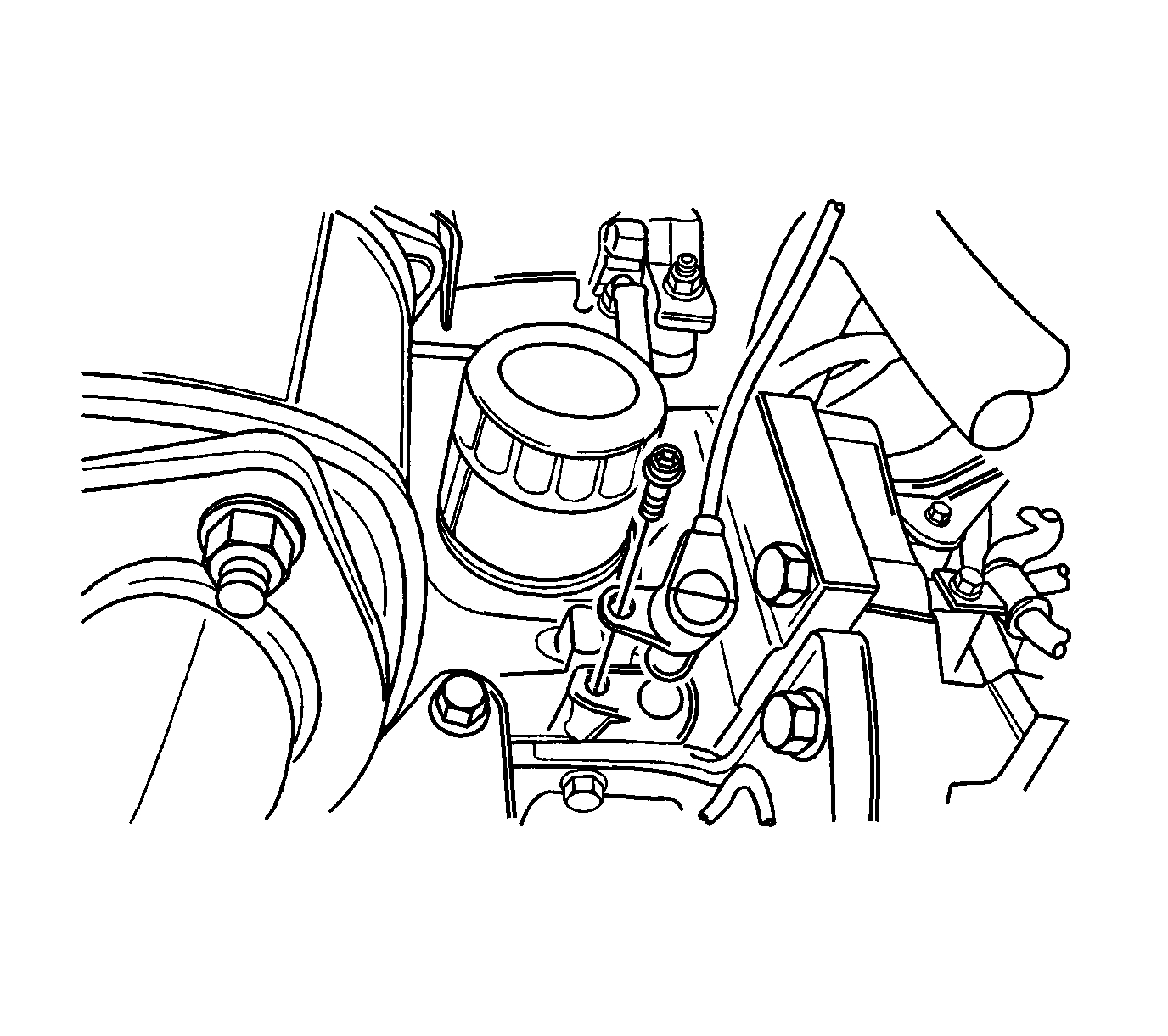

pic 2
3. Remove the CKP sensor bolt.
4. Remove the CKP sensor.

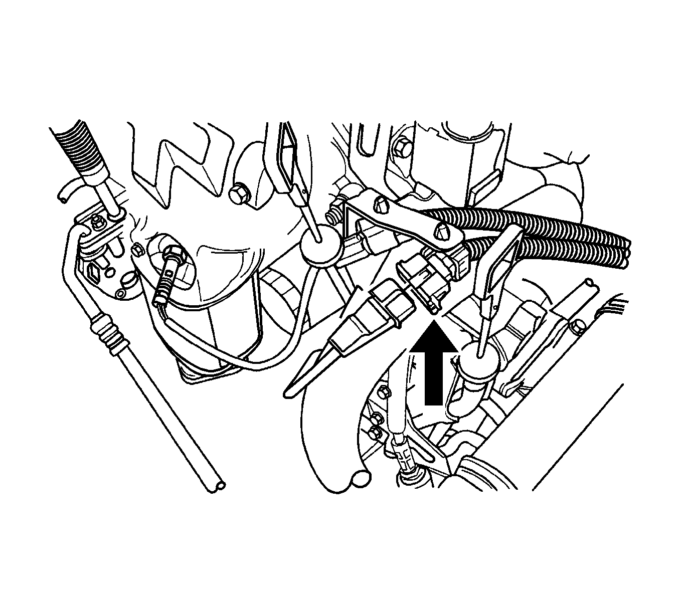

pic 3
Caution: Refer to Fastener Caution (See: Vehicle > Vehicle Damage Warnings > Fastener Caution).
1. Install the CKP sensor with the bolt.
Tighten the CKP sensor bolt to 6.5 Nm (58 lb in).
