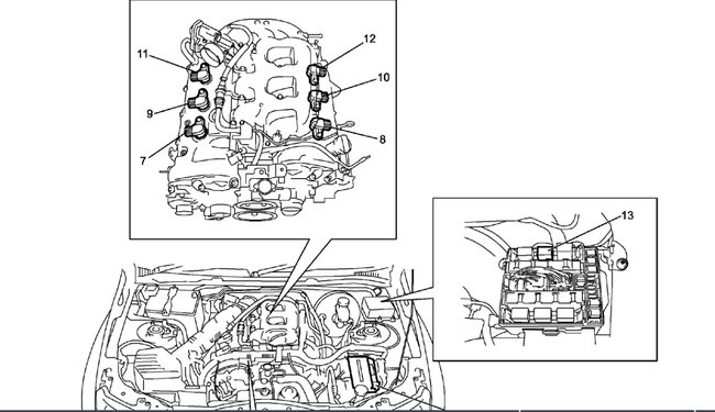

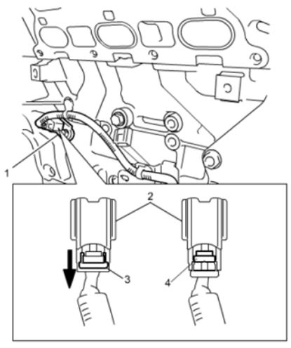

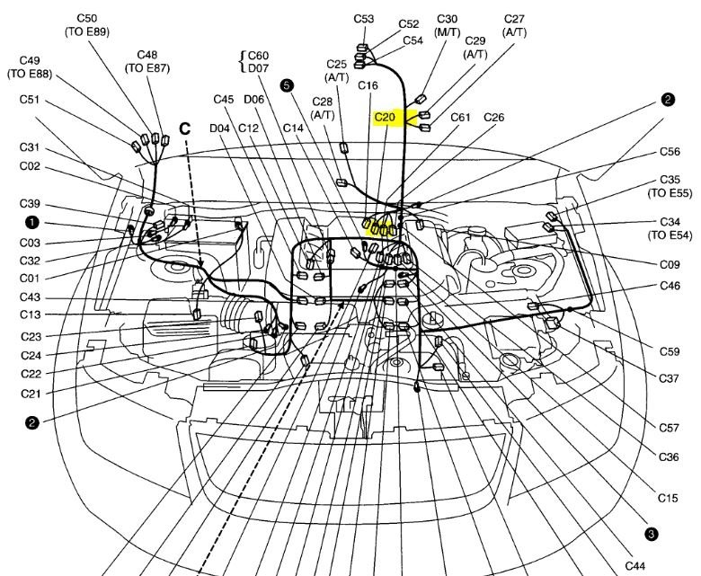

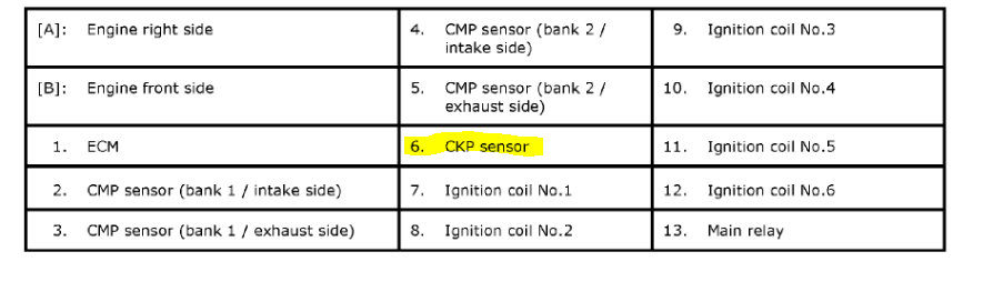

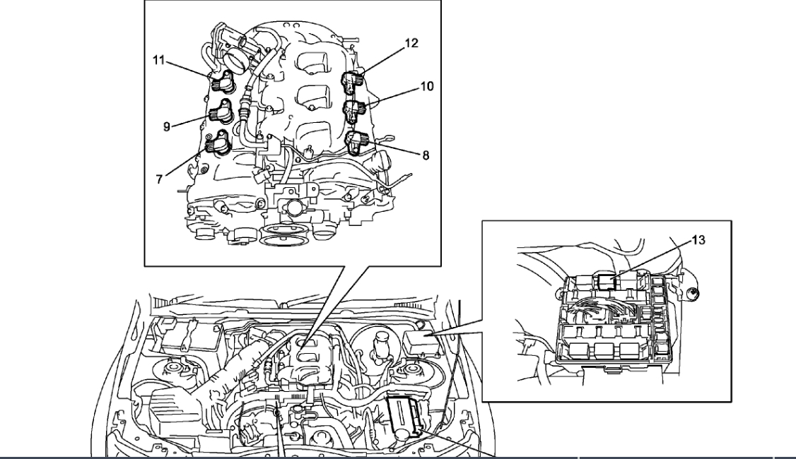

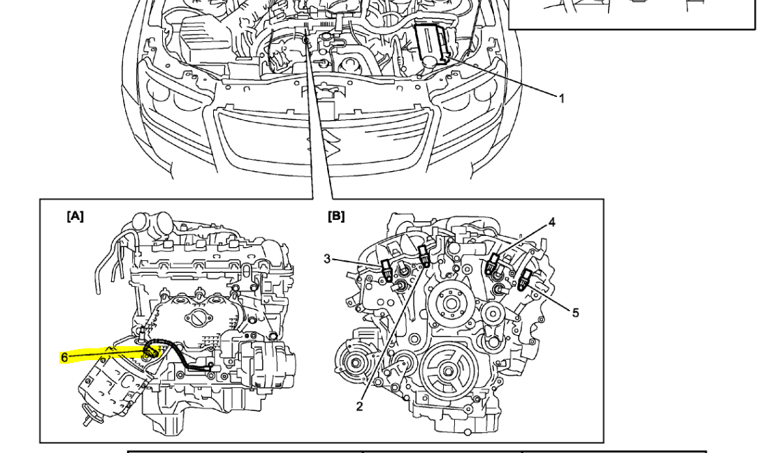

Location of crank angle sensor.

I have included the information that you requested in the diagrams down below. Please go through this information and get back to us with how everything turns out. I hope this helps.

The crank sensor on this vehicle is located on the right rear side of the engine. See the attached diagrams for more detail.
