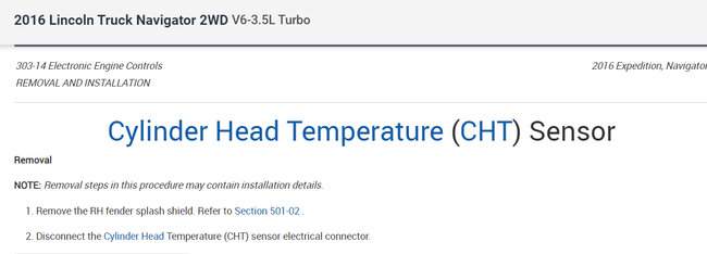

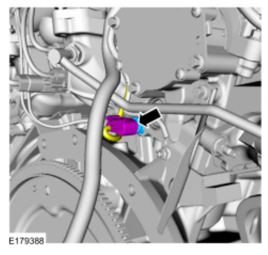

Where is the location of the temperature sensor navigator 2016? My radiator fans turn on right away as soon as I turn on my car, and I’m sure that’s not normal.
Feb 4, 2024 at 4:12 AM
  • 55,433 POSTS

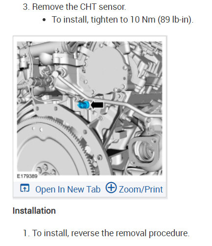

Yep, it sounds like the engine temperature sensor had gone out, they don't call it a coolant sensor anymore, the sensor is located under the high-pressure fuel pump on the rear of the engine on the right side just above the transmission bellhousing. Here is the location and how to change it out. Check out the images (below). Please let us know what happens.
