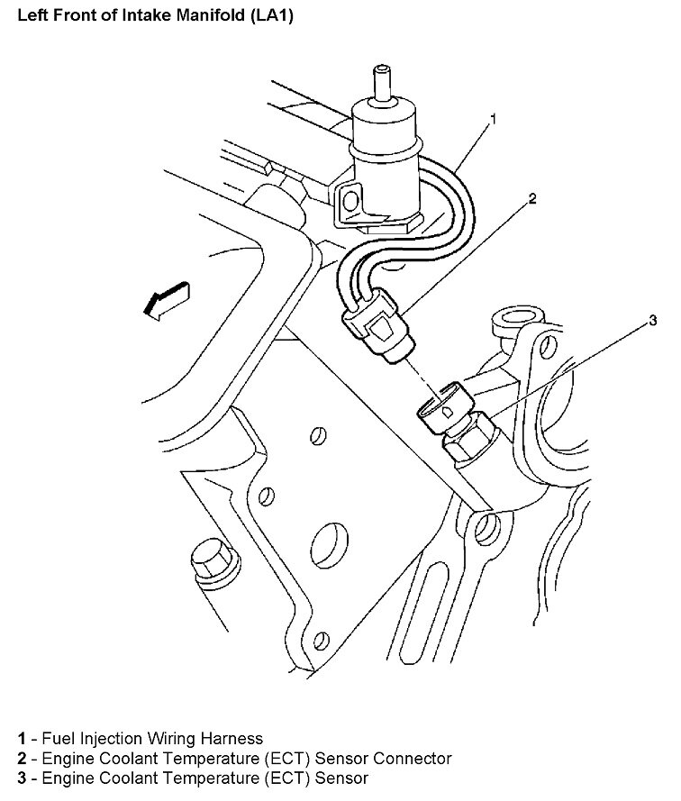

Not sure where it's located.

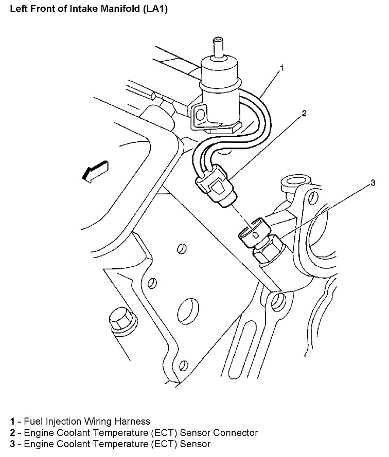

This drawing is for the 3.4L engine. Check out the images (below). Let us know if you need anything else.
