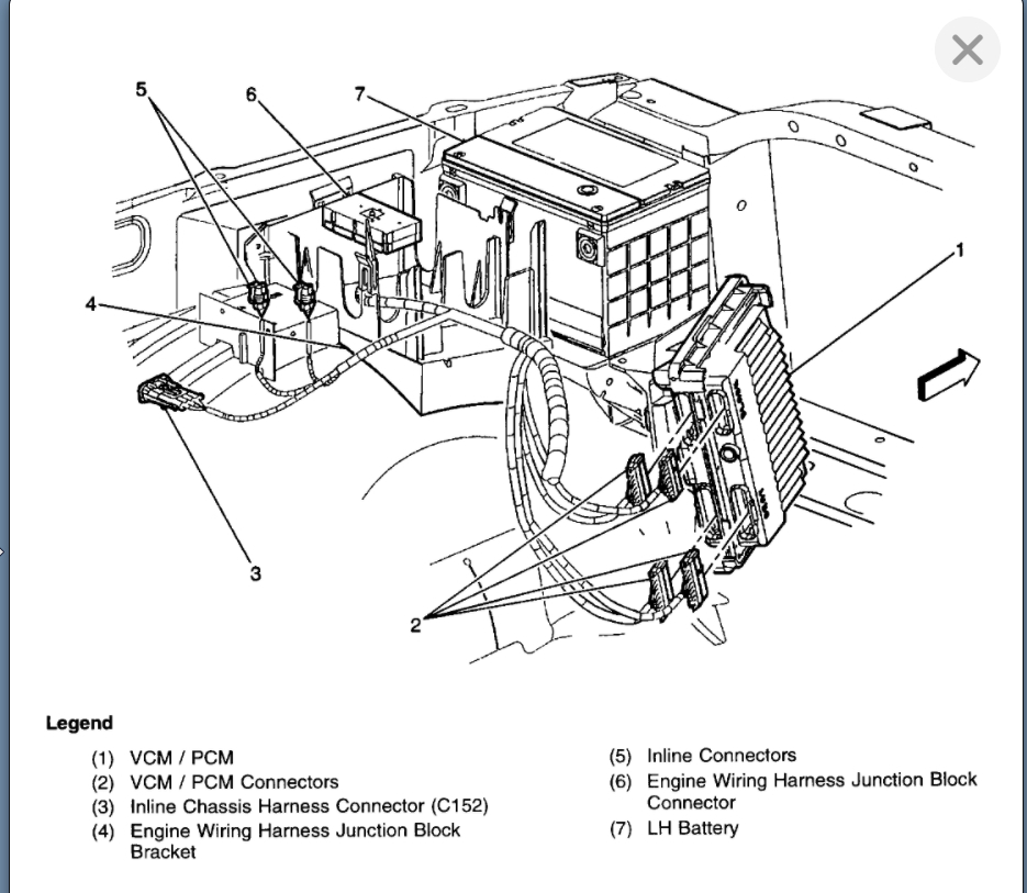

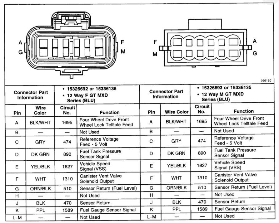

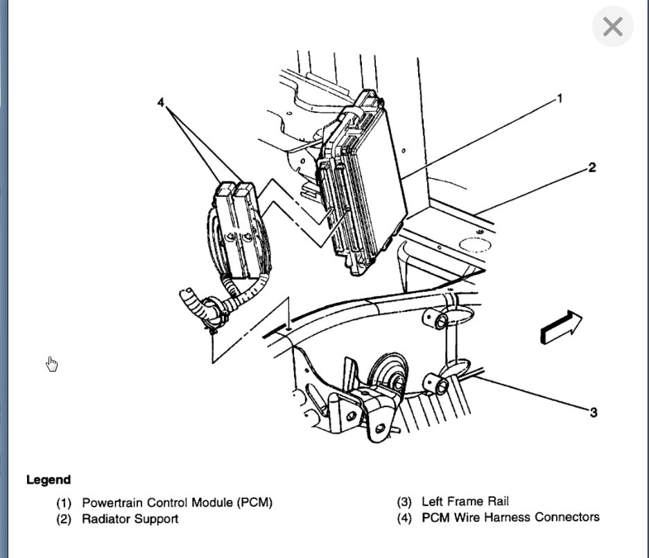

I need the location of connector C152 and location of the PCM.
Jan 18, 2021 at 1:11 PM
Take a look at the attachments below for the information you requested. Let us know what other info you need. Check out the diagrams (Below). Please let us know if you need anything else to get the problem fixed. Thanks
