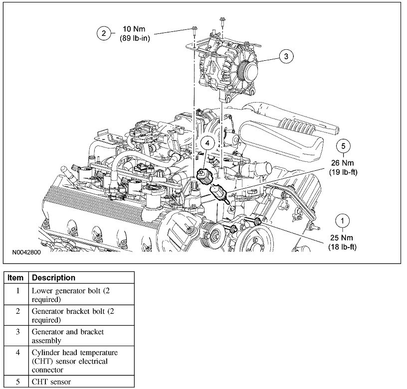

Code P0128, where is the CHT (Temperature Cooling) Sensor located?
2006 LINCOLN TOWN CAR
146,000 MILES
ROBERT CAPLAN
Code P0128. Various sources show the sensor to be in various places. Where is it and do I have to move the alternator to get to it?
Apr 9, 2022 at 11:45 PM
CARADIODOC
  • 34,381 POSTS
P0128 - ECT Below Thermostat Regulating Temperature

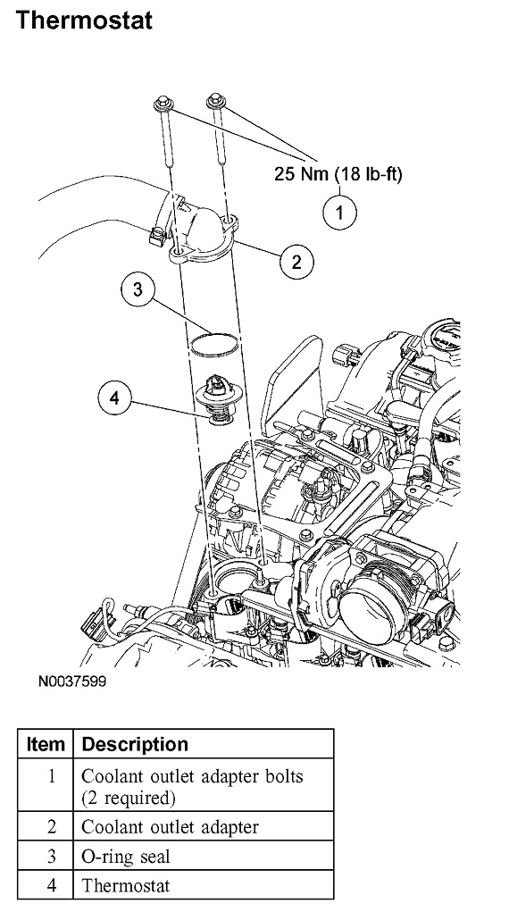

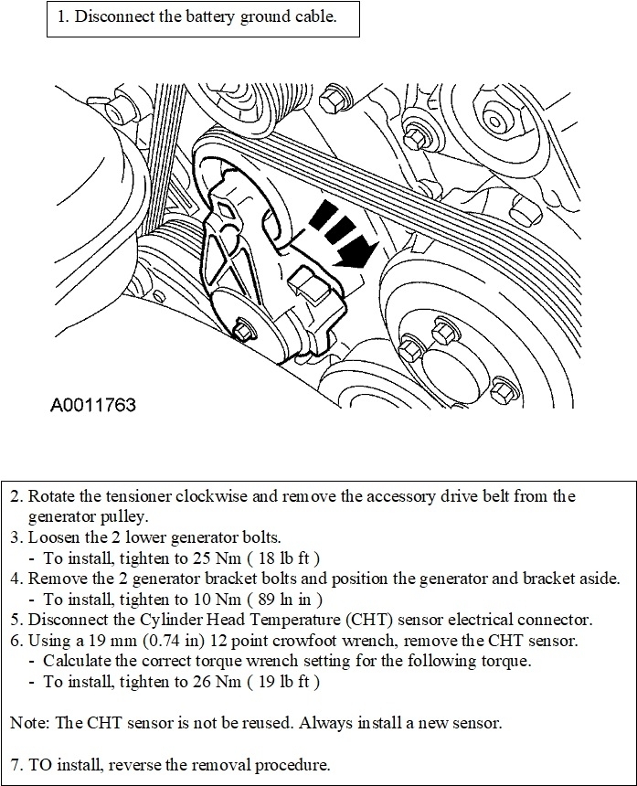

These first two drawings are for the cylinder head temperature sensor you requested. The generator does indeed need to be removed.
Be aware a properly working CHT sensor is required to set diagnostic fault code P0128. This code won't be solved by replacing the sensor. Code 128 is almost always set due to a thermostat that's sticking open or is opening too soon. If that is what you find, the last two drawings show the procedure for replacing the thermostat.
