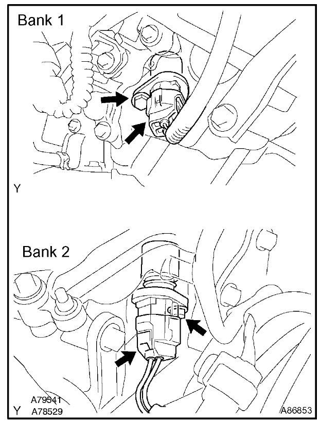

I'm looking for the location of my camshaft position sensor for bank 1 and 2
I keep getting a code for P0340 saying that both banks are not working properly I'm also not able to start up my car.

In the 2004 Toyota Camry with a 3.0L V6 engine (1MZ-FE engine), there is a camshaft position sensor, but they call it the VVT sensor
The P0340 code on a 2004 Toyota Camry indicates a problem with the Camshaft Position Sensor Circuit.
Check out the images (below). Please upload pictures or videos in your response of any problems so we can see what to help you with.

I ended up finding the camshaft sensor and replaced that and the crankshaft position sensor. Car will still not start whatsoever.
Nov 1, 2024 at 5:49 AM
  • 55,709 POSTS
Yep, I see the sensor now, they called it a VVT sensor, my bad. Check out the images (below). please post your not start question here, you must be logged in.
