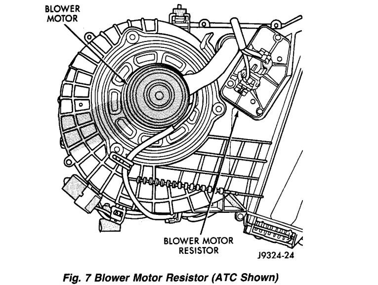

Blower motor fan keeps running. I replaced relay, motor fan continues to run.

Good afternoon.
Below is the procedure and a picture attached.
REMOVAL
The blower motor resistor is located under the glove box and can be removed from the passenger compartment.
1. Disconnect the negative cable from the battery.
2. Remove the blower motor resistor connector(s).
3. Remove the resistor retaining screws.
Fig.7 Blower Motor Resistor (ATC Shown)
