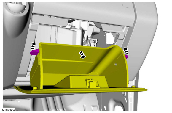

Remove the Audio Front Control Module (ACM) . Refer to, Section 415-00A , Section 415-00B , Section 415-00C or Section 415-00D .
Lower the glove compartment.
While pushing the glove compartment door tabs, position the glove compartment downward.
pic 1
NOTE: The forward passenger temperature blend door actuator screw can be removed with a combination wrench. With one hand working through the ACM opening, hold the top end of the combination wrench. With the other end of the combination wrench pointing away (toward the right front corner of the vehicle), and with the other hand working through the glove compartment opening, the combination wrench can be manipulated.

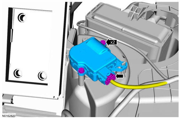

Remove the passenger temperature blend door mode door actuator.
Disconnect the passenger temperature blend door mode door actuator electrical connector.
Remove the screws and the passenger temperature blend door mode door actuator.
pic 2
