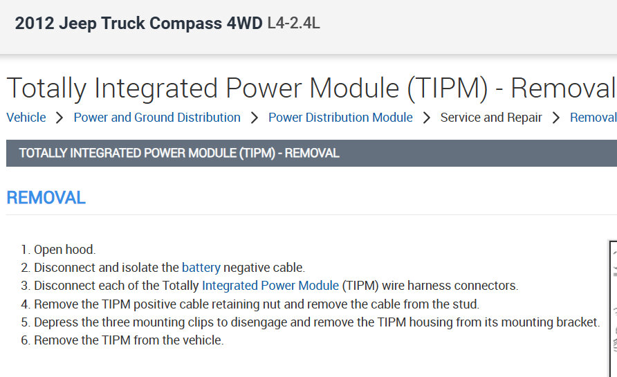

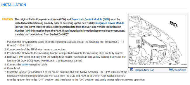

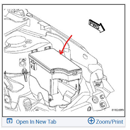

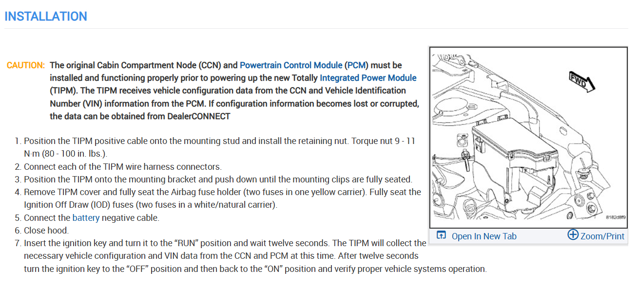

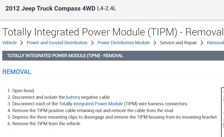

I am having trouble locating the BCM on my vehicle listed above, would you have a diagram available to share? Thank you
Nov 24, 2024 at 4:28 AM
  • 55,709 POSTS
This is because they call the BCM the TIPM and it is easy to replace because it itself learns so there is no programming necessary. Check out the images (below). Let us know if you need anything else.
